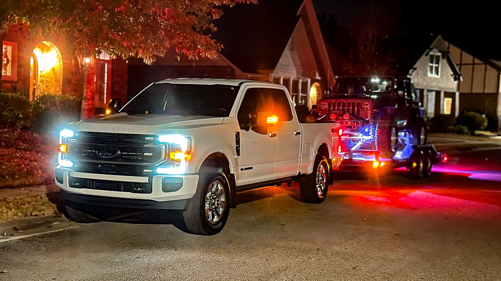

I had a similar decision to make as having to do a new F250 Platinum or King Ranch, keep my 21 F150 King Ranch. I too pull a Jeep (all over the country) and approaching an age where if I do something it will be for a long time. The '21 KR was paid off and did all it needed to do and was fully loaded. In the end it did come down to more of a want than a need, thinking may "want" to tow an large RV, "want" to be sure comfortable and had the tech desired for long trips, "want" a larger bed... Funny thing is settled on a clean low mile '22 F250 Platinum with a high capacity rear axle and diesel. My story is get want you want for the long haul, new F250's are made well and will last as long as need it, it is not an easy choice so enjoy the ride and don't look back.
