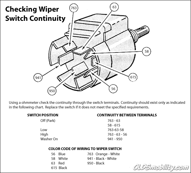

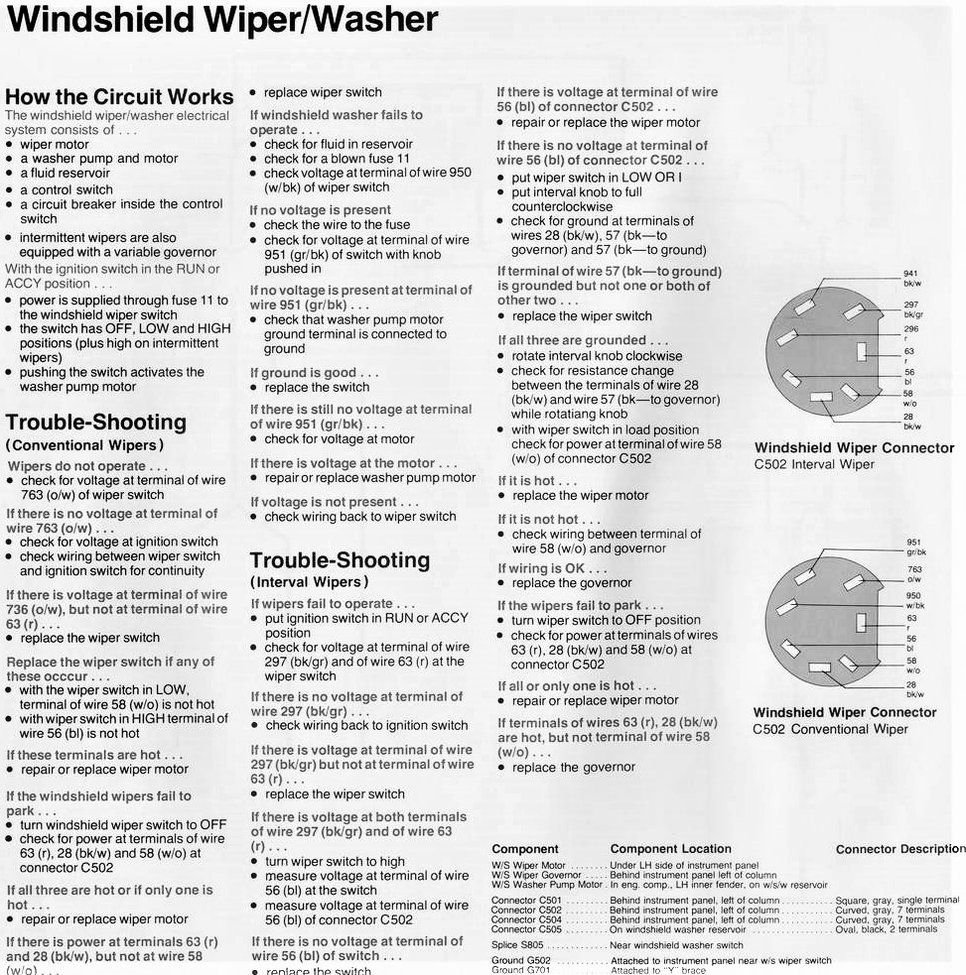

My windshield washer sprayer is not working. i know its the switch. Sprayer motor is fine.
I have two switch and motor set ups on my bench with harness connected. When i test them both on the bench the wipers work in both speed positions. They also park fine.
So i think the switchs are fine. However, when i activate the washer function, none of the other two remaining terminals show power. And if they switch is set up to ground when activated, i am still not getting any power at resting.
Can it be that i have three bad switches or am i missing something on how the switch works?

Take a 10 min break, relax and take it step by step, patiently. Check fuse, ck power to be where it needs to be. Do not be surprised if it is just a bad connection, loose ground. Could be 2 bad switches. 3rd time is a charm, right?
