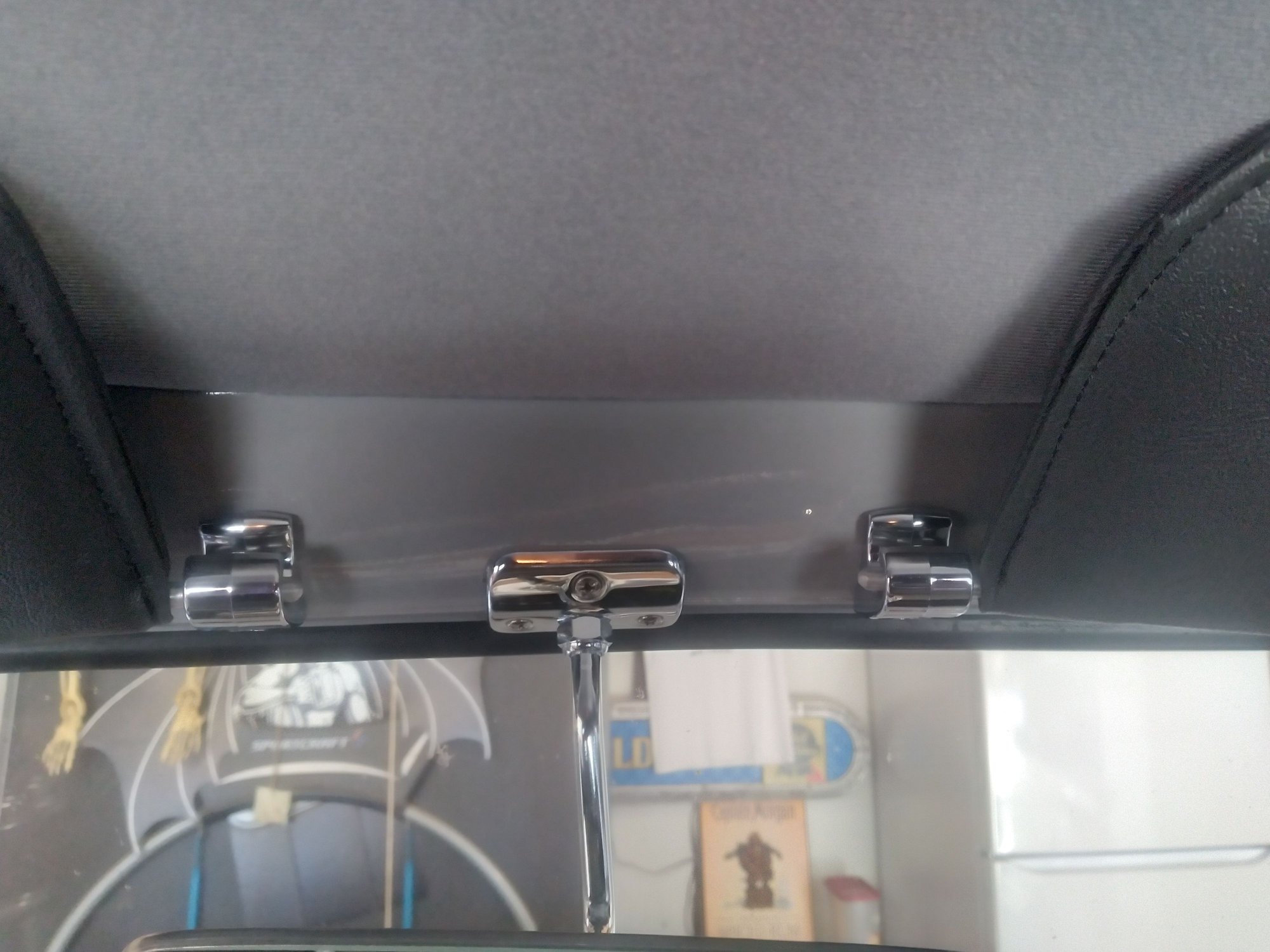

My right sun visor had this terrible habit of wandering around when driving....it drove me crazy.
I thought about just putting velcro to hold it in place, but thats kind of a mickey mouse fix.

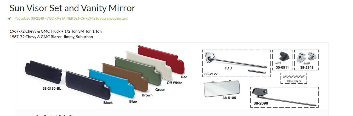

I found these visor holders at LMC, they're for a 72 chevy truck.

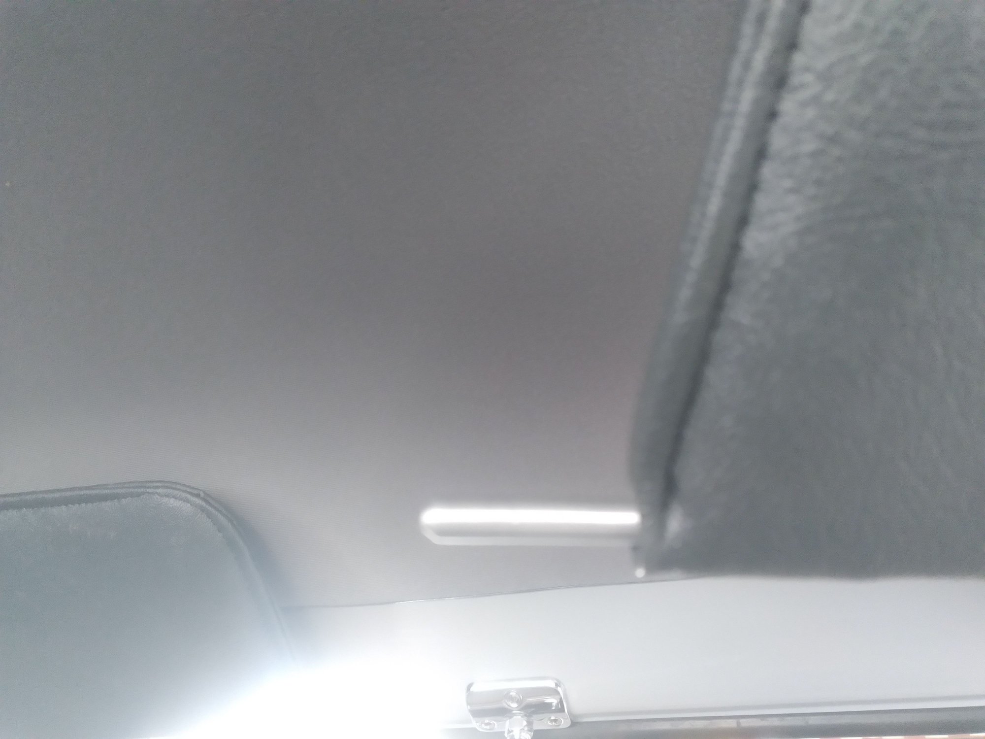

I bought some 1/4" alum round rod and was able to insert them into the ends of the visors.
Problem fixed and I think it looks good too.
Wandering visor
Visor holders from LMC
Alum round rod. About 10" long
Inserted into the visor.
End result.

edit... just ordered these... 26 bucks for two but the shipping was 11 bucks, seems excessive/
for others who need ... scroll down the page for parts list and prices.

If you look closely at the visors in jniolon post, the visors do have a rod sticking out. And the retaining brackets are hooked for a rod to fit into them.
Originally that's what I wanted, just something that I could hook the visors onto. In my Google search for sun visor brackets I came across these and wondered if I could insert some rods into the end of the visors. So that's the way I went with them.
