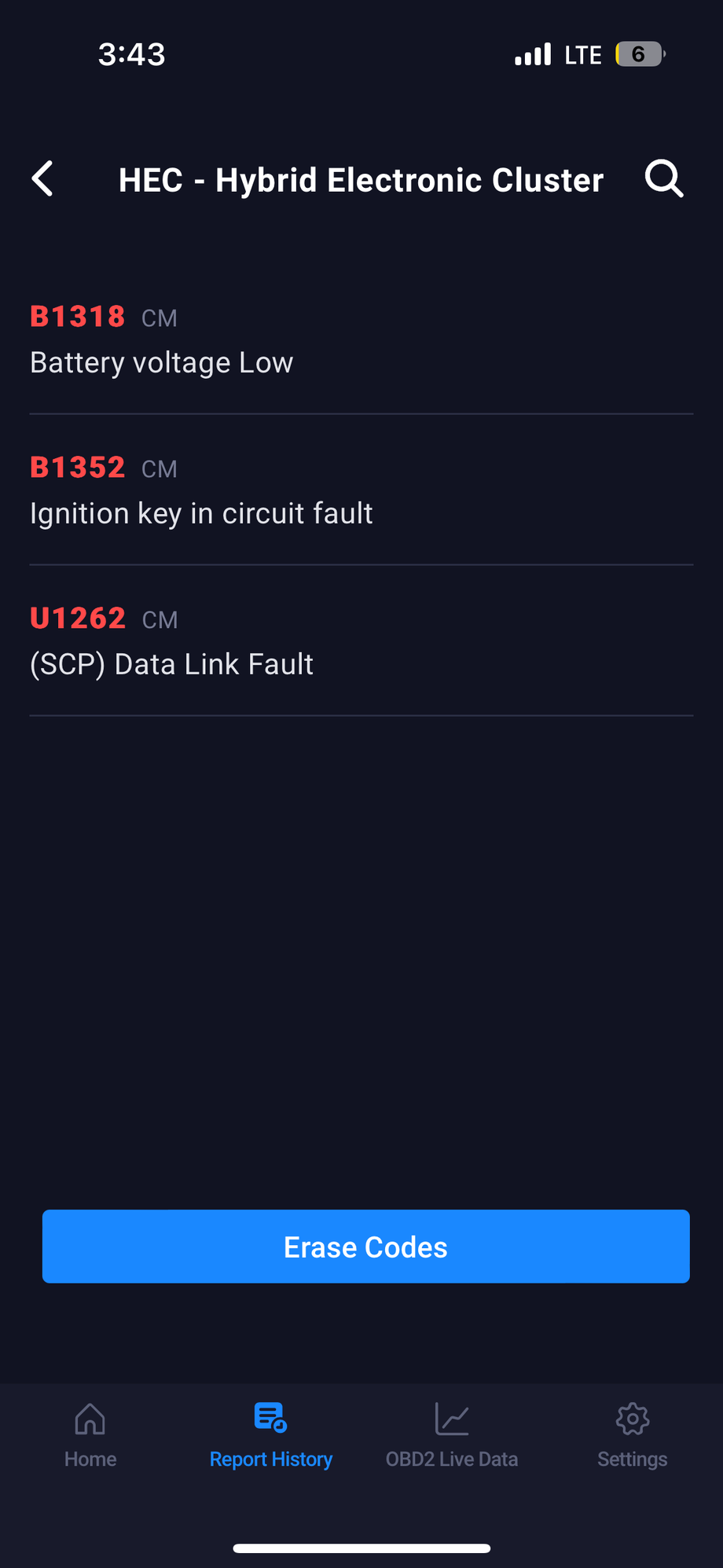

FIRST - based on the low battery voltage code:
Charge batteries.
Load test individually.
Check cables and connections.
Test alternator.

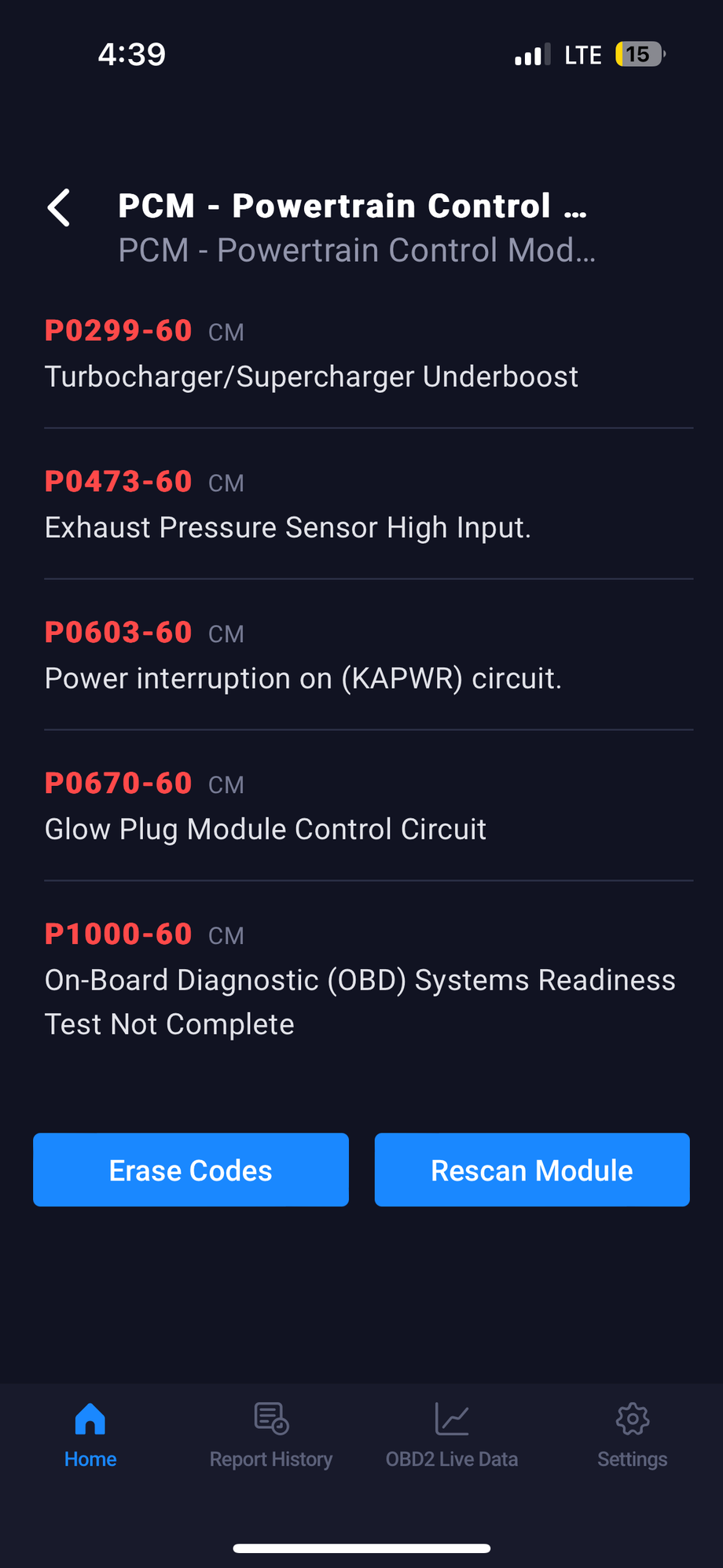

More than one thing going on because a high pressure oil issue doesn't cause a low battery voltage code >>>>>B1318. I hate troubleshooting when there are easily fixable "base issues". Fix electrical issues first as a rule of thumb. I also hate leaving GPCM codes unaddressed!
I guess he could have just cranked too much, but still, the batteries at least need checking IMO.
As far as dying when hot and restarting when it cools off, I agree that is most common for it to be a high pressure oil leak issue, but sometimes it is from an electronics issue (failing electronics can result in a quicker heat buildup inside the component - FICMs, IPRs, EBPs, etc), or even fuel dilution of the oil which would be indicated by a high oil level (and diesel smell to the oil). The easiest thing to do is confirm a high pressure oil issue - just need to watch the ICP and IPR PIDs.
That said, NOTICEABLY absent are ANY high pressure oil codes P2290 or P2291 (also P2284 and P2285 codes are not there either) ......unless the scan tool is less than capable.

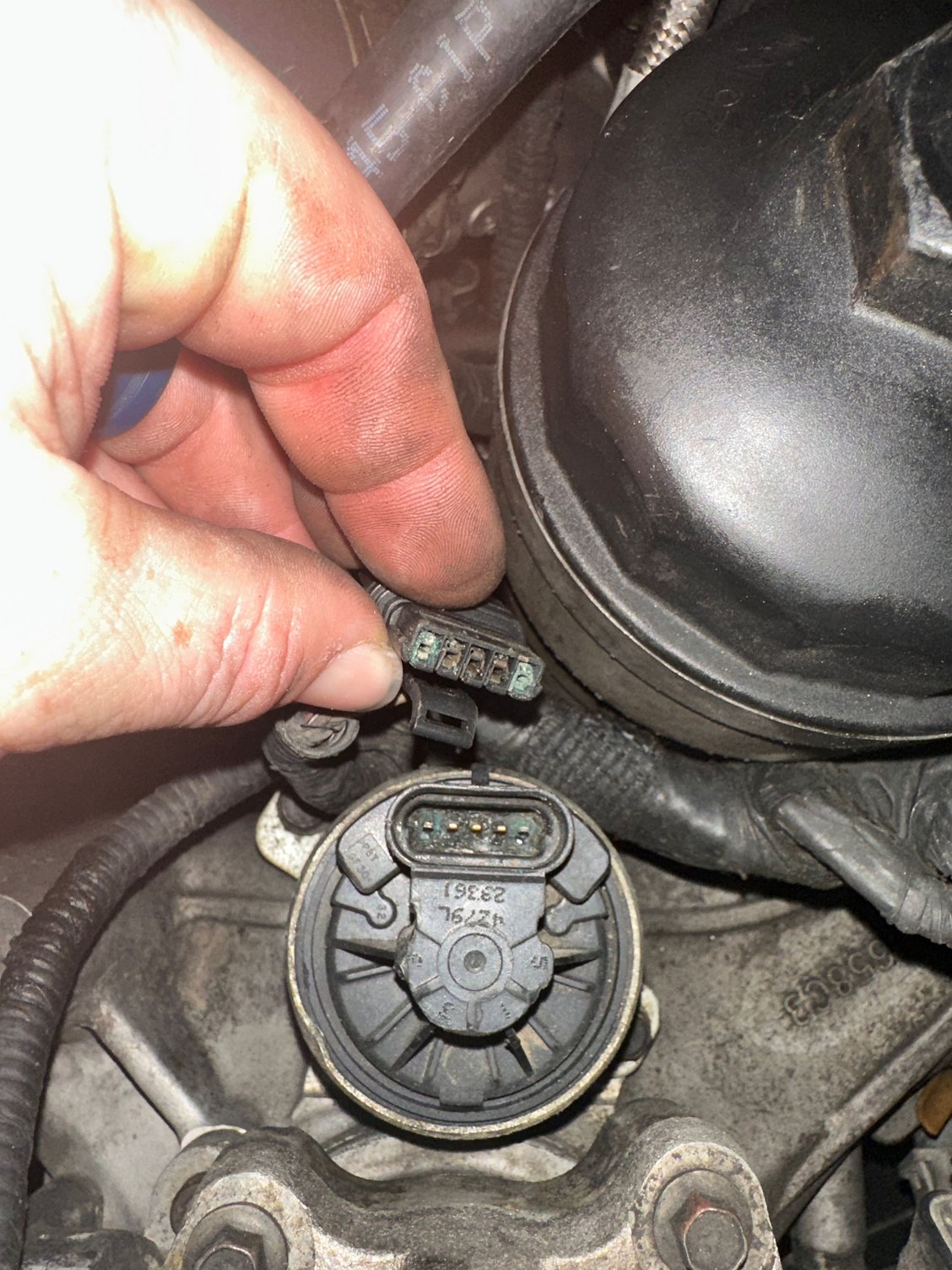

Ok, I just found another corroded connector but it’s attached the the main harness so I don’t know if it can be replaced
Old Jan 25, 2024 | 11:26 AM
bismic's Avatar
bismic
Joined: Nov 2003
Posts: 27,872
Likes: 3,592
Good find, a good reward for keeping your mind open to possible issues! That is the EGR valve connector. I have not seen that connector sold individually, but it probably is. You can just leave that disconnected, and hopefully that green corrosion is NOT up into the wires. EDIT - see post below for the connector.
The corroded pins are for the PCM supplied switched power (Red wire) and the PCM control wire (White wire with Red stripe). A short in that switched power (in the wiring or on the valve itself) CAN cause the engine to shut off or not to start, Still (in addition), you (or the mechanic) need to watch the high pressure oil system numbers as the folks above have suggested.
