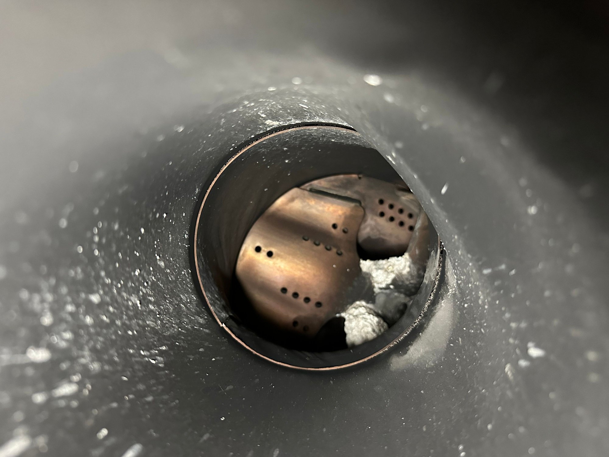

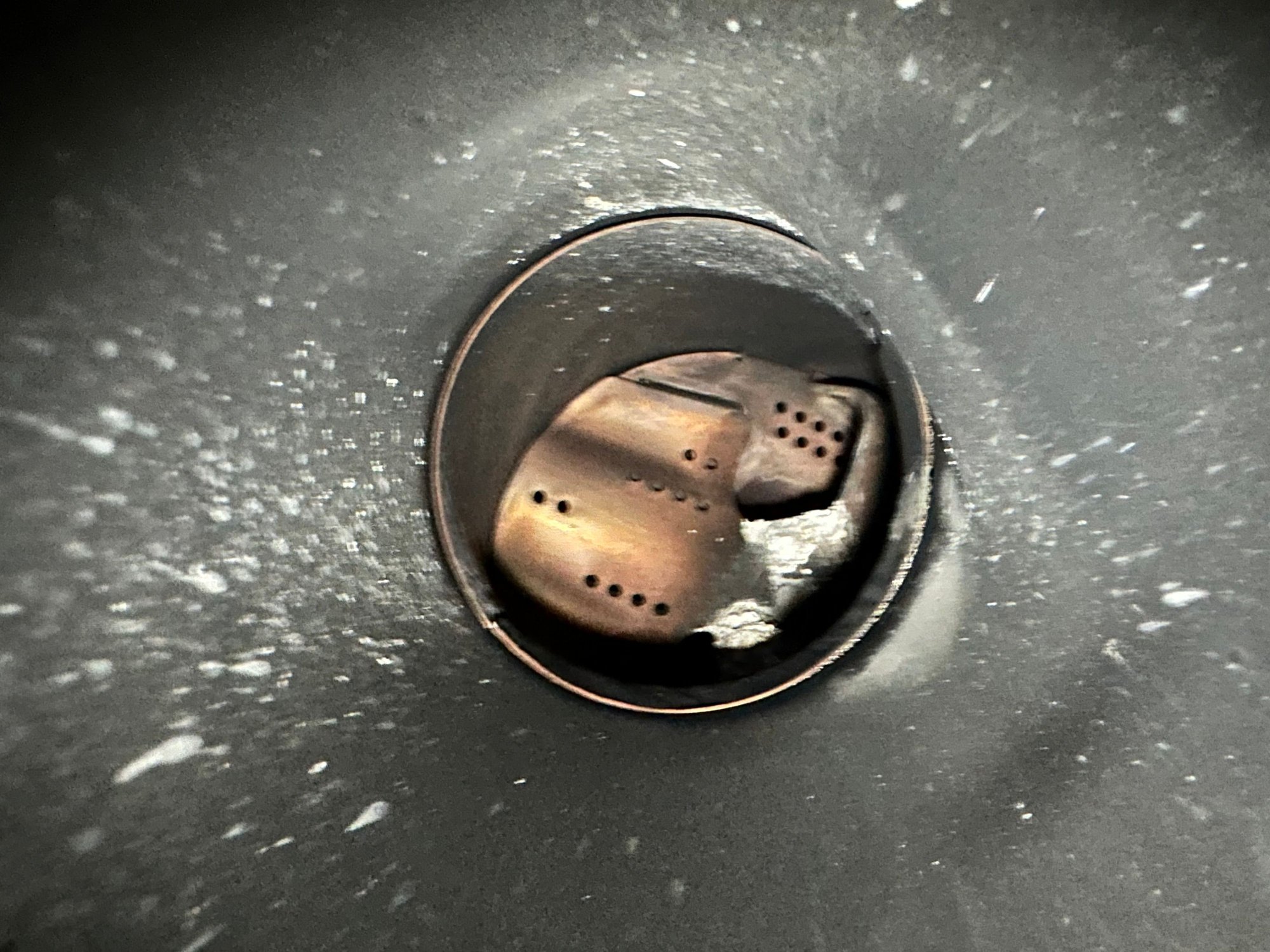

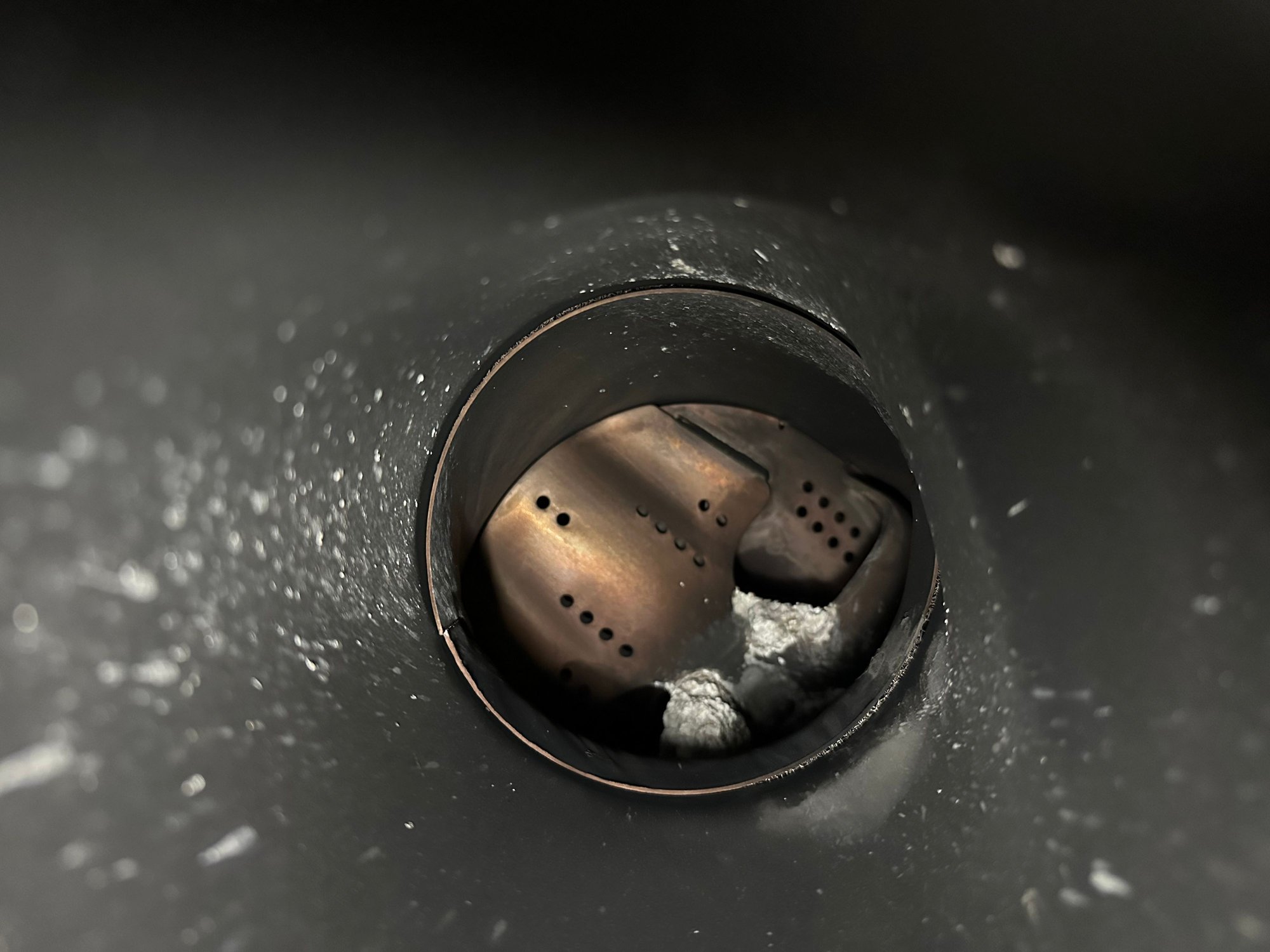

Bringing up a old topic. My DEF usage hasn't gotten any better. So for the naysayers. The increased DEF consumption is not caused by EGR or a mechanical issue. Ford technicians have not been able to resolve the issue, even though they don't think there is a issue, so Ford replaced my DEF injector to attempt a fix. One trip in and the consumption was worse. I took a look at the inside of the exhaust just downstream from the injector and found large chunks of crystalized DEF. They were still white, which leads me to believe they were fresh as everything else was covered in soot. This leads to the thought that the system is overdosing DEF and the exhaust gasses can't atomize all of the DEF. The crystalized particles even go back to the first filter plugging it up and causing the truck to perform regenerations to often. My DPF has never been more than 40% full when it does a regen, and even more often when towing. I will try to upload a picture.

This makes me think it is a software issue. Thoughts? Please don't say EGR

Bad sensor maybe. The ONLY thing that triggers a DEF release is the NOX sensors, and to a lesser extent the EGT probes since it wont inject DEF unless the SCR is hot enough. If the NOX sensor is out of whack, it may think the SCR isn't cleaning it enough and injecting in more DEF than needed.
Only one way to know for sure and thats to have the IDS connected up, or third party scan tool that can measure and graph, and go on a long drive to measure the inputs and outputs and find out where the signals are getting mixed up.
DEF is called for when NOX levels exceed a certain percentage, then DEF is injected into a chamber that turns it into ammonia that then flows into the SCR converting NOX into CO2 and water. There should only be enough DEF to turn into ammonia gas, never flow past the chamber as a liquid and you are seeing with the crystals.
