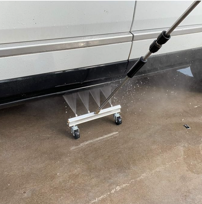

Each time we are traveling and run through a salt mine state, I wash the vehicles thoroughly and pay special attention to the undercarriage.
I usually go to a car wash that has an undercarriage spray and go through very slowly. I have thought about getting one of the sprayers for the pressure washer, but have not yet.
If you don't have the desire to go the DIY route, check for undercarriage washing at truck stops. I don't have any advice for rust prevention methods since moving out of the rust belt 30 years ago with zero plans to ever go back.
