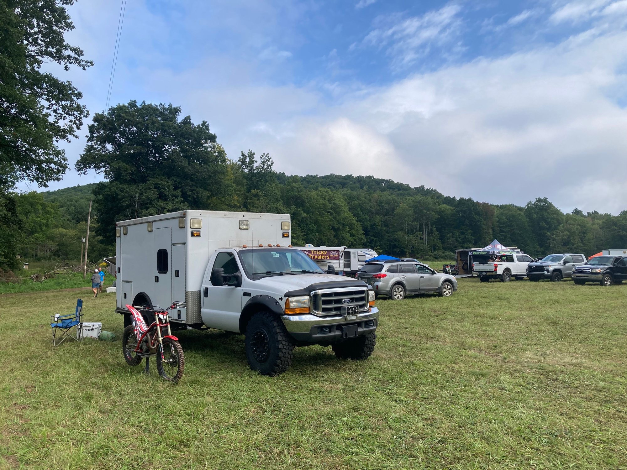

Picture from a camping at a moto trials event over summer
