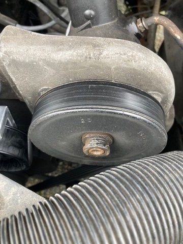

I finally got the picture to upload. That's actually better than it was, but see how the belt is trying to climb over the pulley? Its like the pump needs to come forward toward the radiator somehow, but it can't because its seated properly against the bracket, and the bracket can't move anywhere either. It worked fine all summer with no problem, then sat while I was gone for a month and a half and when I got back and started it up, that's what it does. I don't get this....

Maybe post a pic from vertical to see alignment. Is it possible the main bracket is not fully seated causing the whole assy to be out of angle? Could have been out whole time and belt just finally gave up. TBH I throw parts at problems until it gets fixed but if belt seems good on upstream and downstream pullies may be a good exercise to remove pump and bracket and ensure its seating correctly, no trash or crud in-between the faces.
the question on the pulleys being different, iirc the 4.9 pulley is a smaller diameter than on the 5.0/5.8

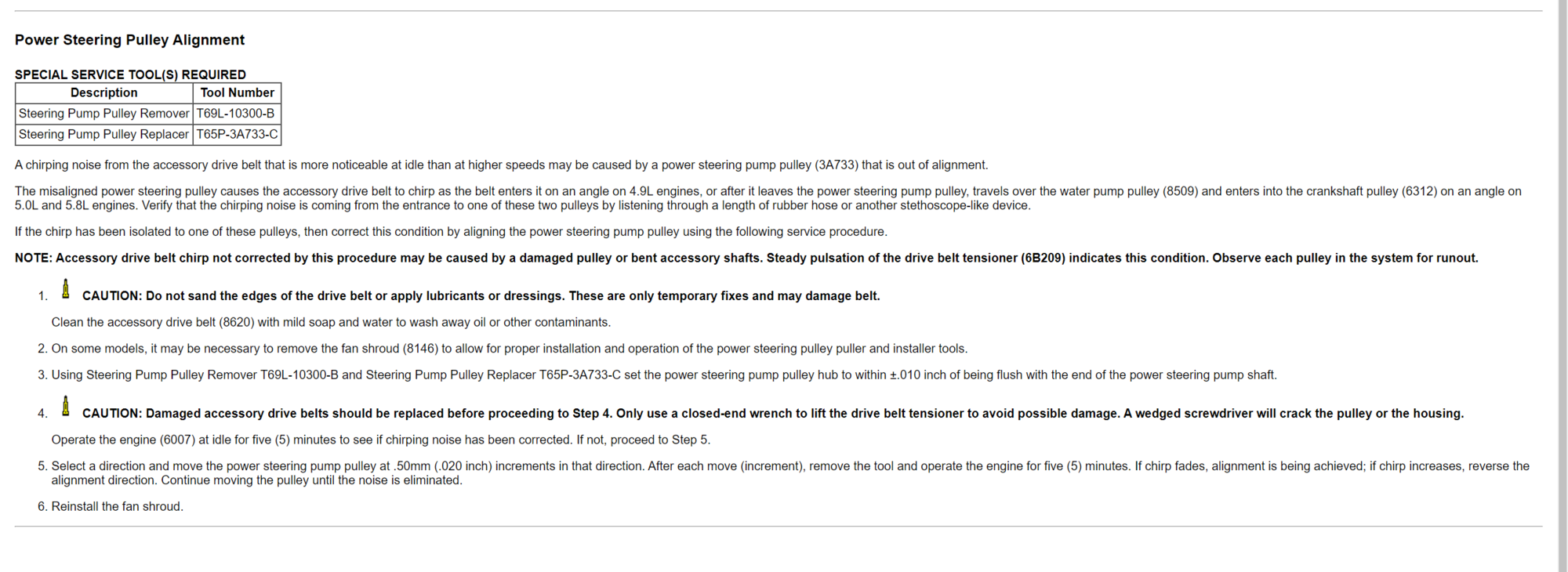

the walking can be caused by that tensioner pulley which looks like it may be a replacement for an old tensioner? if the tensioner arm is bowing away from the tensioner body that will ride the belt one way, and the pulley on the shaft can be moved because ford calls for initially setting it flush with the shaft then adjusting it to account for belt alignment

https://www.ford-trucks.com/forums/1...l#post20542231
