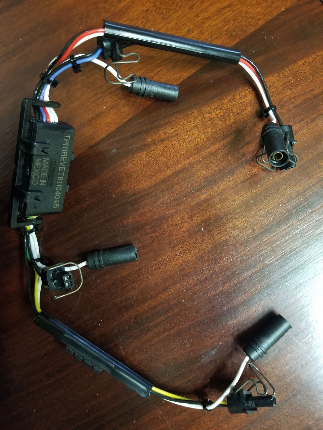

Has anyone had a bad Motorcaft CM-4884 UVCH out of the box. I know what you're probably thinking, but these looked legit...had the sticky styrofoam piece covering the pins for protection, updated mid legs on the securing prongs to help keep plugged in,the correct part number on the plug in, along with made in Mexico. Everything seemed fine but it threw a P1316-P code and has a miss at idle. Ran a buzz test and then threw a P1274 code for injector #4. You can see more details of diagnoses here: https://www.ford-trucks.com/forums/1...pgrades-3.html in post #36. So basically everything looked good and functioned except for cylinder #4 wiring and/or plug. I have 2 sets...one for the Excursion and one for the F350...but debating on sending the bad one along with the other one back and just using my original UVCH for the F350.

Got it...I checked the culprit injector connector for both the black (ground) and blue (hot) and they both show .000, so the only thing I can think of is something loose inside the connector when plugged into the injector.

That's the only thing I can think of because when I took the valve cover off I first unplugged #4 injector, changed the solenoid with another spare, plugged it back in, and ran a buzz test...same P2174 code shows up though the injector did have a stronger sounding buzz. So I unplugged everything again and inspected both sides of the valve cover gasket plug-in and everything looked good. Since I also had another spare valve cover gasket I installed that, hooked everything back up...with the culprit UVCH...and ran another buzz test, and same code pops back up. I have another new UVCH and valve cover gasket ready to go for my F350, so I grab it, hook everything back up and buzz test comes back clean. So #4 cylinder injector plug was plugged in several times, only to give me the same issue...code P2174.
Next I took everything back off and swapped the solenoids back, took the known good harness off the valve cover gasket for my F350 and installed it on the valve cover gasket for the Excursion, and hooked everything back up. Ran another buzz test, which came back clean...so I buckled everything back in place. I put too much value into that new Motorcraft UVCH being good and learned my lesson to check them with a buzz test before I install the valve cover back in place...along with the rest of everything else.
