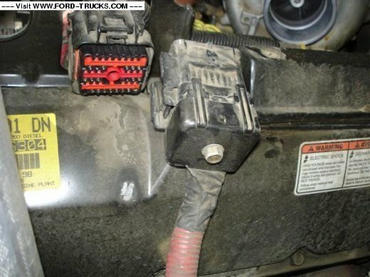

First place to look for random electric gremlins is underside of thee 42 pin harness. It drapes across the driver side valve cover where it can chafe and cause shorts.
