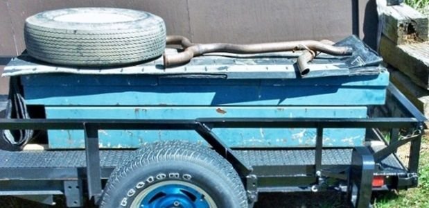

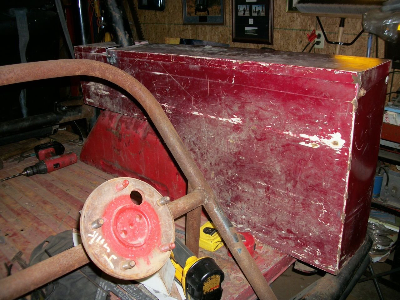

I made a picture with details long ago. I bought a tool box from Walt off of his truck long ago ($25), it looked made to order on his truck, and I even brought it home sitting on the bed rails of my '77. I've had it with a plan to paint it, maybe add some polished aluminum diamond plate or stainless steel for looks, just not sure yet what / if I do with it.. I've even thought of doing it in bed liner, either whole or in part. It's all steel, no leaks, I can imagine it being handy maybe. I measured it and my '77's bed. My truck bed rails are 65" apart, and with the rubber rail guards, 72" across includes the bed rail "rubber rail guards". Looks like this tool box is 63-1/2" long on the portion that sits down between the bed rails in that 65" space, though it's 71" total long. My bed is 19" deep, but this box will drop about 9" into it, leaving 10" free space under it. The tool box is 20-3/4" deep front to back, so above the 10 inch point, my 8 foot bed would be more like just a bit over 6 foot free, but a full 8 foot plus for the lowest 10 inches. Looks like there would be 6-3/4" of tool box / lid above the bed rails, just enough to be seen in my mirror. I'd probably use the front most tie down holes I already have and an extra pair to hold it down, or maybe clamp type. I like the two 25-1/2" wide side opening lids with near 19-3/4" wide fixed center section. I need to find some keys though ... or something like fancy hasps?
I got carried away.
Yeah, 72" works.
A long full length lid will likely have two latches and may mean getting up into the bed to get into it for stuff ... it can get old.
Side opening twin lids might mean shorter items, but can usually be accessed from the side while standing on the ground. You can still put some long items in, but not huge box filling items.

I was seriously thinking of pulling this old one out and refurbishing it, it's plain steel and seals are old but there are deep channels to drain rain water off with no leaking in. It has some minimal scratching with minor rust in the bottom from "tools", and I'm thinking the new offerings, in a black, new seals, etc ... low top might be the way to go now.
It only drops 9" downwards into the bed, but then 4-3/4" of the base is above the bed, then the two side opening "clamshell" lids are 2 more inches up, so fully 6-3/4" of it are above the bed. Who knows, I might yet drag it into my shop and redo it as a "project" ... It would be tougher than aluminum. That was how it looked a few years ago, and while it's been outside ever since, it has been up on blocks and covered behind my mower shed, so it looks the same. Latches on the ends (push) work and both lids pop up easily on their own (springs), but I have no keys for it, but then I think maybe I can find new latches with keys? My narrower spare would slide under it too.

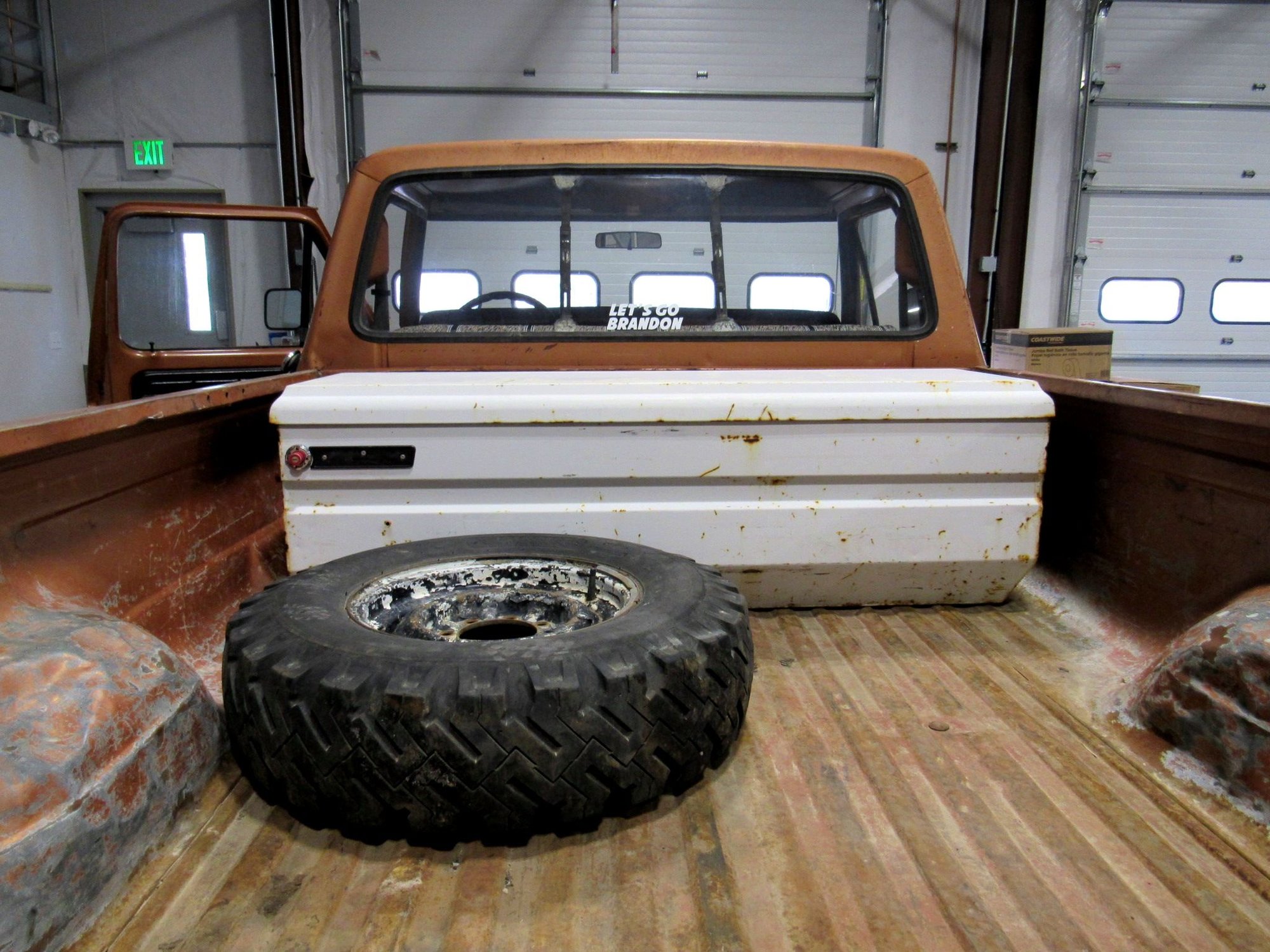

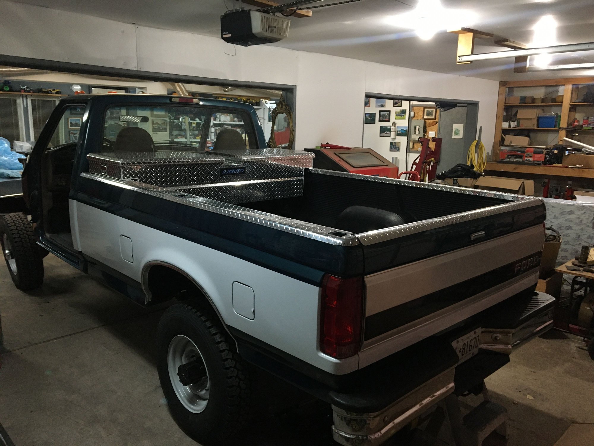

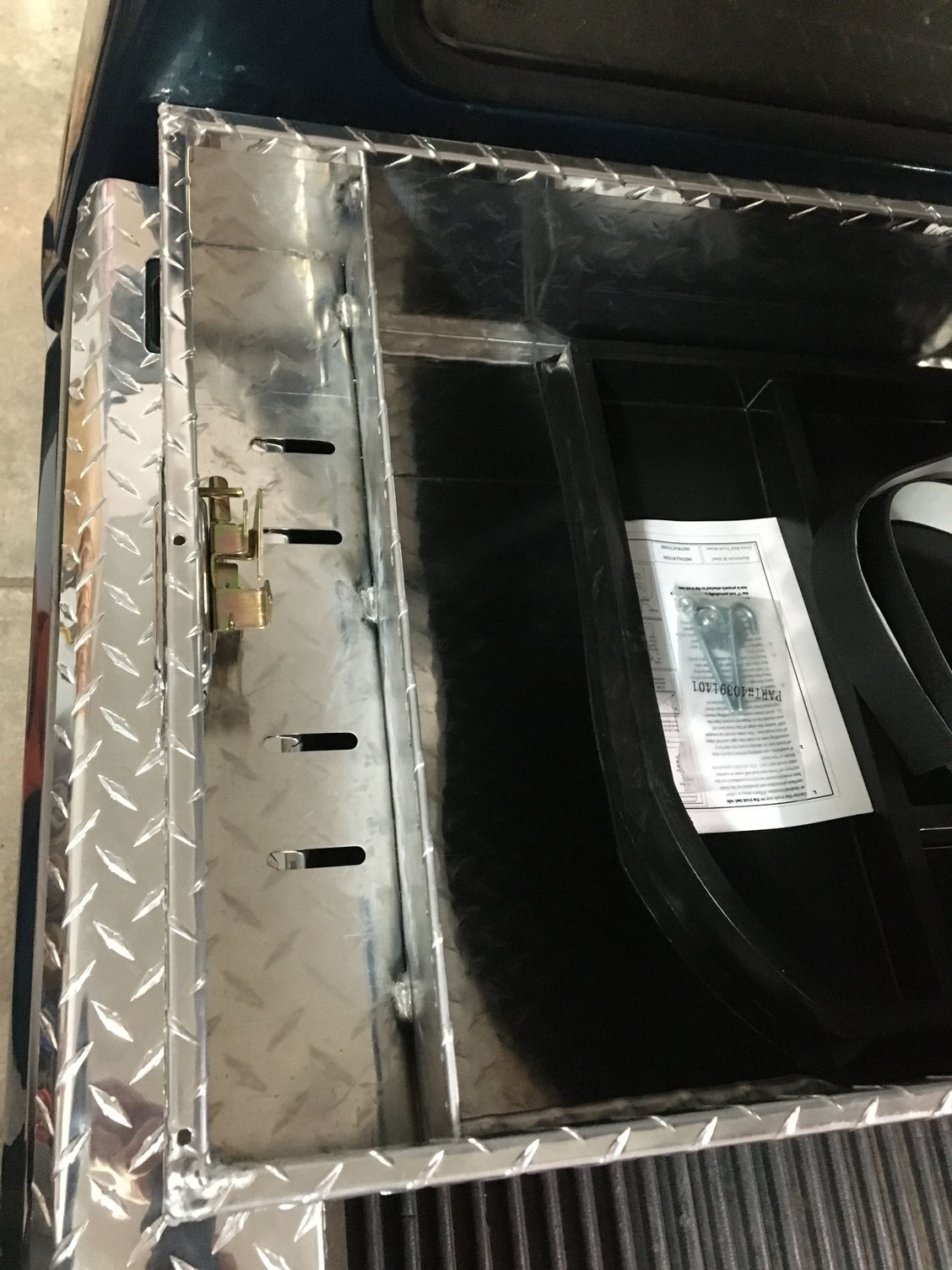

Good point there. The old blue one I have with a higher "reach over into" generated just because it sits 6-3/4" above the bed rail, IT would be a PITA to reach over into ... especially for my Wife. Maybe a piece of EMT with a hook, aka: a "Shephard hook" kept near by?
Easy to forget ... but that's a big part of reason I bought a low profile one a few days ago. Those "extra" inches more height above the bed rail translate to "double extra" more inches total reach required to reach up and over and into the bottom when standing on the ground beside the bed.
02-26-2024: About the new box, see Tbear's 77 F150 thread - Page 4 - Ford Truck Enthusiasts Forums (ford-trucks.com) post # 57 and #58

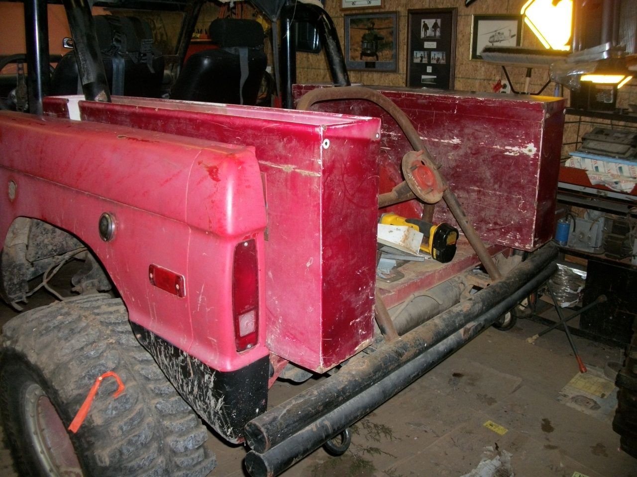

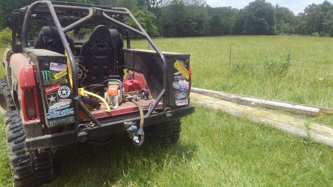

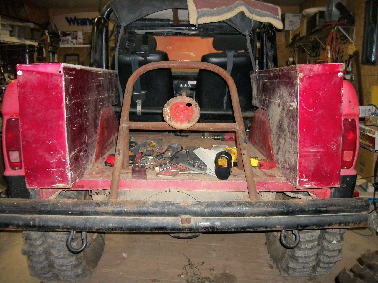

I forgot to mention Fenderwell tool boxes. Nice, yes smaller than a cross bed box. But fit behind the bed header panel, and stick out no further than the fenderwells. So if you have a short bed you can still put a 4 wheeler in there. I use full size ones in my Bronco. No way to carry anything.
Yes they stick out, but not past the bumper, I do not have a tailgate anyway.
Better pic. I even notched the lid to work with the getto light bar. And have sense changed the light bar to a proper roll cage and welded up those openings.
Lids can go on either way, or either flip open direction.
Yes those are 79 SC folder jump seats. I was in the R&D mode.
Grandkids love to sticker the Bronco. The tool box ends are free game.

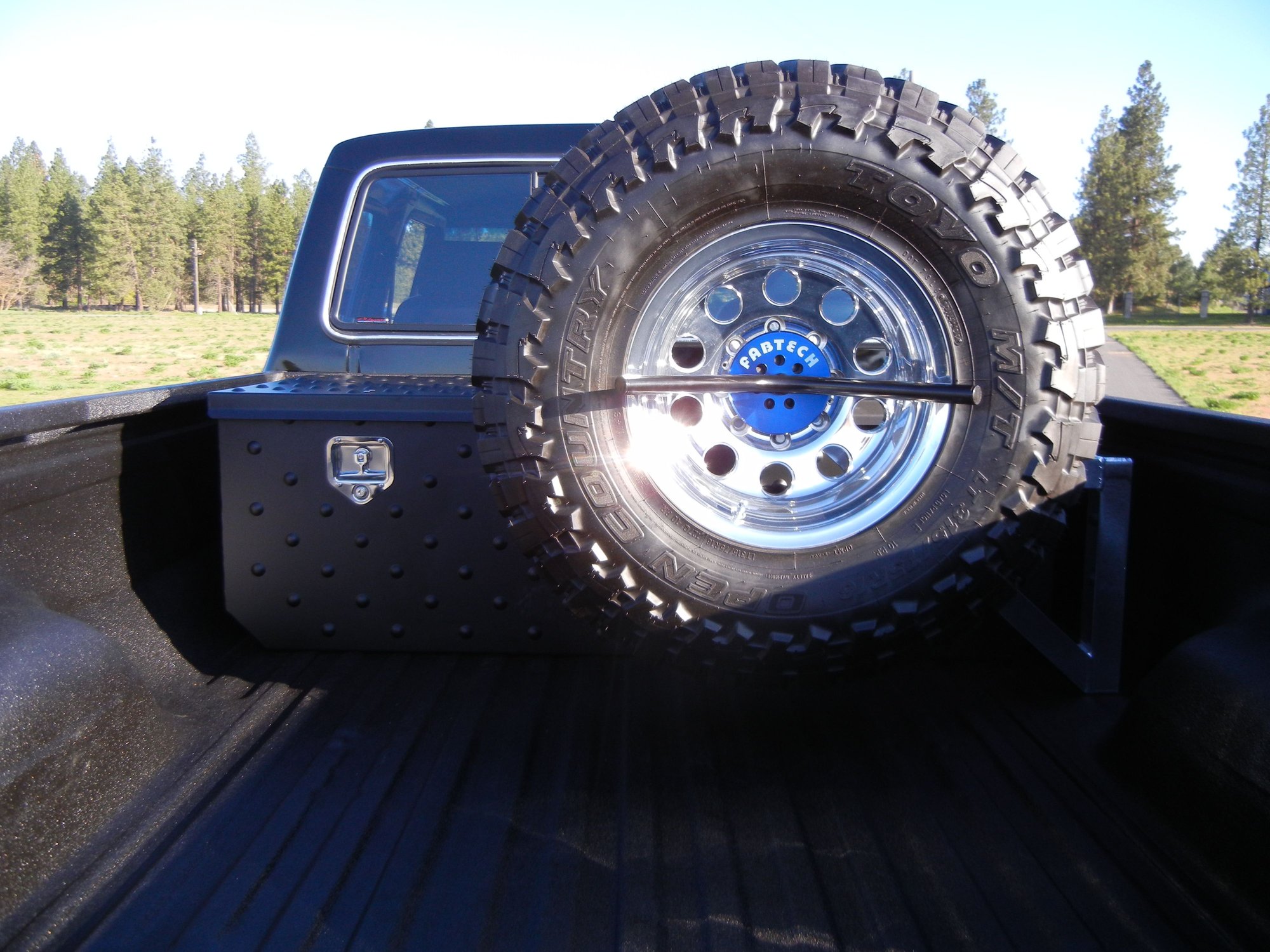

Weatherguard #161. They make a full size version and a mini/smaller version. I am not carrying as much trail repair parts now days, so I am down sizing to the smaller ones.
I got mine off Craigslist for 20 bucks...
