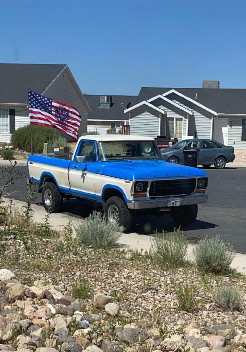

Trying to understand why the mileage on my truck is so low. It’s a 1978 f150 4x4. It has the np435/np205 combo behind a 302. Also has 3.50 gears and is sitting on some 31x10.5r15s. I’ve driven this truck roughly 1000 miles since I swapped the 302 in and I’m averaging about 5mpg. Does that sound close to what you guys are getting? When I researched the swap most people I’ve seen are at least getting 10. Any thoughts or suggestions? Below is the truck in question

Is your truck lifted? Thats a mileage take away, Mudflaps, take away. wider tires are a take away. The bigger mirrors are a take away. Nothing against the American flag but if that's mounted in the box it's a take away. Ford did studies back in the day of the cafe days and people would complain they didn't get the stated mileage. Ford published the findings for dealers to help them check for deviations from stock on mileage complaints. Nothing wrong with 302's, I have one in a half ton 2wd but if you are driving it in the 80mph Dakota's it really runs out of steam. Small blocks are a little short on torque. When the 80's came around and the long runner F I intake really helped pump up the torque. 5 mpg is pretty bad, as others said you may need the distributor checked. My 2wd F150 gets around 15 at 55 mph speeds,
