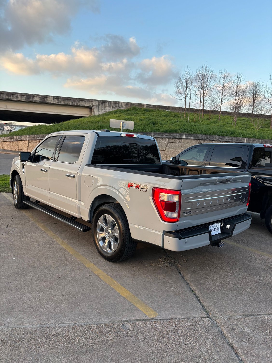

I already resolved this situation. I went with the Ford Performance 1.5 inch shackle and block removal. I put Bilstein 2wd shocks and 2wd Struts. The struts gave me an 1.25 drop in the front. 3 inch rear. Looks good, rides great, and this is only temporary. I will be going with the Ridetech kit this summer.

Stangdiesel, how about a few pics. Before and after if possible? Where did you buy, who installed? You got me curious

Hope this works.
