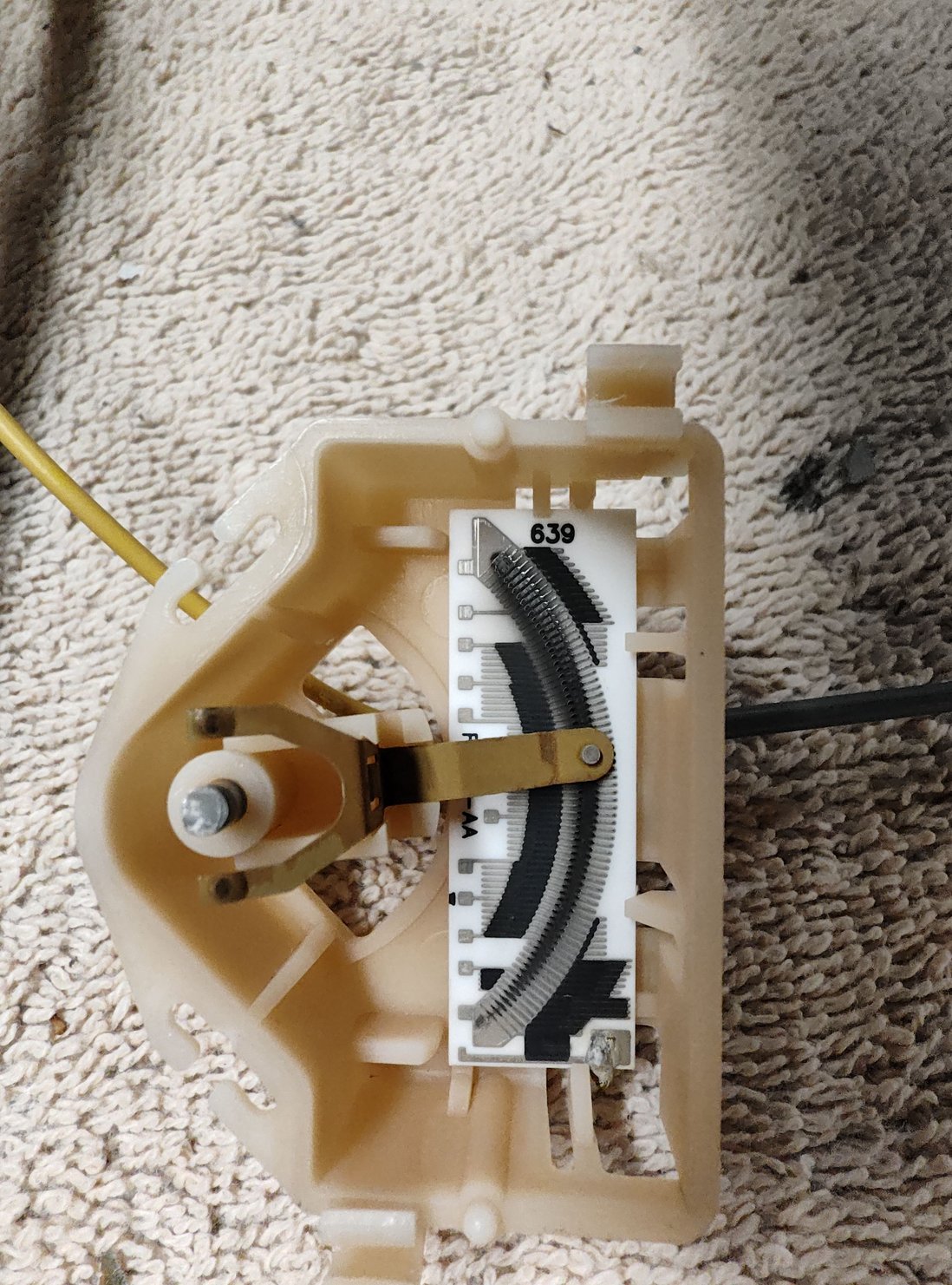

The fuel gauge sending unit is a variable resistor that changes value as a wiper moves across it with the gas level. My 97econline had a wear spot on the resistor where the wiper rode most of the time...just below the 1/2 tank mark. This wear sport caused erratic resistance readings and explained why my gas gauge would not move reliably until the wiper was off this bad section of the resistor. You can measure the (almost) empty and full resistance values and compare to the specs on a new one. If the resistance is OK you will have to troubleshoot the corresponding voltage going into the ECU.

Here the the level sensor from my van. You can see the extra wear 1/2 tank to empty. When looking for a new fuel pump I did not see this part as stand alone option. If you are going through the trouble of pulling the pump, you should replace the entire assembly. But you have to search to find a high quality pump assembly if your is out of stock at Ford.

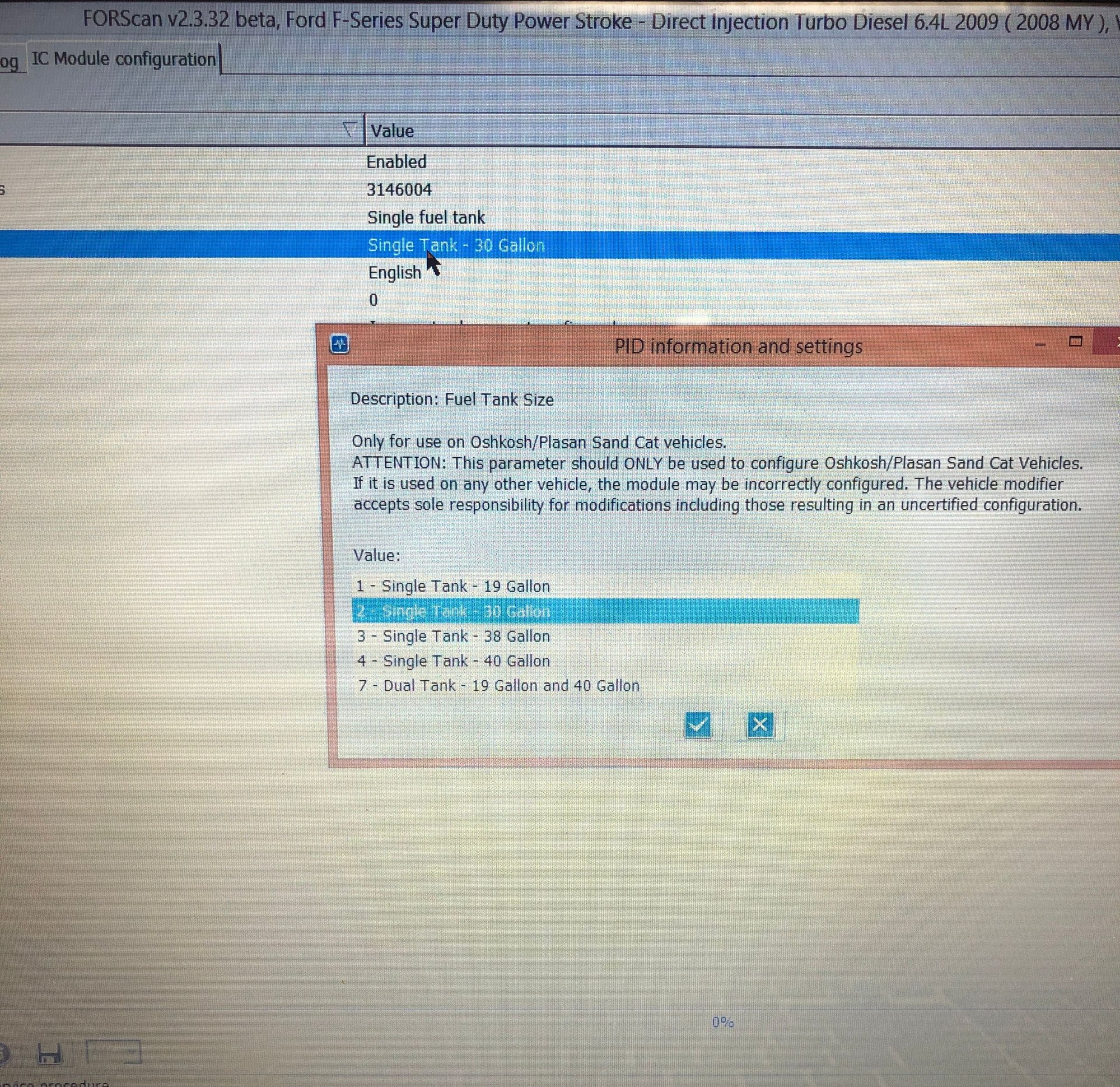

There is one other possibility I’d like to put out there as you don’t know the full history of the truck, if someone swapped out the cluster or went in and changed the fuel tank size to a 30 or 19 gallon tank, this could be your problem.
As for a bad sending unit, the cluster would throw a code for that, a standard obd2 reader won’t show you it as it’s not emissions related/pcm, I would get forscan and the recommended adapter and check your truck over with that, you can also check fuel tank size and change it with forscan.
