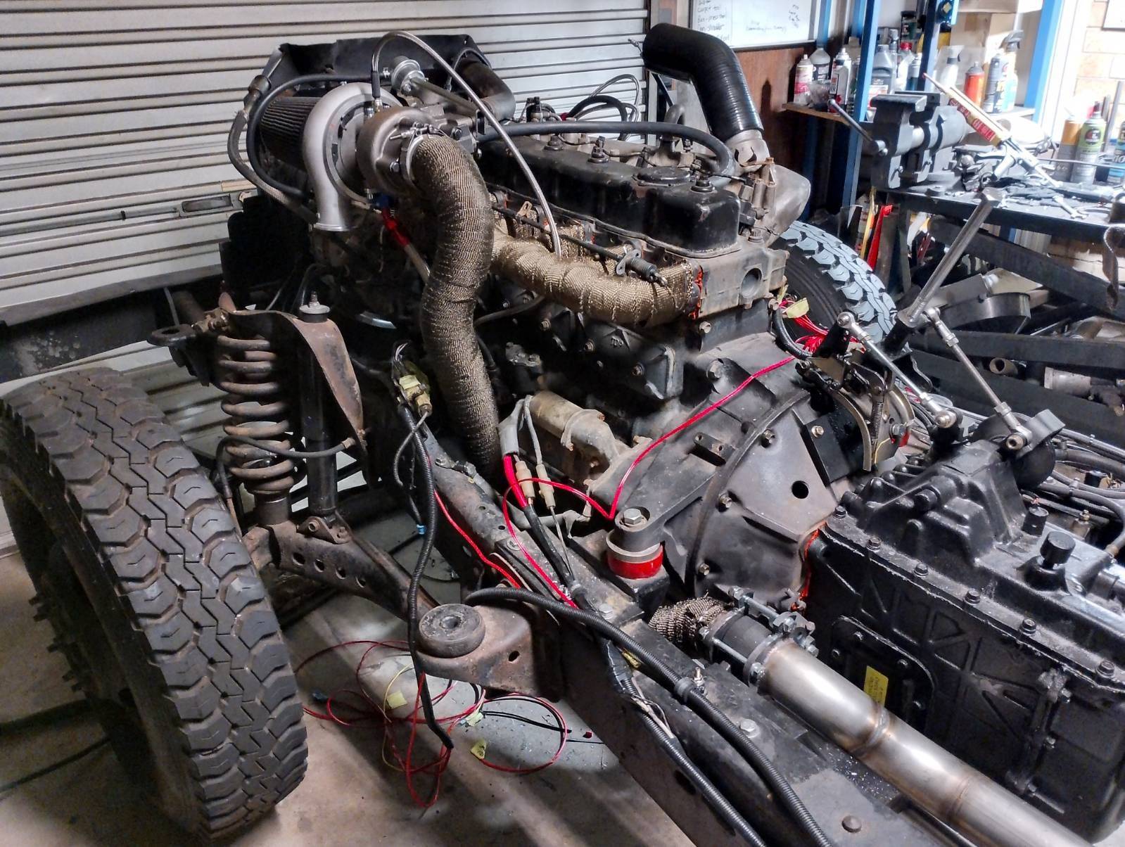

Custom manifold built, turbo installed and also a 6 speed overdrive installed... a friends building the intercooler hopefully over the weekend to speed things up...
Should be running again within 2 weeks.

...and the cooler is now built.

Intercooler is installed... will try to make a video soon of how it sounds as ive also adjusted the valves... so nice n quiet(er)... yep, im getting old.

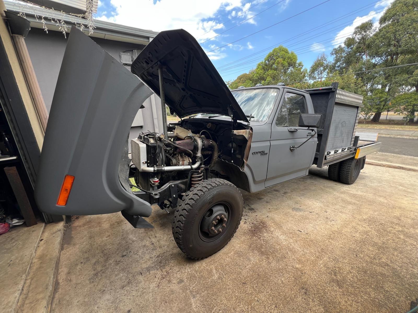

Finally a tilt front... nearly finished.
Cool as (in my opinion) and so much room for maintenance and playing around.
Still have the 4 link air bag rear to do, using air bags from a semi... all in good time, but soon...and then that's it for this project!

Quick update of registration... This ute has passed an engineers report with all the mods and is approved to drive on public roads... there was only a few small things that I needed to replace, ie the GPS speedo (not allowed), exhaust needed to go out of the perimeter of the ute and to the back or right hand side, air and fuel lines needed to be secured every 300mm (foot). I had to make an airbox for the air filter, and had to work with the tilt front, and also get a certificate for the a brake test and speedo calibration... Aussie rules.
81 F350 done... Start the 81 F700 very soon.
