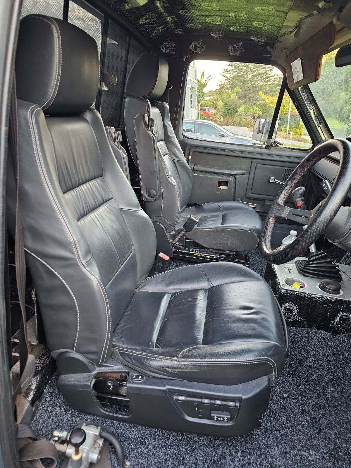

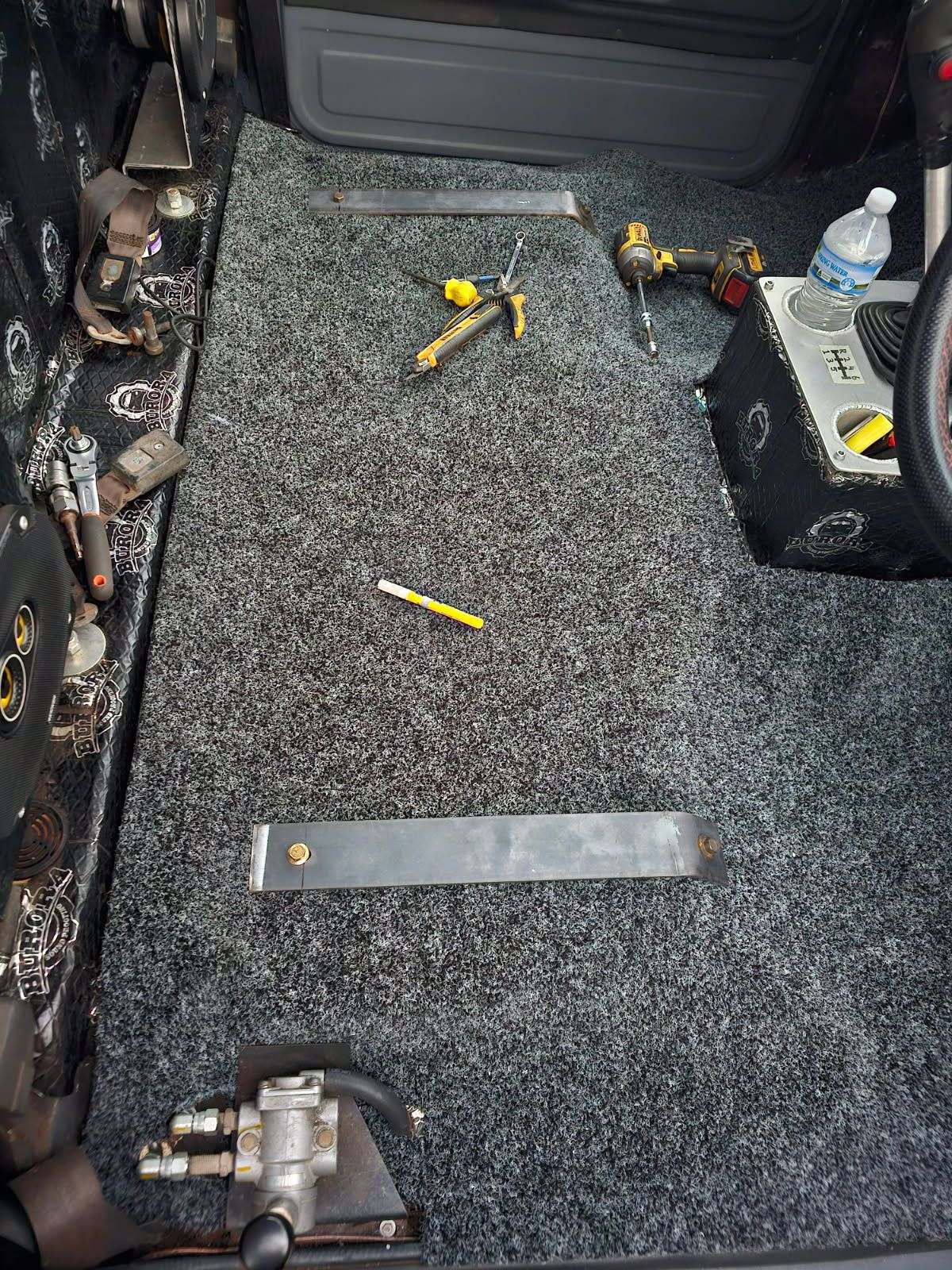

If you're tall and wish you had that bit more room in your single cab, these Range Rover seats are a good option... I made a low profile bracket to keep the seats low... gained space on top and at the back.The electrics are basic, heaps of info online too.
...And they're super comfortable.
I wont post any more on this as its now more 'projects' than 'engine swaps'.

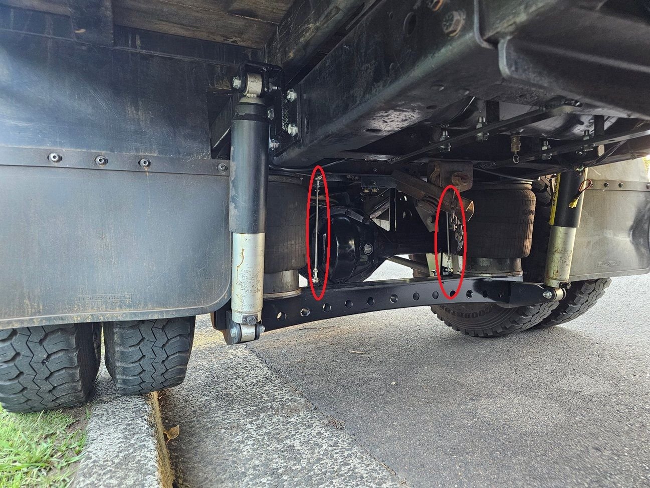

I couldnt help myself and had to share... this is an awesome upgrade. Semi truck sized air bags makes your ride what it or what you needed... worth the time and effort. Dont find excuses just a time to do it... whether you've done an engine swap or you want that comfort ride, this is your answer..Cost was about $3000 AU, or $2500 US. 4 link, air bag swap, no leaf springs.. will be more if you're paying someone to do it.

is that setup auto leveling, or does it lean like a leaf spring setup does?
i love the ride of the air bags in the 2022 kenworth when empty, but not having auto level scares the you know what out of me on turns.

These look like links for leveling valves to me.

i did not notice them before, thanks.

Yes, as FordTruckNoob pointed out, it has 2 Hendrickson auto levelers, on for each side as she would lean due to the tools and fuel tank being on one side.
Also those bags only take 13psi to keep it at right height, so im sure that contributed too..
