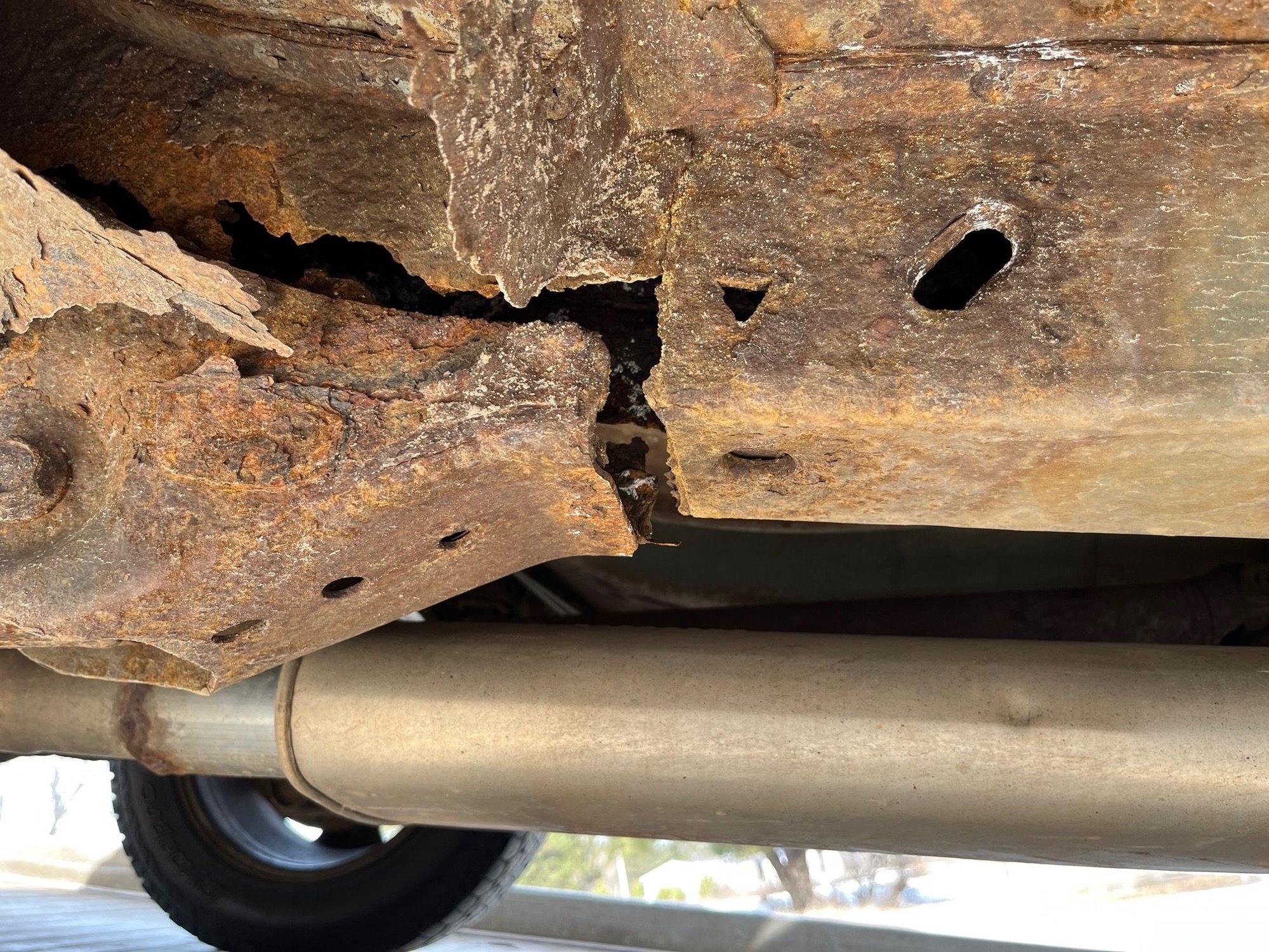

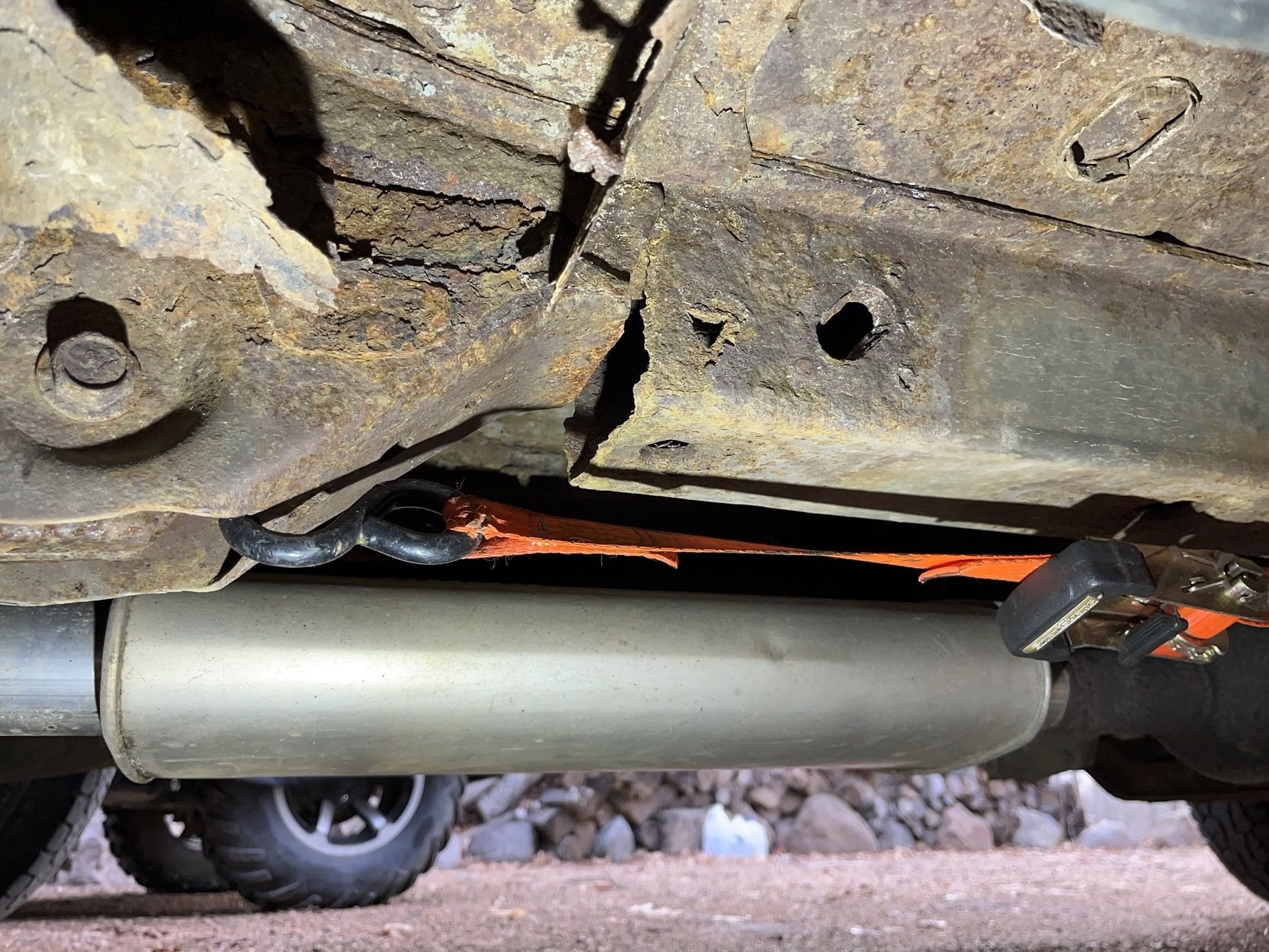

Here's what my 2004 jeep Grand Cherokee Freedom frame looks like. It has very little visible rust and looks very presentable:
I looked into having it repaired and had someone willing, but in the end decided to just retire it. Junk price was $400 a ton. For now it's still in my yard because I've been pulling parts off of it.
I pulled it together with a ratchet strap so it was somewhat drivable. I was able to get it home and figure it will make the 15 mile trip to the junk yard under its own power when the time comes.

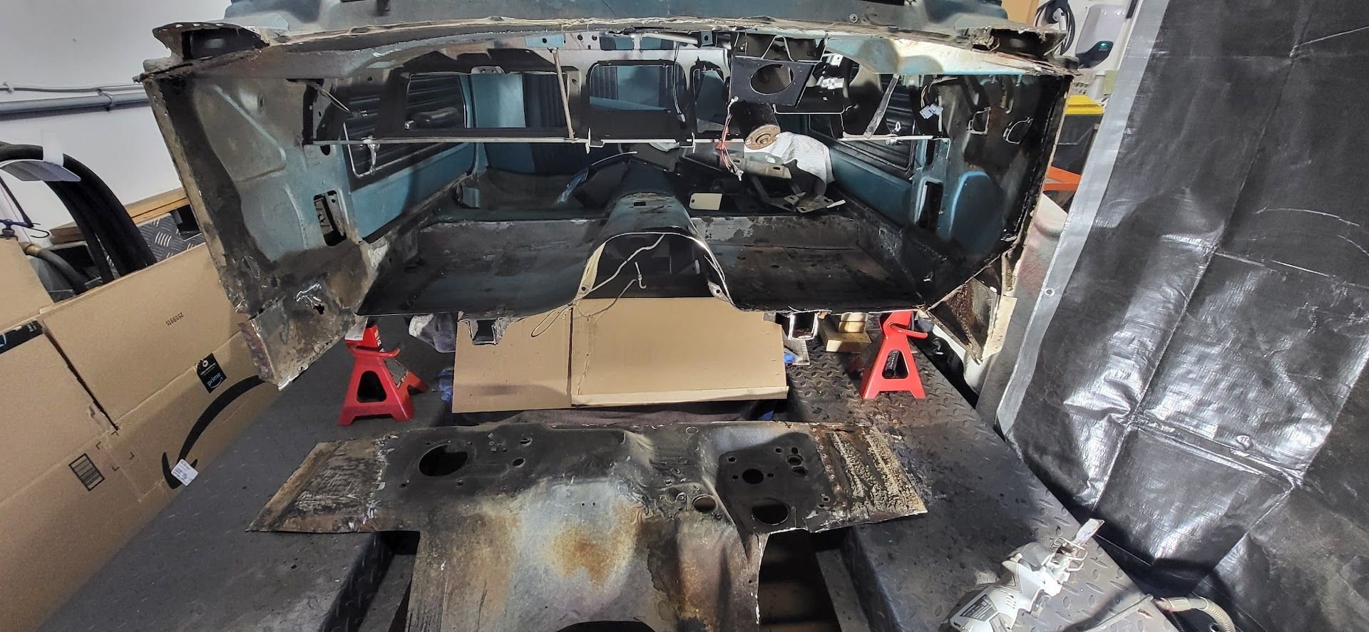

I'm not sure I would even consider what the guy did as frame repair. All he did was weld new metal over rusted junk. I would call it a cosmetic band aid over any other term.
True repair should have been cutting out all the rot until you find solid metal and then weld in a new section. Problem with that is once you start cutting you'll never stop since my guess is that whole frame is gone.
From the pics above, the old metal will continue to rot away and in parallel start eating away the new metal.
I'm currently working on a a 68 mustang where the PO decided to weld new metal over old rotting metal, as well as use body filler to mask a bent frame rail & firewall from a previous accident. As you can see from the pic, the only solution I found was to cut out the radiator support, old frame rails, inner fenders, radiator & firewall so I can start over with all new metal. Wasn't a single place you couldn't push a screwdriver through on the frame rails (both old & new metal was rotted). Big job, but after it's done you'll no longer see the whole front end twist when you jack it up.
Jim
A dab of JB Weld will make that good as new!
