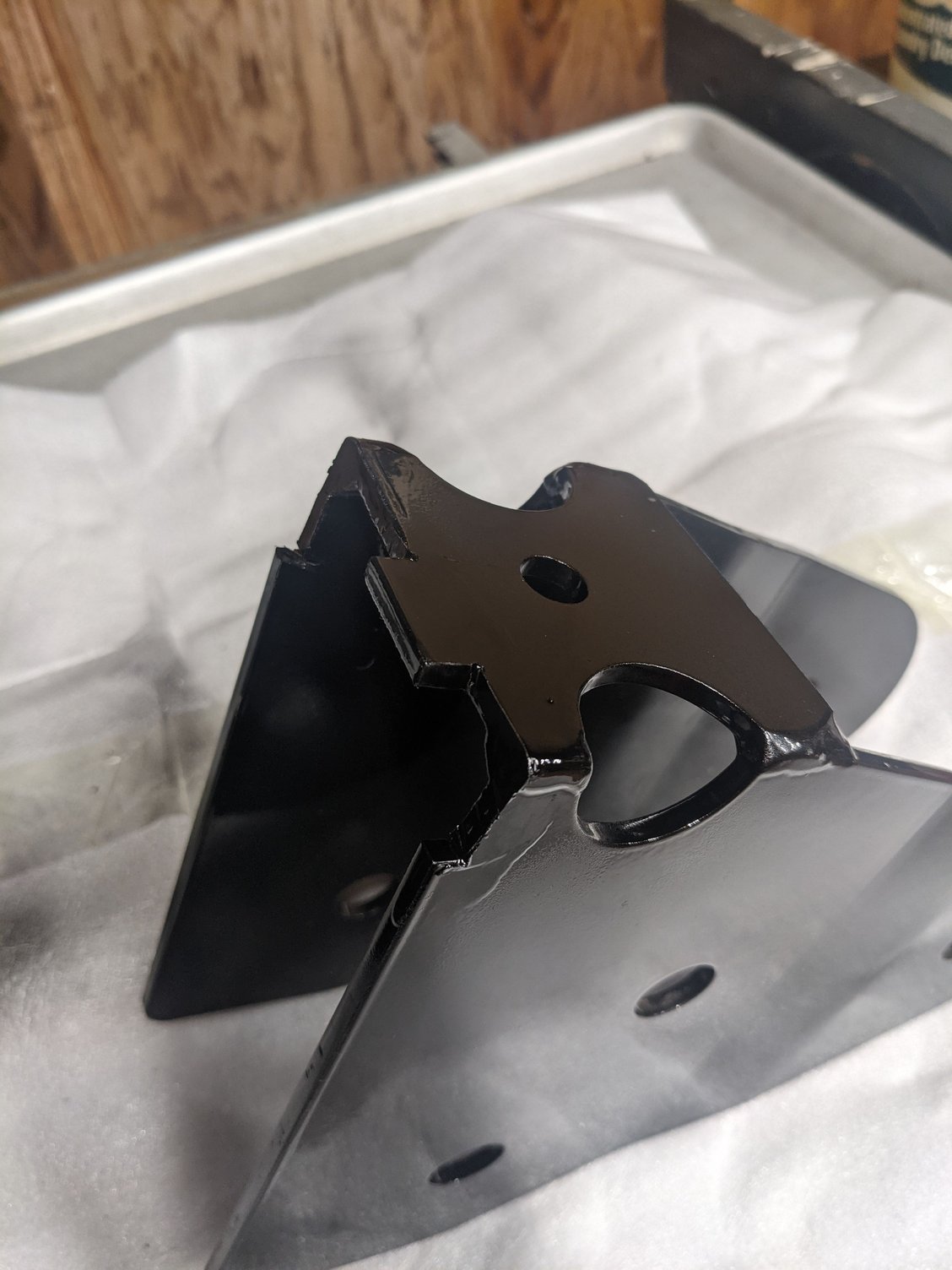

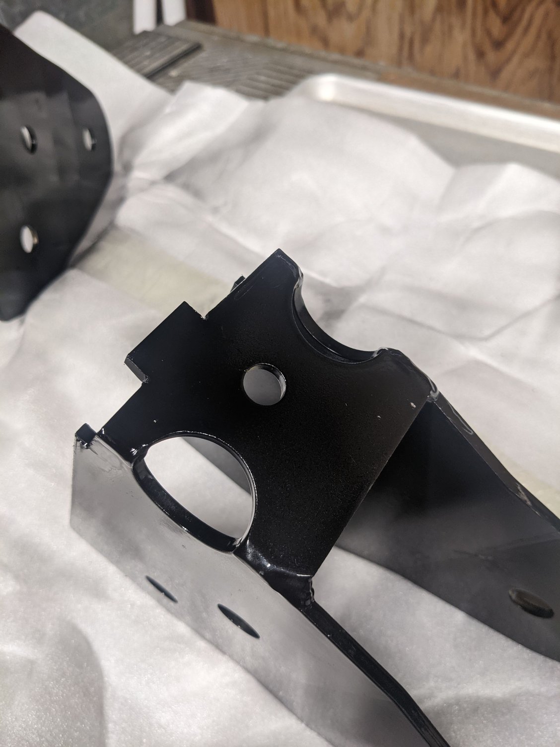

I searched online and found radius arm drop brackets from multiple vendors. All of the units I found said they didn't fit a 2019 but I figured they had to be close so for $100 I took a chance and ordered a set. They are made from 6.35mm steel, they are powder coated and they came with steel spacers and Grade 8.8 bolts. All told the hardware weighed right at 16 lbs. - very substantial. When we test fitted them they fit perfectly width and length-wise but they did not seat far enough upwards to allow the rear mounting bolt holes to align. We were able to determine that the very rear of the bracket, on the corners, was about 1/4" too tall. We broke out the cutting wheel and a file and modified the brackets, cutting the corners out and leaving a tab sticking up to contact the frame, like this:

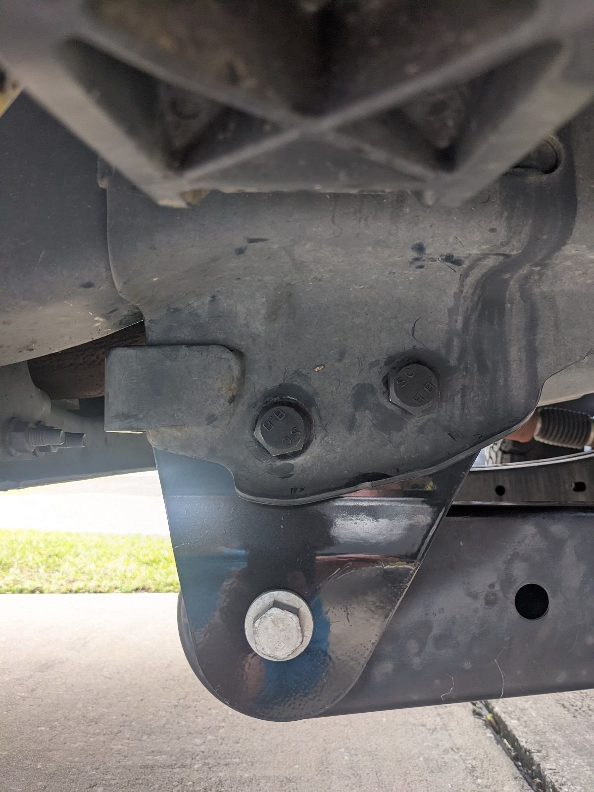

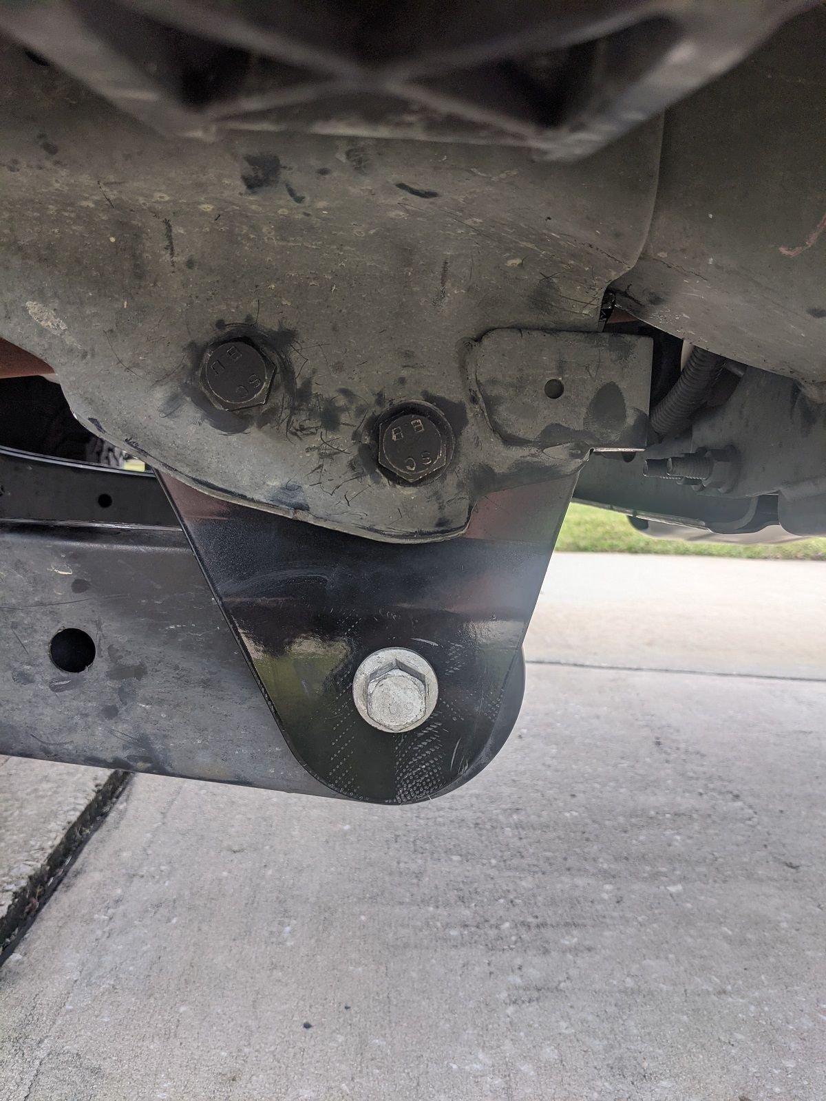

After modifying and painting the brackets we installed them:
I decided the pinion angle is still very acceptable. Opinions are welcome from the forum members:
Finally I took it to have an alignment done. I need to find my previous alignment sheet but if memory serves me correctly it was at 5° before so the radius drop brackets added roughly 4° of caster.
While 9.2° of caster looks way high on paper, the pinion alignment is fine in my opinion and the truck drives so much better at speed that there's no way I would go back to the way it was. I think I am going to put the factory caster shims back in place and see how it drives. I believe that should drop the caster back closer to 6° or 7°. I bought the lifetime alignment plan from Firestone when I bought this truck so it has already paid for itself twice over. If I get the shims swapped and another alignment done I will update this thread with the new numbers and how it drives. The Firestone alignment plan says I can have an alignment done every 6,000 miles so it may be a bit before I get it aligned again.
