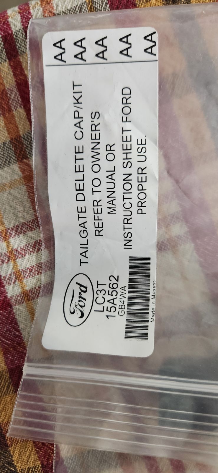

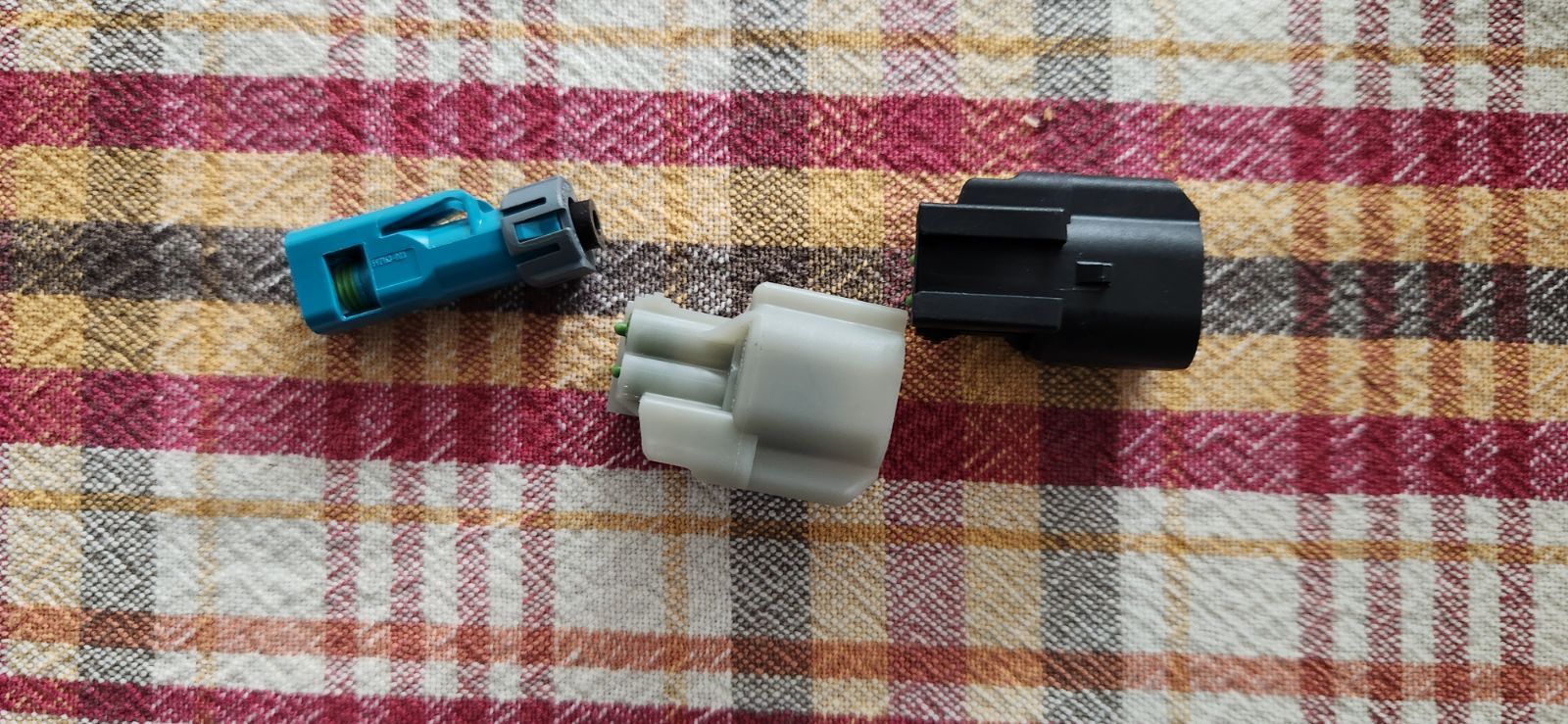

What are these?
I found these in the glove box under the manual, the bag says see manual and it just says to use them. I did remove the stock gate and replaced it with a louvered towing gate. I disconnected the gate wiring and thought these capped the wires under the truck that had been disconnected, they do not fit any if the connectors under there. I googled the part and came up with a delete for a 2015-2020 F150, not sure how they go into a 2022 F350. The illustrations I found show 4 connectors and I only have 3.

If you remove the tailgate, those are plugs for the wires you will need to disconnect.

water proofing plugs for when you remove the tail gate .
