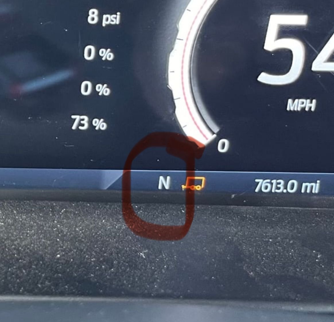

Thanks for posting this! I’m due to have mine done. It looks like they fixed the compass issue too. Can you confirm that you have a compass now?
Old Dec 20, 2023 | 07:47 PM
Flitastic's Avatar
Flitastic
Joined: Sep 2019
Posts: 571
Likes: 56
oh yea! It’s there now .
