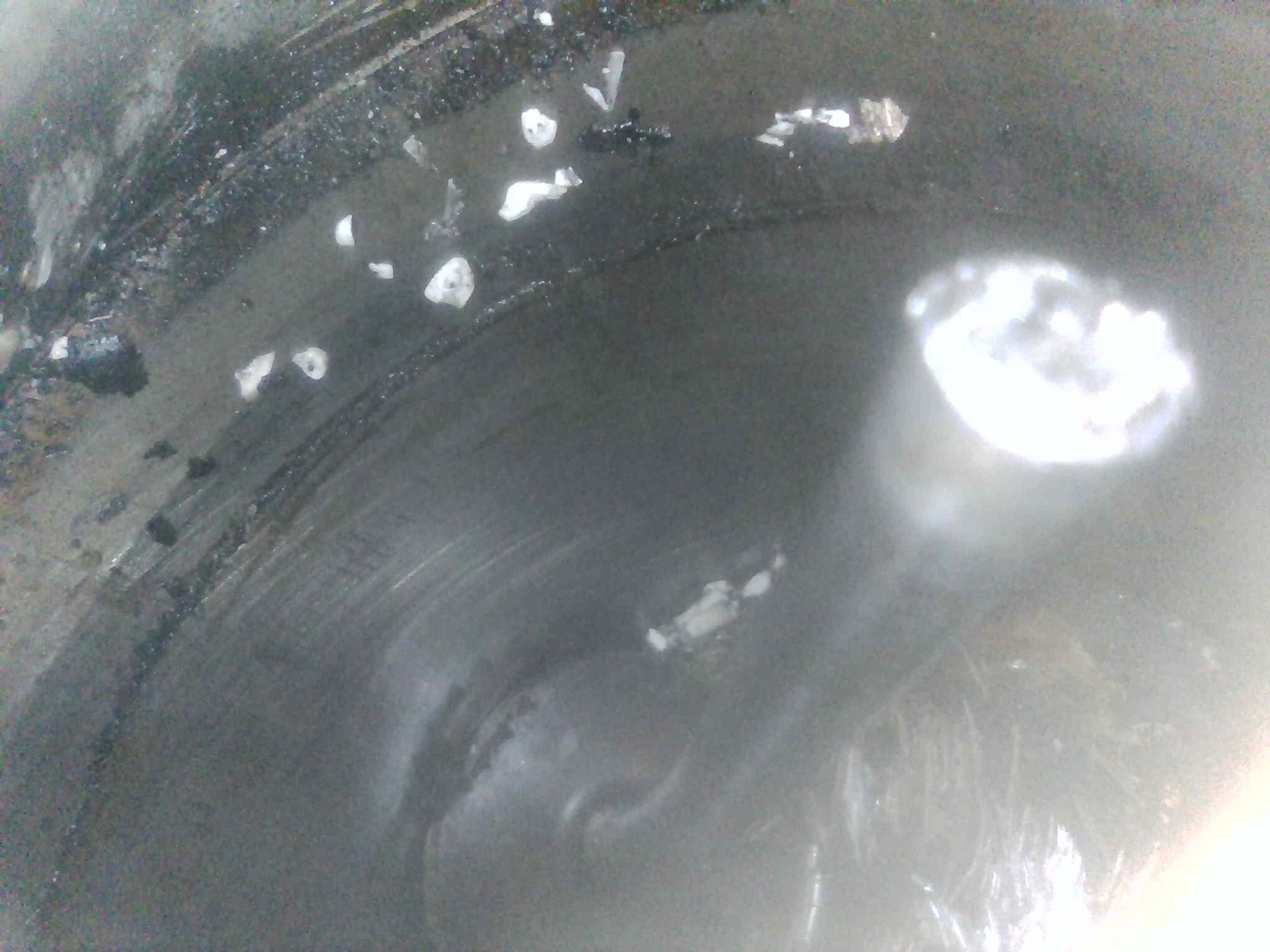

What is the best way to get to the torque converter nuts on my Sport-Trac? Do I go from underneath? I took the exhaust manifold off to get the starter out but I still can't reach the nuts. There is a piece of the suspension that is in my way, but I saw a video someone briefly mentioned moving it out of the way when they replaced the starter, but my starter is already out so not sure if this will help me. I'm having problems turning the engine over anyways(see picture) so I might have to pull the transmission with it so if you have any thoughts on that I would be interested in hearing them.
