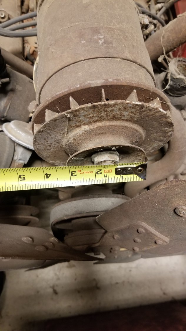

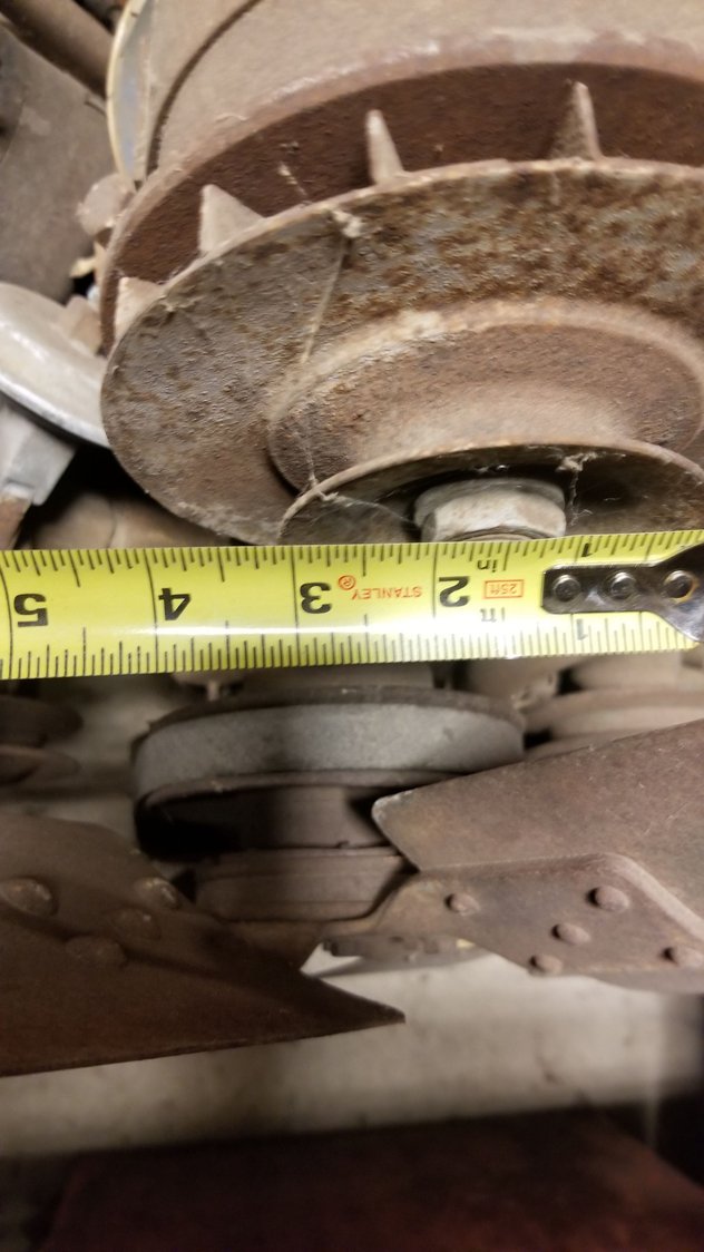

I need to know OD for the Generator Pulley on our Trucks (F1-52 with 239) Can you help me out here?.I know it has the wide belt. Thanks!

It measures out at 3 1/8", or 79.375mm.

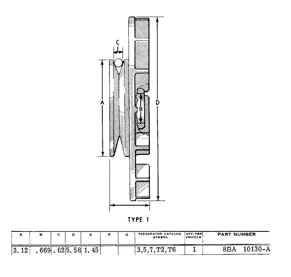

This is another one where there are many possibilities. Again, your Generator ID of FAA-10001-B 35A Generator eludes my documentation. I would default to the 8BA-10130-A with a 1.97 ID and a 3.12 OD if it seems to measure up to what you have.
