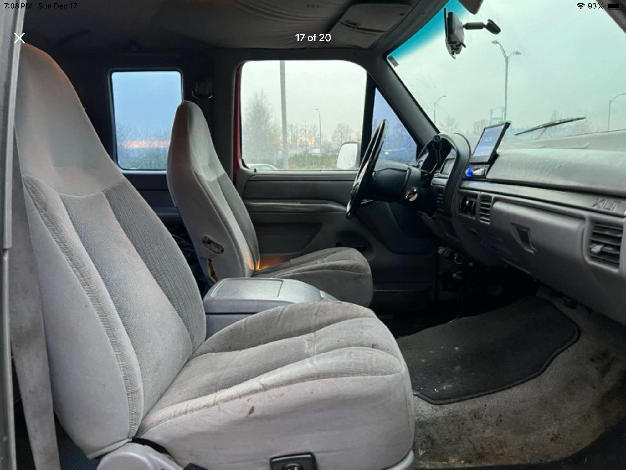

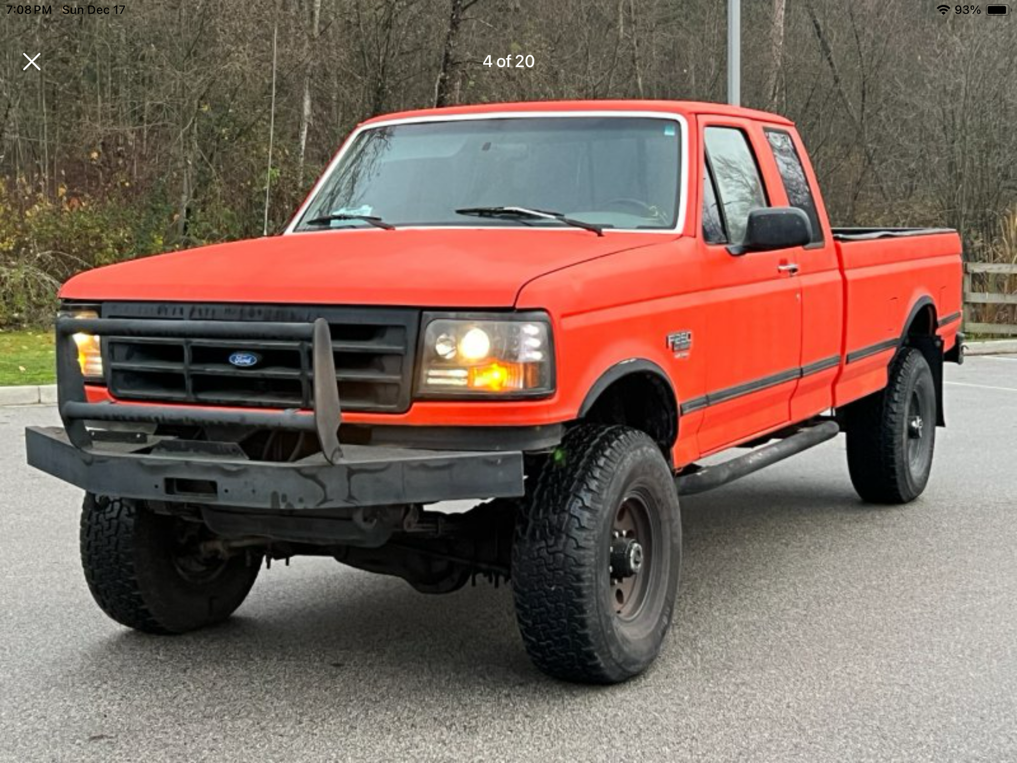

I really like those old body style trucks. Certainly the F250 would be much more capable than your F150. I guess it all depends on the condition of the new truck compared to your old one. If similar, the price seems OK, so it might be a good move for you. If the F250 is in good shape, it will provide you MANY years of good service.

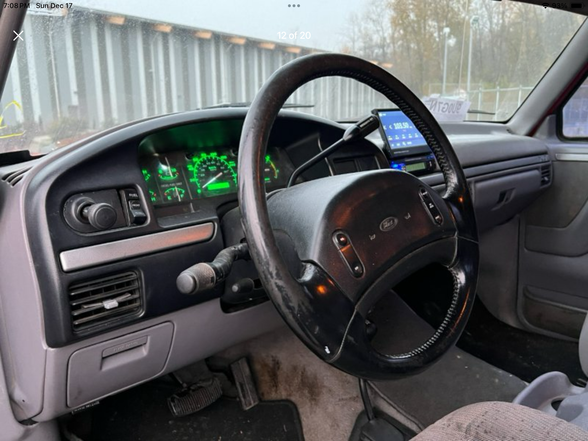

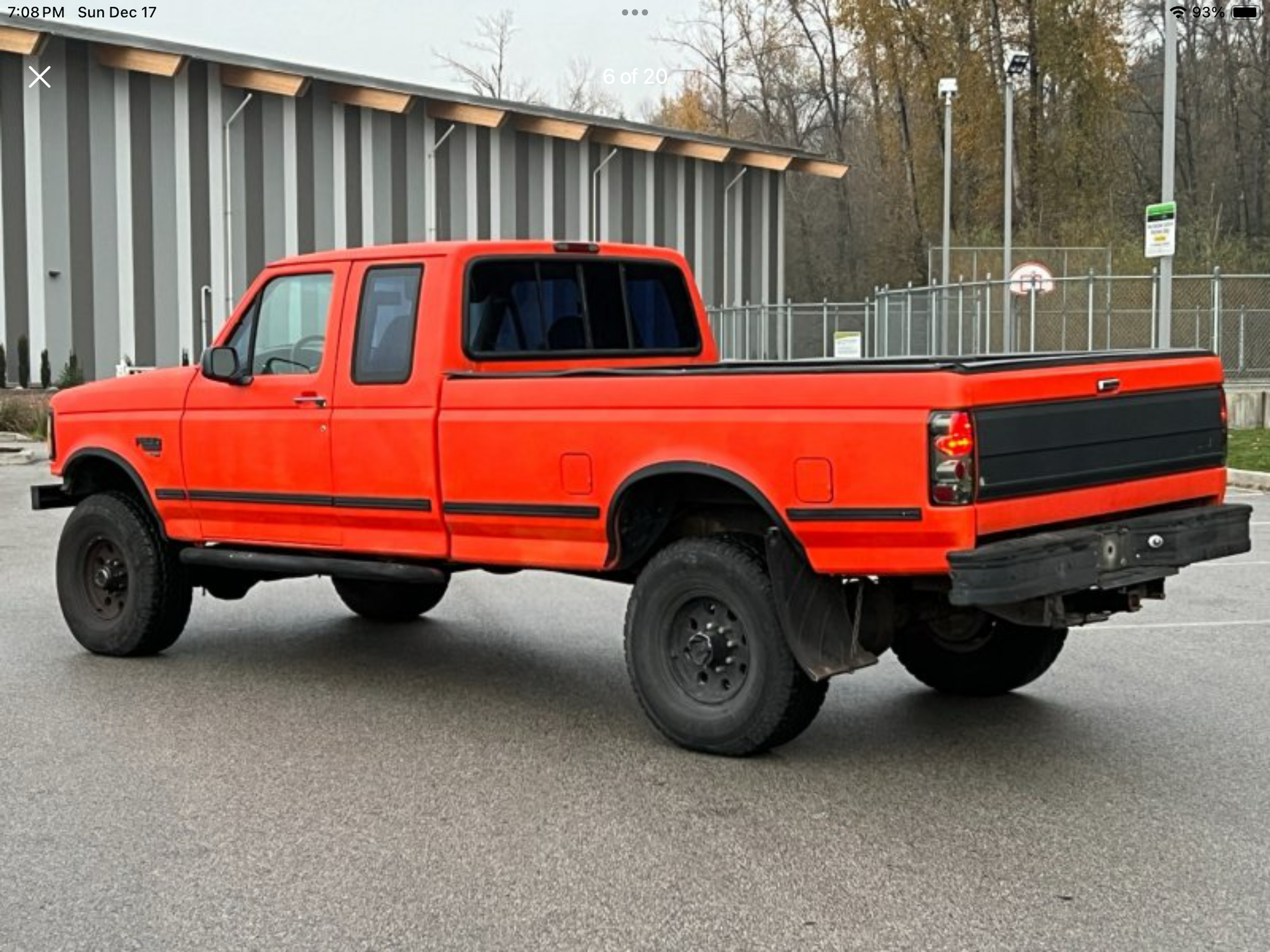

that 250 had had a lot of redneckery done to it as can be seen by bumpers, paint, wheels and interior lights and radio modifications.
my personal opinion would be to run away from it.

Have a diesel mechanic familiar with the 7.3 go over it! A lot of things to look for and it appears there is a better than average chance this pickup has seen some ‘hot rodding’ and heavy off road use.
Other than engine, the truck is no different than any other F250. Ball joints, door hinges, body parts, bed…they all wear the same. The older they are the more they become either a problem, on going project or take more and more TLC.
The motor is an outstanding diesel engine but not without a few problems. I didn’t see the mileage listed.
I have some serious concerns with what I’m seeing on the truck the OP has pictured. Like Tom pointed out a lot of things have been done to it. A lot of mods to include grill, headlights and bumper, tires, wheels nerf bars. Could be a problem with parts replacement.
What type of paint is that? Non standard at any rate and will be extremely difficult to touch up or even match. I’ve seen something similar before in pickup I was looking at years ago and they had used bed liner to repaint the pickup. They were trying to cover up body damage and poor repairs.
The E4OD transmission is a good transmission but if the truck has 100,000+ miles, or in that neighborhood, you probably should have a transmission shop drop the pan and inspect it. There have been Ford upgrades to it and a rebuild may be in order. Many people refer to this as ‘bullet proofing’ the transmission. I don’t consider anything as bullet proof.
You probably need to ask about the UVCWH (under valve cover wiring harness) and when the glow plugs had been changed last. Both of these are maintenance items that need periodic inspection and / or replacement.
With these trucks it is almost considered a ‘must have’ to carry a spare CPS in the tool box.
