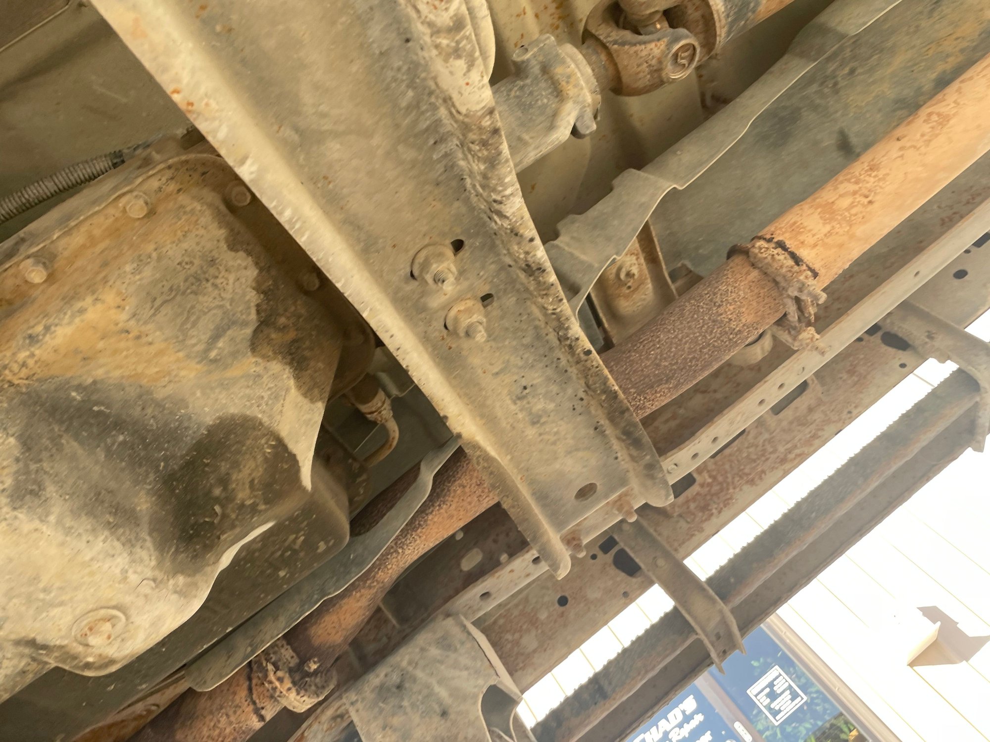

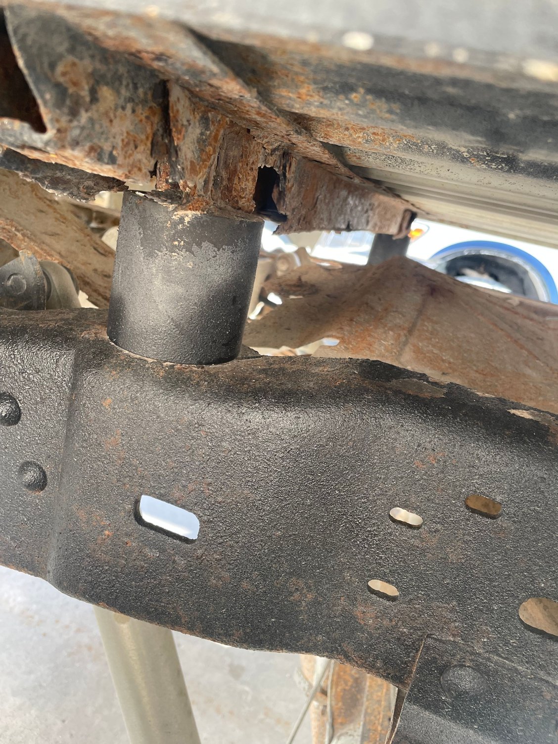

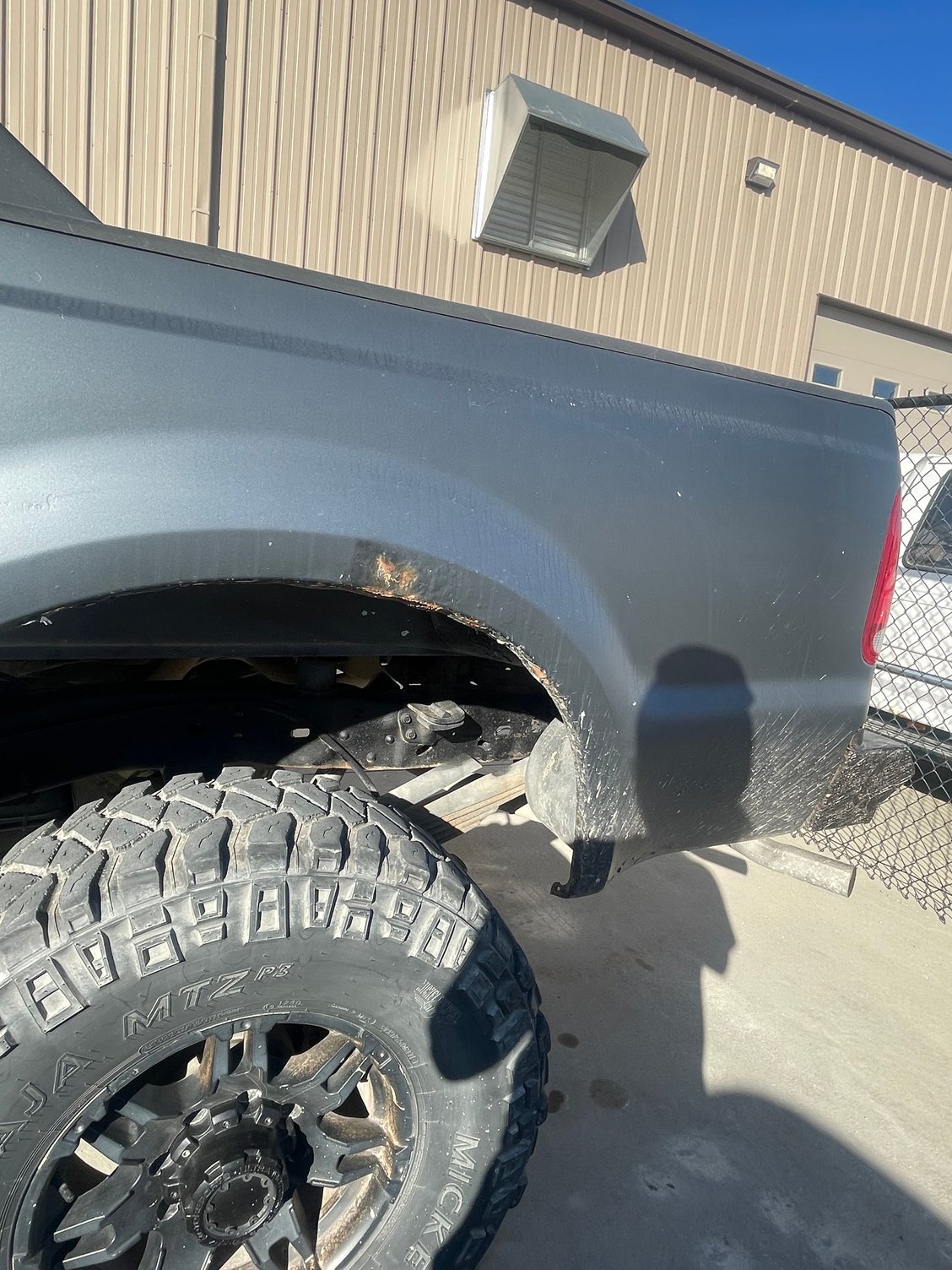

Hey y’all I got a question and I thought I’d try my luck here. I’m in a pinch and looking for a new vehicle this truck came across fb marketplace and it didn’t look to bad in the pictures. The cost is 7500 and it’s an 2001 f-250 with 151000 miles. I just like the look the price doesn’t seam bad I just need something to drive. Do y’all have anything saying I shouldn’t buy it?

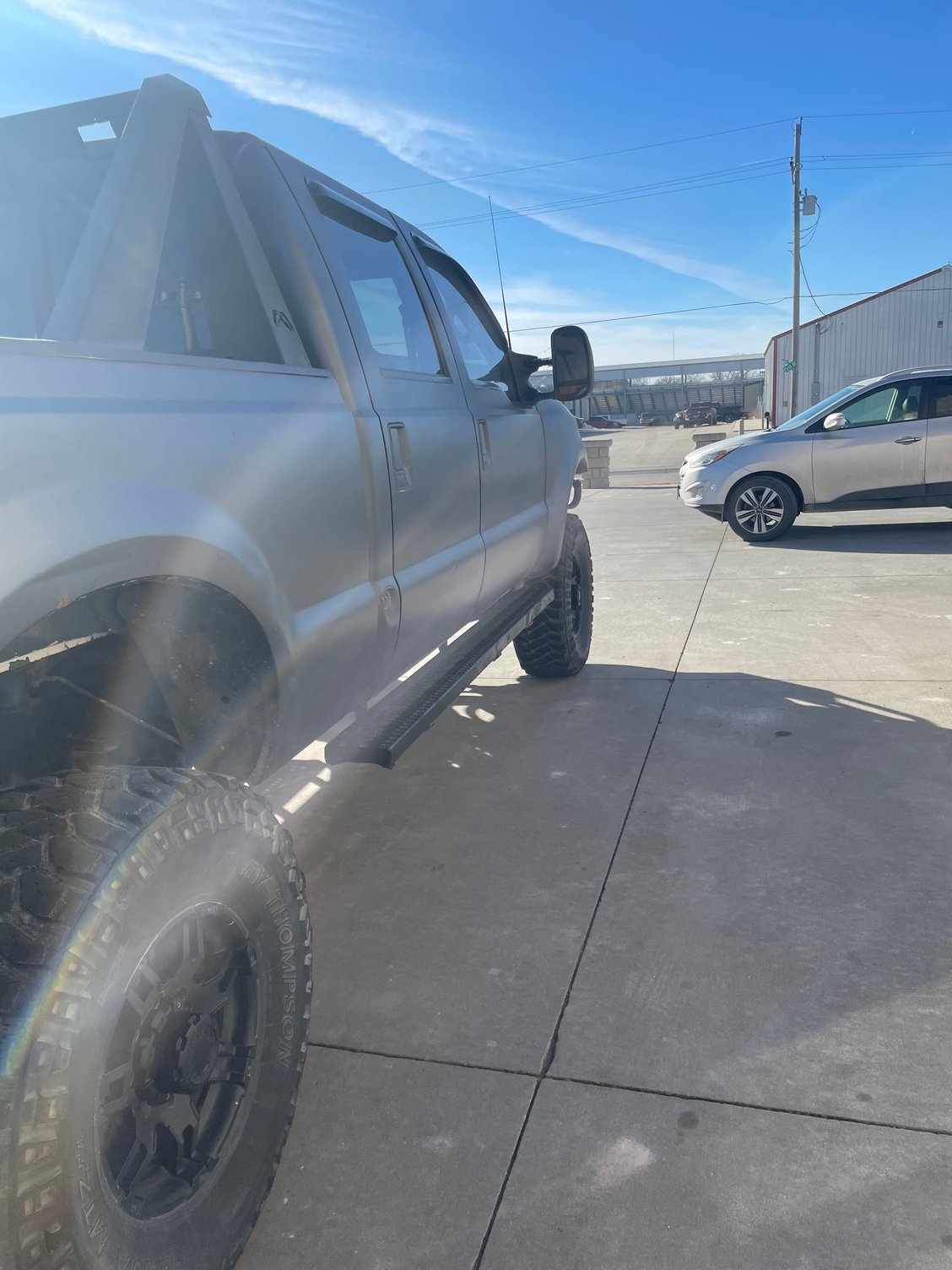

I don't have anything too useful to offer. You say you "need something to drive". I can think of a lot of other vehicles that would fit that bill quite nicely for the asking price, and be much better on fuel and practicality for that. I do find it very odd that some other previous owner would go to the expense of doing a body lift and suspension lift on a 2WD truck! Most concerning in the pictures would be the extent of rust on the underside of the pickup box. All of the other mods listed, lead me to believe this truck was ridden hard and put away wet. Is there any particular reason why you are eyeballing a 22 year old 3/4 ton pickup with extensive rust in the pickup box as "something to drive"?

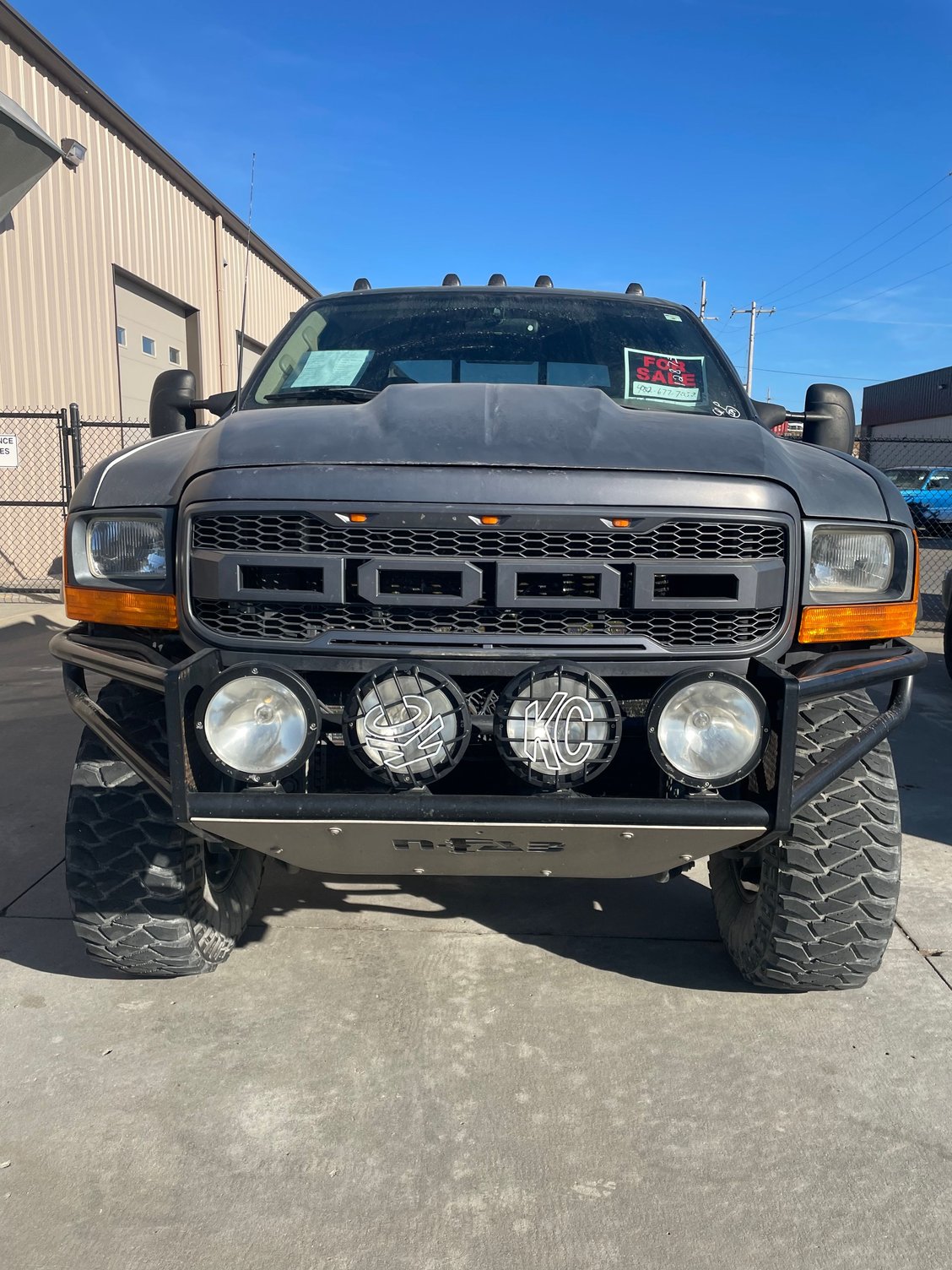

Anytime I see "Dip-it" paint jobs on something like this, especially with the bed being rotted the way it is, I assume the rest of the body is junk and their hiding something. Body lift on a rotted, or even heavily rusted, body is gonna tear it up. They lied about it having dual exhaust, it has a single exhaust with dual exit tailpipes, you can see the y pipe is still there. And I'm pretty sure that's an aftermarket, knock-off, Raptor style grill, not an actual Raptor grill. That 5.4, even with the tuner/upgrades is gonna be a complete slug in a lifted brick like that..you like 7MPG?

Just to be clear...is that 2x4s and hose clamps in place of a body mount? That sure looks like a lot of bad news! A good parts truck if you have a Super Duty already that you want to use the bumpers, wheels, interior and such on. Run, don't walk!
