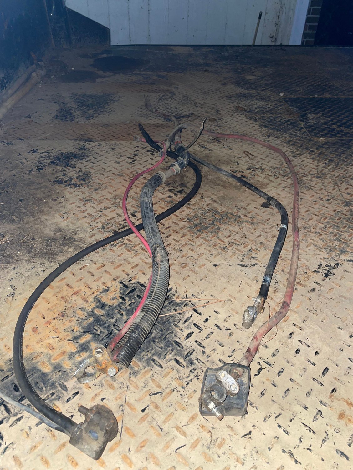

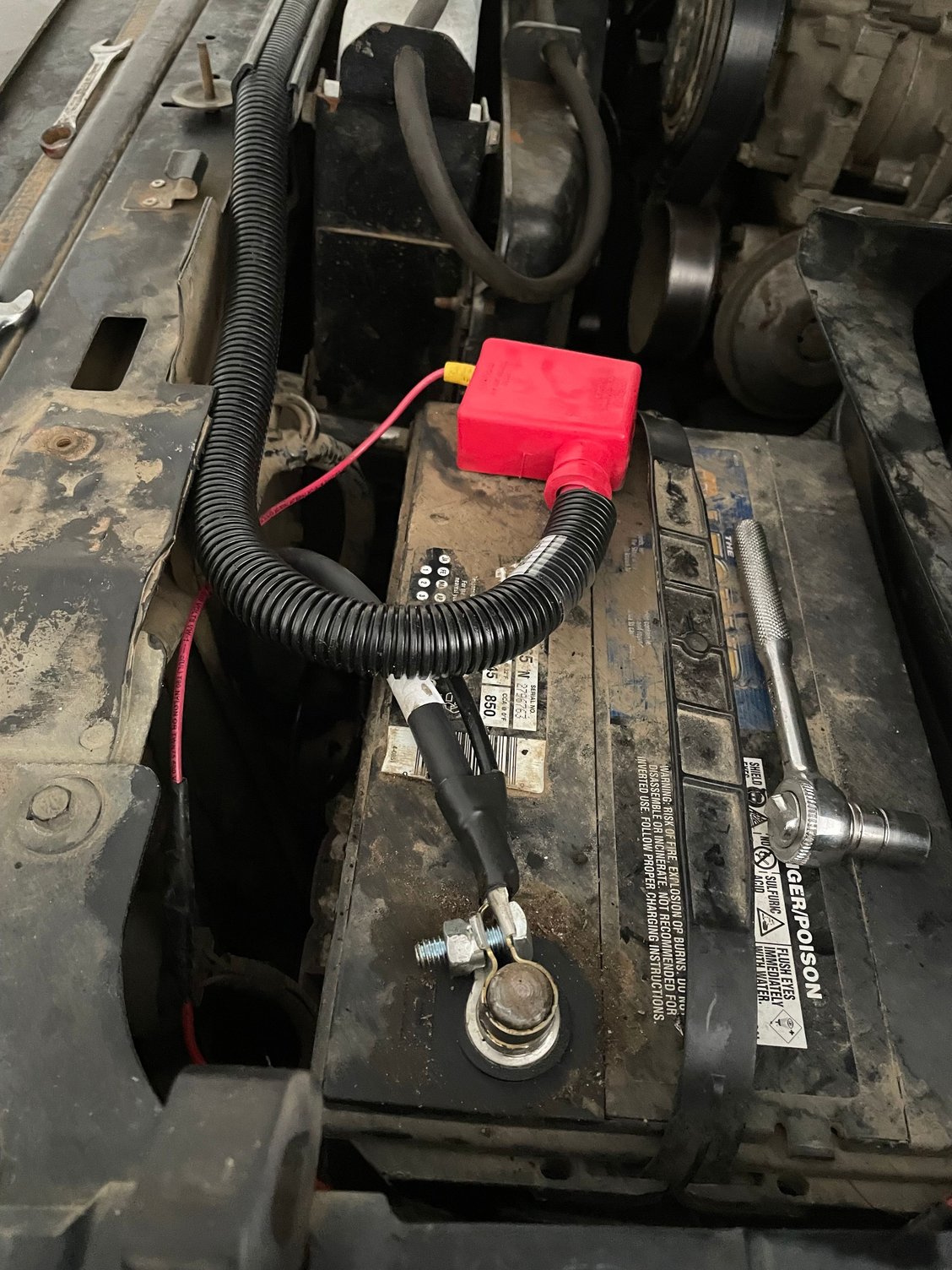

New battery cables, the old ones were pretty rough. I don’t know how many times I’ve been stuck with a vehicle that wouldn’t start because of some raggedy *** battery cables so, I decided I would head that problem off ahead of time.

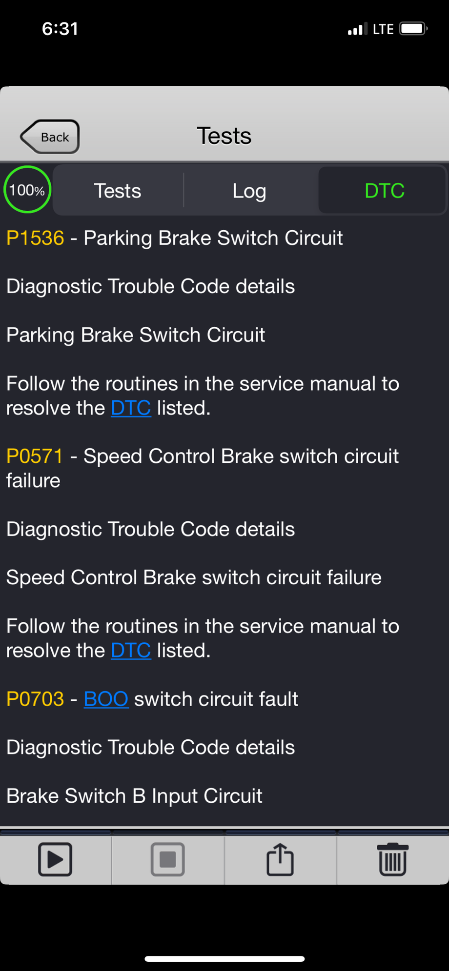

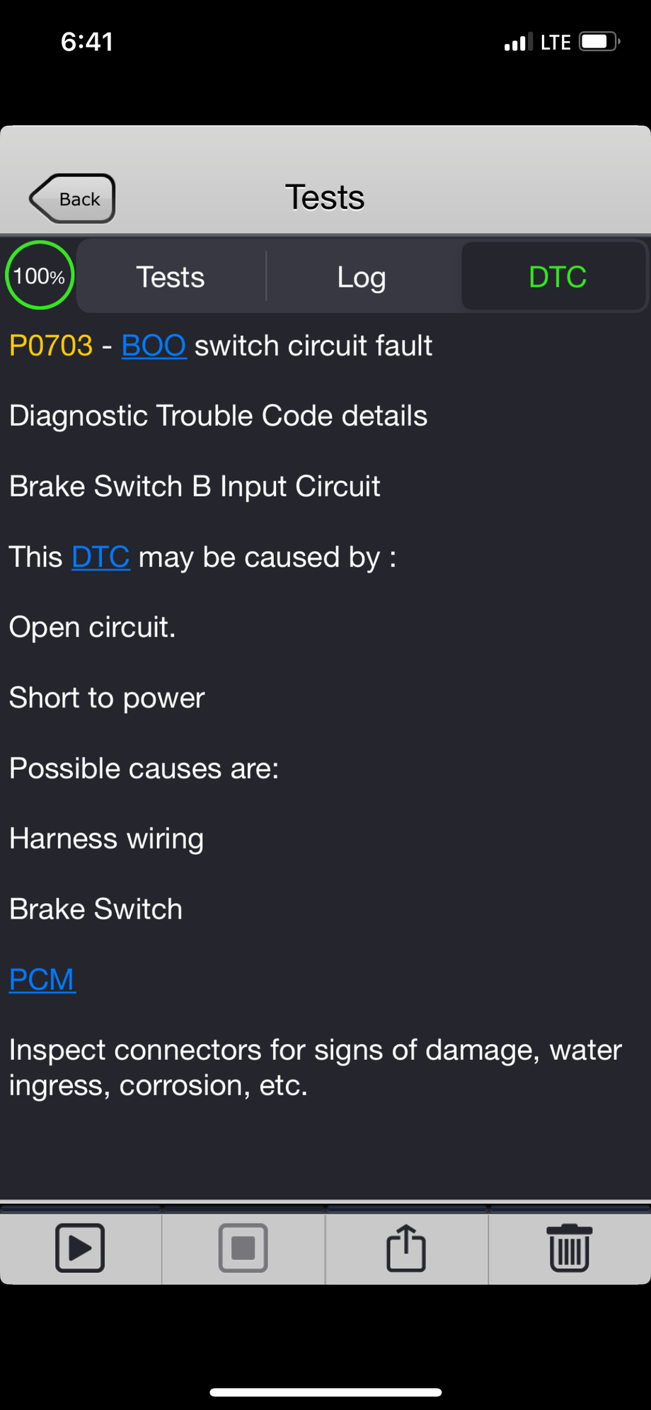

I also changed out the cruise control switch on the master cylinder,
that got me down from these three codes,
To just this one.
