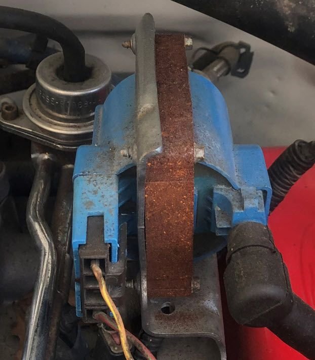

Ignition coil
Forgive my ignorance - but the state of my ignition coil appears to me to be in poor condition. I'm learning as I go here so looking for input from others. I've posted previously about a stalling issue I've been tracking down so as I inspect and test various components I've been looking for feedback from this group. Thanks for any input.

It is not stock. The rust doesn't mean much. You can run a few tests with a multimeter or replace it.

That looks like a Blue Streak or Standard Motors but a Motorcraft coil would probably last another 20+ years. My 95 has the factory coil in it still but it has lived a sodium free life. I have a FoMoCo coil behind the seat in case it ever decides to quit. 10 minute swap out and I'll be on my way.

Not that it is important but the bracket has been modified as well.

Coils sure do fail
Get a cheap spark tester from harbor freight
The TFI module and stator fail more often than the coils IMO
Do the resistance tests on the coil and AutoZone can check the module for you
Have a test light on the negative side of the coil along with the spark tester inline with the coil wire
Watch the test light blink as the vehicle runs
See if the blinking quits and then the engine quits or the engine quits and the blinking stays blinking (stator)
