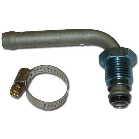

Yes. if you want, a new nitrile o ring that fits will work. If you go to the autopart store they should be able to lookup o ring for power steering pressure line. Im assuming its your pressure line. Both the return line and the pressure line seal to the gear with an o ring around the end
this is what the return line would look like, the pressure line would be similar. i would make sure your old o ring is not in the new box (such like it broke apart when putting it in) New o rings should be lubricated with the factory spec fluid (Type F) and rolled onto the end . new lines sometimes come with a plastic cone that you roll the o ring onto then roll it back onto the line. If you removed the line from the pump, you NEED a new teflon sealing washer

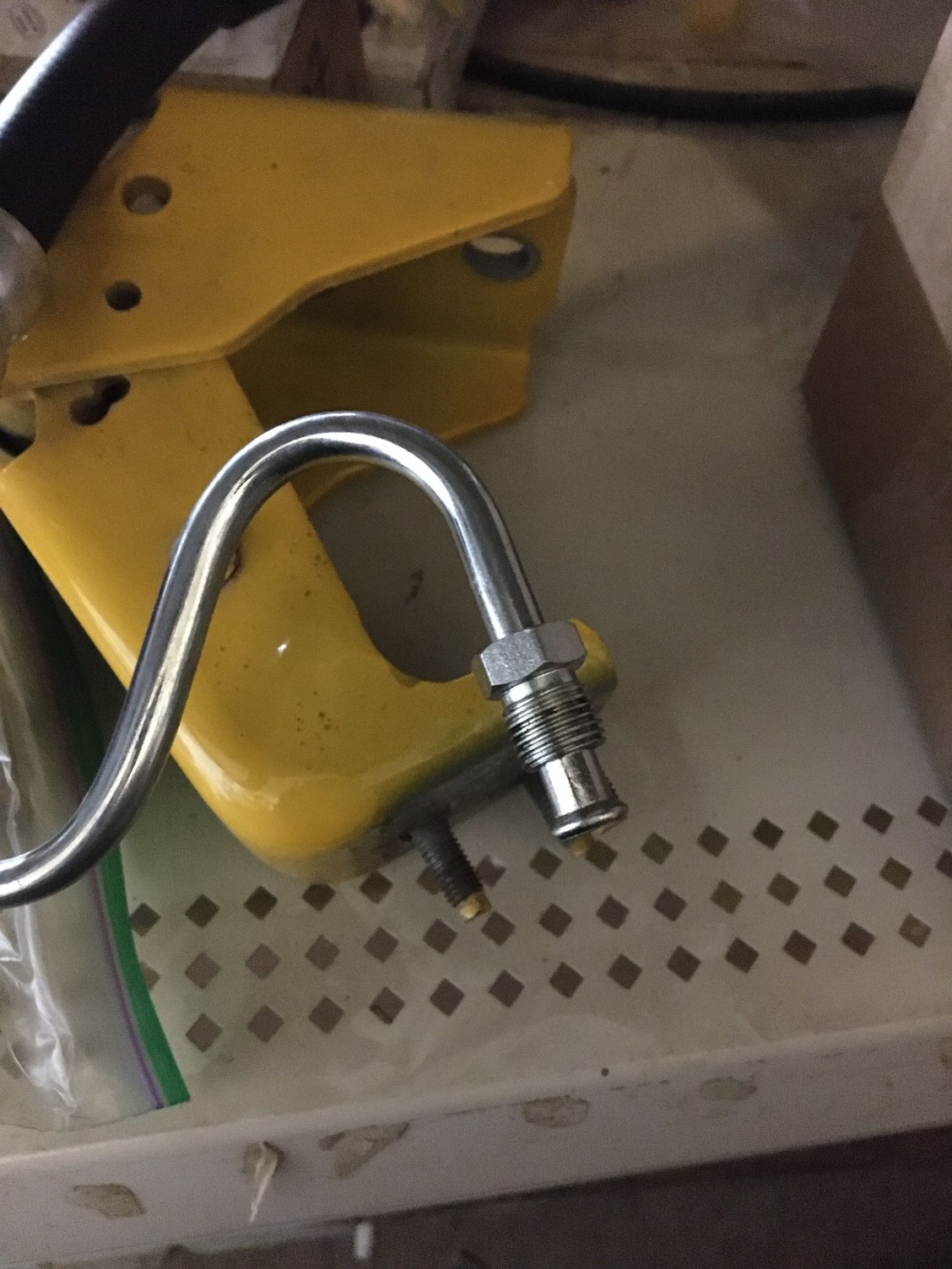

If that is a stock set up there is no o-ring. It is a flare fitting.
The inverted flare in the gear should be nice and clean, no marks in it. They can get worn out, corroded, and marked up.
If you wish for more help, post up a picture of what you are working on. If you can not post up pics, let us know.
These are worn out fittings in the same type of gear box you are working on (assuming stock). They may or may not seal properly. The fitting was tightened down too tight at some point.. probably trying to stop it from leaking.

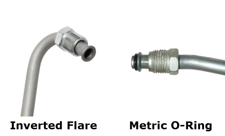

This is what the end of your line should look like. Assuming it is all stock.

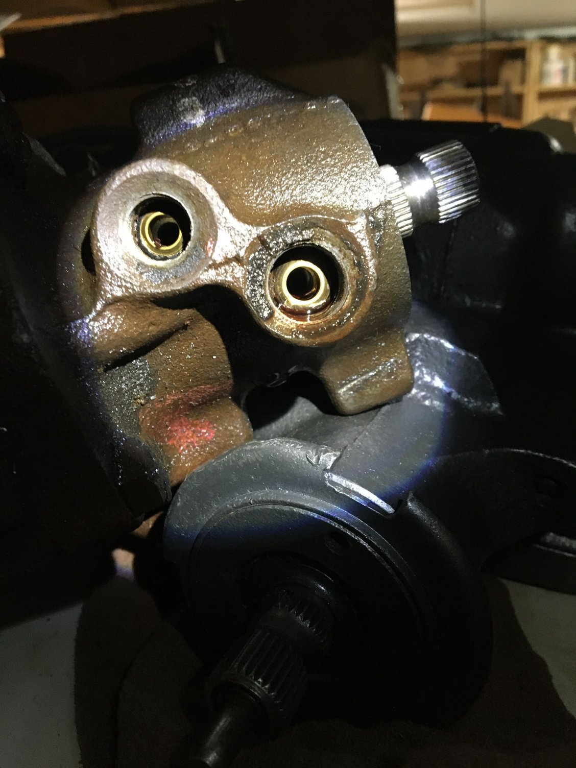

Thanks, okay so NO oring. I can post photos, but not of the line because it's already in there. I could probably snap one of the box though. Anyway I ordered the new line so I'm going to install that first and hope for the best. Really I'm just worried the new steering gear/box is the source of the problem. If it's the line, this should go away soon. Fingers crossed!

are you sure on the inverted flare thing? I feel like I remember having an o ring fitting on my 1996. Either way, OP,
just Identitfy which line you have, and on your box, identify if it looks like the picture jjf20 posted, if yours looks like his on the inside its inverted flare. I apologize if my info was wrong I could have swore ford boxes were metric o ring by these years. Now if your box is mismatched from your line, you would need an adapter but thats not hard to get
