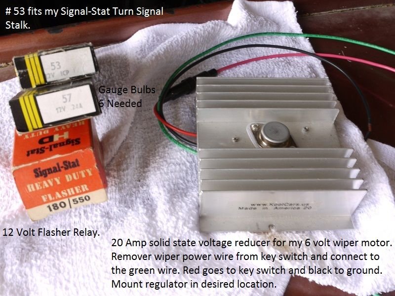

Dealing with a 1955,I think F100...Not mine. The owner attempted to install the rear glass,ruined the rubber but didn't break the glass. I got called in because I'm a so called expert but I can't get this thing in. The glass is original,cab undamaged,he got the rubber from LMC,don't know the brand. It appears the gasket is too big as I can pull either the top or the bottom easy enough but when going around, the rope gets extremely tight and it becomes a no go. The rope and rubber were lubed with dish soap. I guess the questions are what brand rubber is best and are there any tricks I need to know? The truck has been converted to 12v. It appears that the after market 12v wiper motor assembly is NLA at this time. The original 6v works good. I tried a couple 12-6v adapters but they are apparently for low amperage and didn't work at all. Does anyone know of a voltage reducer that will work? Will 12v be OK? Thanks!!

As for the wiper control, there are voltage stepdown units that are rated for higher amperage (you probably want something in the 10A range), but they cost more. Here are a few Amazon listings that may work:

The aluminum body voltage reducer on Amazon...It looks like the wiper assembly would have to be isolated from ground as the reducer has a separate ground circuit. Probably not going to be doable IMO. The gold reducer with the lead on each end doesn't work,just gets hot. The one Speedway sells claims to be 10 amp. Not true in our case.
I believe the grounds do not need to be isolated and the input is ground is internally connected to the output ground, and so you should be good to go.
The "gold reducer" is likely simply a big resistor that heats up. I find resistive reducers need to be tuned to the load and not necessarily the best all purpose voltage reducer type.
You think the ground on these is just a straight through deal? You are probably correct and we will order one and give it a shot.

IDK if these are still available but it's what I used when I did my 12 volt conversion back in 2017.
Dragging this back up...Any info on where you got this,manufacturer or part number would be appreciated. Thanks!
