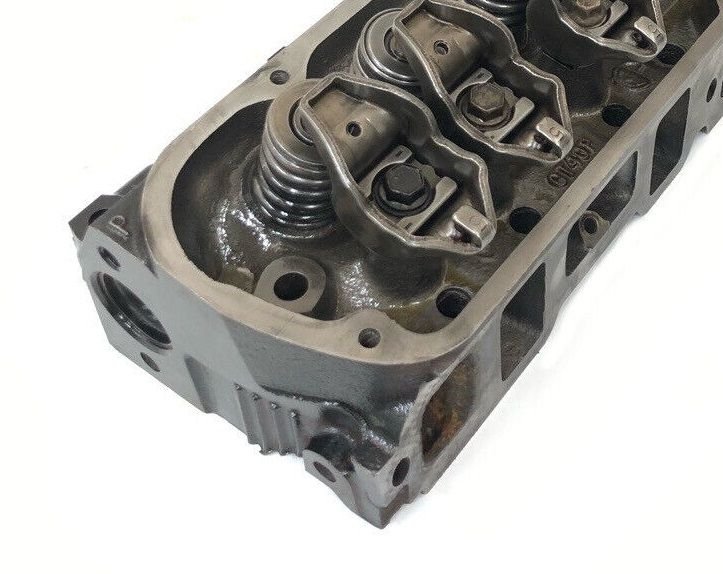

So turns out after a bit of research, my 1990 Aussie spec 5.8 has E6 heads, hence the longer thread on the plugs.

That would explain it.... although that is an unusual combo that wasn't used in north america. I was intending to ask what heads were on the motor as the only small block heads that require long reach plugs are the GT40p and E6SE/TE heads. Have you confirmed that you indeed have E6 heads? There is a capital letter S in the top outside corner of the E6 heads and the letter P on the GTP heads in that location, these heads also have 4 vertical bars on the end face which may not be visible on an assembled engine in a vehicle. GT40p heads would make more sense on a 351, the E6 heads are terribly restrictive although they do make for a very torquey motor, I may be the only other FTE member that has ever owned a 5.8 with E6 head mounted on it.

I think that E6 was intended to be a high swirl design and a lot of stuff was changed. I think that the valve lengths are different too.

Yeah I got all excited, I thought the PO had put on GT40 heads which were on some of our 90's models Falcons over here, I believe. But no, there's a definite "S" cast into the heads. I actually read some of your previous posts regarding your E6 heads and I guess I'm content with the fact they're a bit torquier and more fuel efficient.

Yes they had a very deep kidney bean shaped combustion chamber that produced fantastic swirl effect but badly shrowded both valves, so even when heavily ported as my copies were they still didn't flow as well as untouched E7TE castings.
