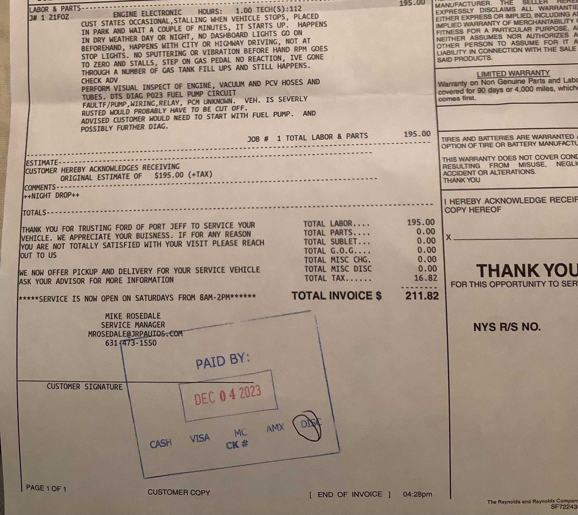

The service advisor said the only code given was P0231. The receipt says P023. There had been a 1000 code from earlier that had been removed. He “suggested” we might replace the fuel pump and sender unit, but it might not do any good and cost $2898. I don’t want to spend $3000 for something that might do nothing. A less expensive experiment would be to replace the relay, which also might do nothing.
This is the invoice

How sad is it that the dealer techs can’t fix anything unless a code tells them exactly what part to replace.
No logic, no troubleshooting, just scan and if the scanner can’t tell them exactly what to do,,,fire the parts cannon at it (at the customers expense of course) for maybes .

Consider taking it to an independent shop, with an experienced mechanic who you have direct conversational access to, without a service writer "interpreter."
Discuss with that mechanic the following course of action, in this order:
Fuel pressure test
Fuel pressure regulator
Fuel pump relay test
Injector wiring examination, looking for frayed wires, potential shorts, or intermittent connections at each cylinder, 10 times.
Fuel pump test
Note that the fuel pump is dead last on this list, in contrast to being first on the dealership list. Not sure if the $3,000 service ticket has anything to do with that, but the 44 gallon gas tank must come down in order to change the fuel pump, which is immersed in the gas to keep it cool as it operates, and to reduce suction line opportunities to emit evaporative emissions. In addition to the expense of the fuel pump, there is a lot of labor in dropping the tank, and remounting it securely again if frame corrosion is severe.
At minimum, and first thing,. a fuel pressure test should be performed. The results of that test will help rule in or rule out the fuel pressure regulator being a culprit.
Then attention should be turned to the fuel pump relay, even bypassing the relay to verify that the fuel pump works, even if the fuel pump relay is failing.
