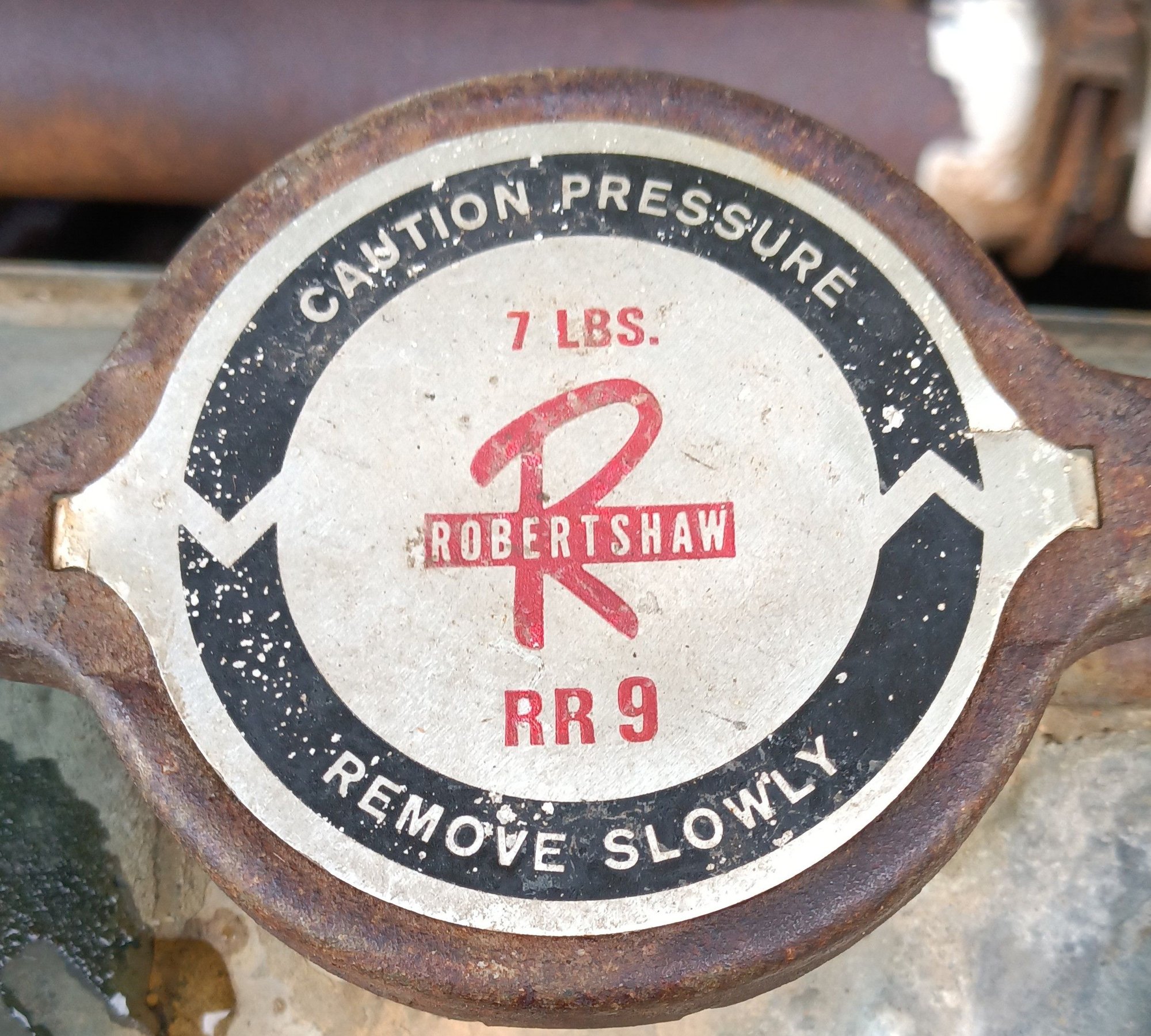

If it means anything, my 64 with the 292 has a 7lbs RobertShaw cap.
Works great. Was on the truck when I got it

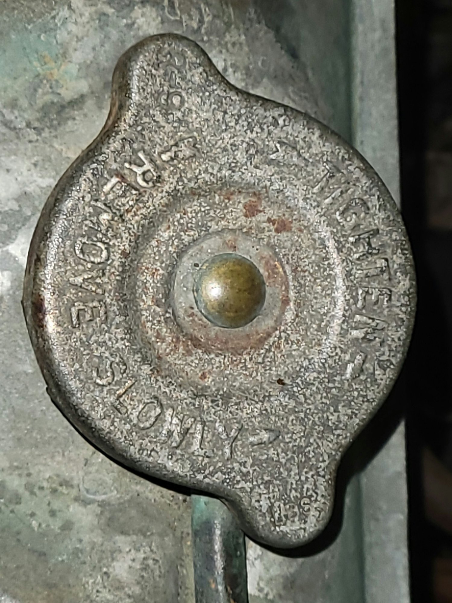

This is my untouched 1962 F250 with factory industrial 262 and Clark5 speed with overdrive. Original radiator and cap
I hope this helps. The truck is 1 of 1 with that engine and transmission ( SEE the full post under "F250 with 262 6 cylinder", think that is the title, well its close enough to find it).

I appreciate the cap photos. It does look 60 years old. Is there anything stamped in the center area that didn't come out in the photo, like Autolite, S.M.Co., etc.?
What is the item mounted to the firewall behind the valve cover? It looks like an ignition module.

Here is what I found, 7 lbs, on the other ear. There is a faint Autolite stamped, not embossed twice on the inner round area. I could not get a good photo showing. Raised Autolite is a later release of the same cap. You want embossed to be exact correct. Hope that helps
