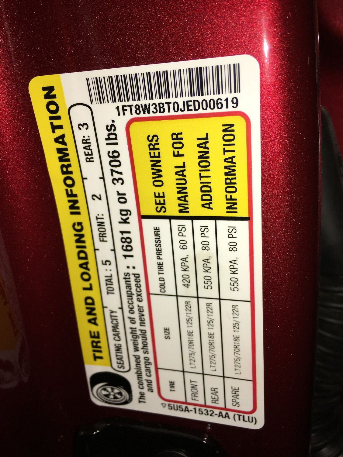

There are many F-250's on the road that are over their manufacturer payload. I'm not saying they don't pull the trailer just fine. You never know what trailer you might trade for in the future, even though a toyhauler might have a lighter pin weight for now. With a SRW F-350 you get more payload and have less chance of legal troubles if you ever have an incident. Even though you can get an F-250 with the Dana M275 and the trucks are technically almost identical. In my case the only difference between my 2018 F-350 SRW and an F-250 with high capacity trailer towing would be the blocks on the rear springs are taller (as far as I know anyway). Since you are looking at used, here is my 2018 F-350SRW CC 6.7 for reference. My camper is lighter although I do some heavy gooseneck towing. I have never been sorry to have a little more capacity than needed.

with a fifth wheel payload will be your limiting factor not gross weight. 350 is the safest and best option. The yellow sticker on the driver's door is what you need most as every truck is different depending on options. No brochure will give you accurate payload.
What he said. Door jam sticker. My 350 has 4100 payload. Some have 4500. A 250 will be about 1000 less for payload, on average.
