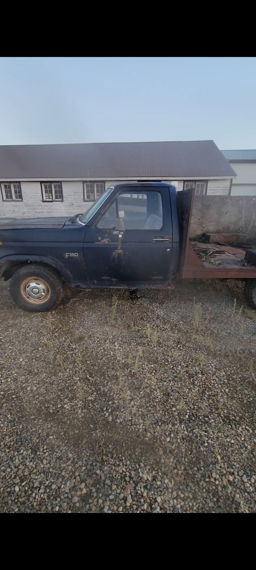

Got a 1983 f150 with a 300 straight 6 that has a carburetor. The problem I am having is there is no spark. Is there a way to get rid of the ignition module and convert it to strictly a distributer and coil only?
