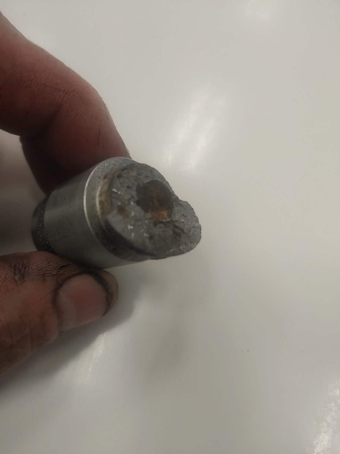

it broke way below the block.the part with the oring. Nothing to grab. The tappet broke off too. Anyone have experience getting it out? the piece that broke off is moving when i crank engine. im.thinking drill hole in aluminum with some sheet metal screws amd vise grips?

your plan should work, drill while its up and use Vaseline or grease to contain chips, i have used a vacuum cleaner when drilling too
new pump comes with a tappet

i have another pump but no tappet. engine is in a 97 van. i want to use for a dusted superduty but before i want to get it running and do compression test.
It must be a miracle but the thing actually ran for about a minute. it been sitting ten years in a muddy field. i dont know how it ran because pump is dead and the tappet is corroded seized in the casting.
