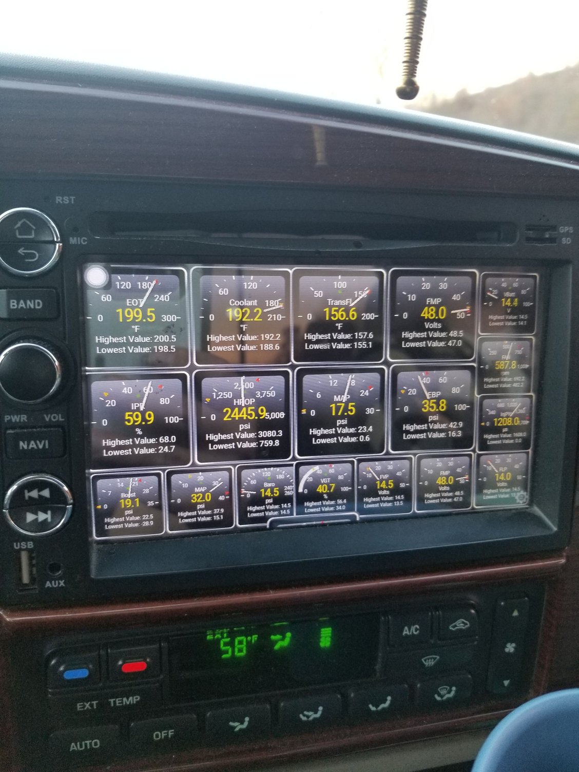

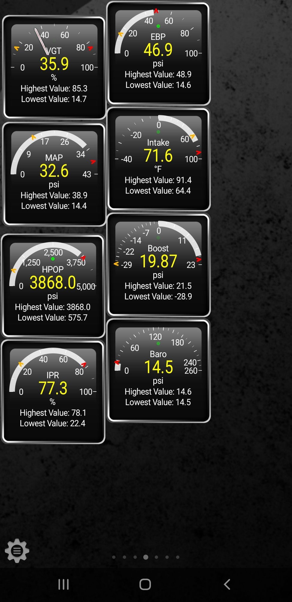

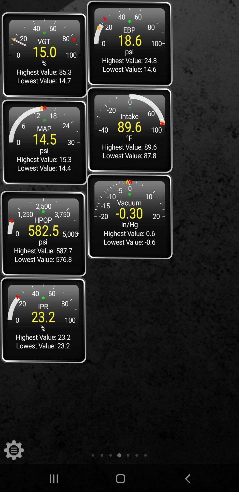

Took the truck out to get some numbers under warm flat conditions before I get in depth on the wiring. Hopefully it can help you all help me.
This is at warm idle.
These 2 are pretty close to pedal to the floor
This is 60 mph level ground

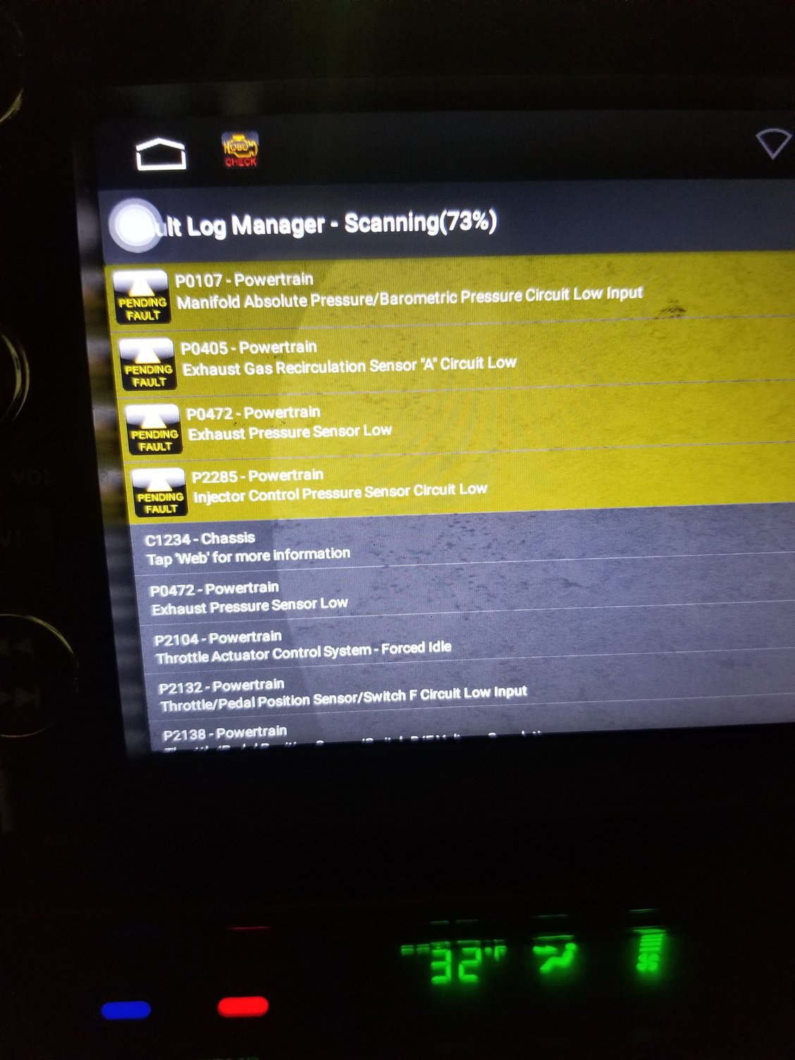

Forgot to add that I found a code with FORScan after I returned home. No cel.
