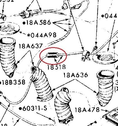

Some other places to check - Ford didn't do too good of a job sealing up the cabs especially in the area of the firewall right behind the engine. The choke and speedometer cables come through those holes that are about 5 times too big for the purpose. Originally the cables had a foam sleeve on them that slides up and down the length of the cable. It's supposed to go in that hole in the firewall so once they got the cable situated and connected then they'd slide the foam sleeve as needed to fill the hole.
Here's an example speedometer cable. The longer foam piece is actually there to cushion the casing where it passes under the floorboard (on the passengers side in this case as it's an MX-COM cable) and then the shorter piece to the left is the one that slides to fill the hole in the firewall where the cable goes through.
The choke cable would have had a similar foam sleeve as shown circled in red in the drawing below.
And you may have one but if the seal just in front of the parallel slots under the hood - the Cowl Seal - if it's not there or is cracked badly then installing a new one can help with smells going under the back edge of the hood and into the cowl vents. Also making sure the back edge of the hood is in contact with that seal would be a good check.
