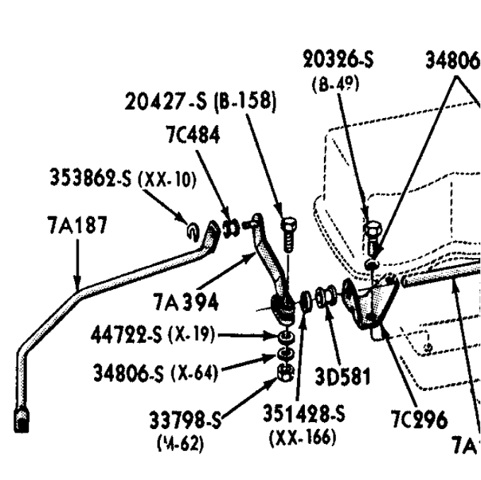

Base part number 7A394 is called the Downshift Control Lever. Sounds like you also need clip 353862-S and if both of those are missing then surely base number 7C484 bushing is also missing I'd guess. I've included pictures of the clip and bushing below for reference. Let me know if that 7A394 is what you need, and I'll tell you more.

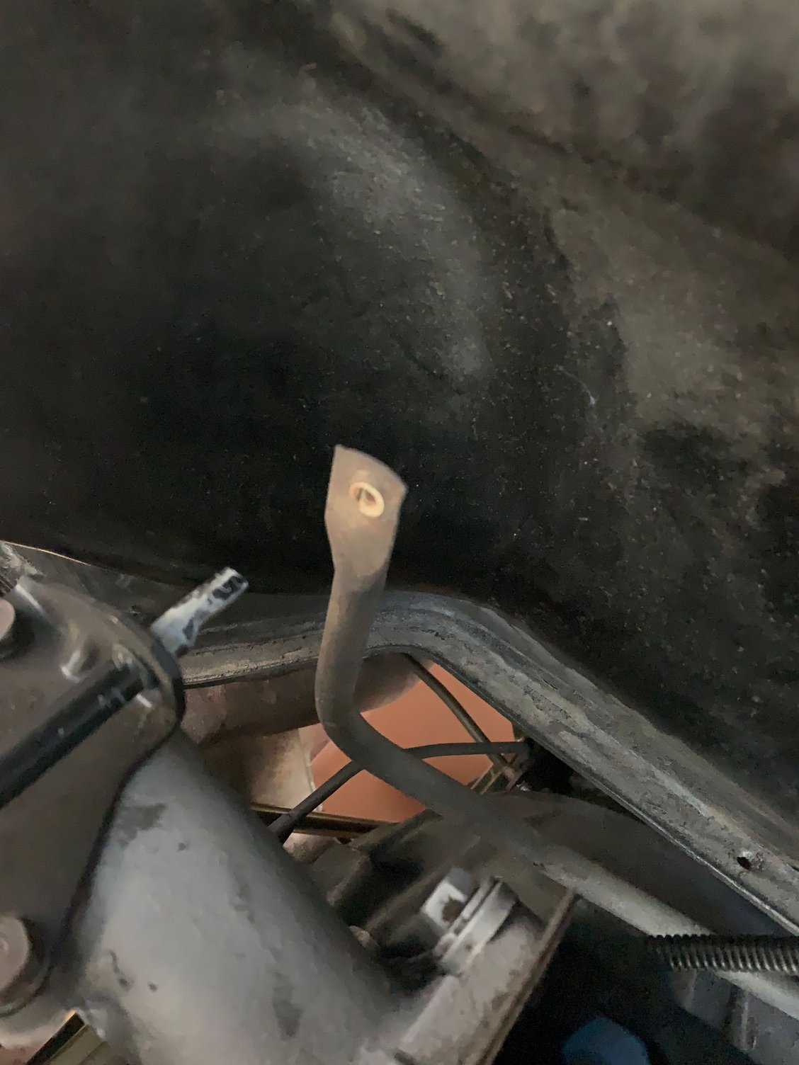

Thanks, yes I believe those are exactly the parts I need. I took a picture of what is left now, to help show what exactly is missing:

Looks like you do have the off-white bushing still intact in the upper end of the kickdown rod so that's good as long as it looks OK.
