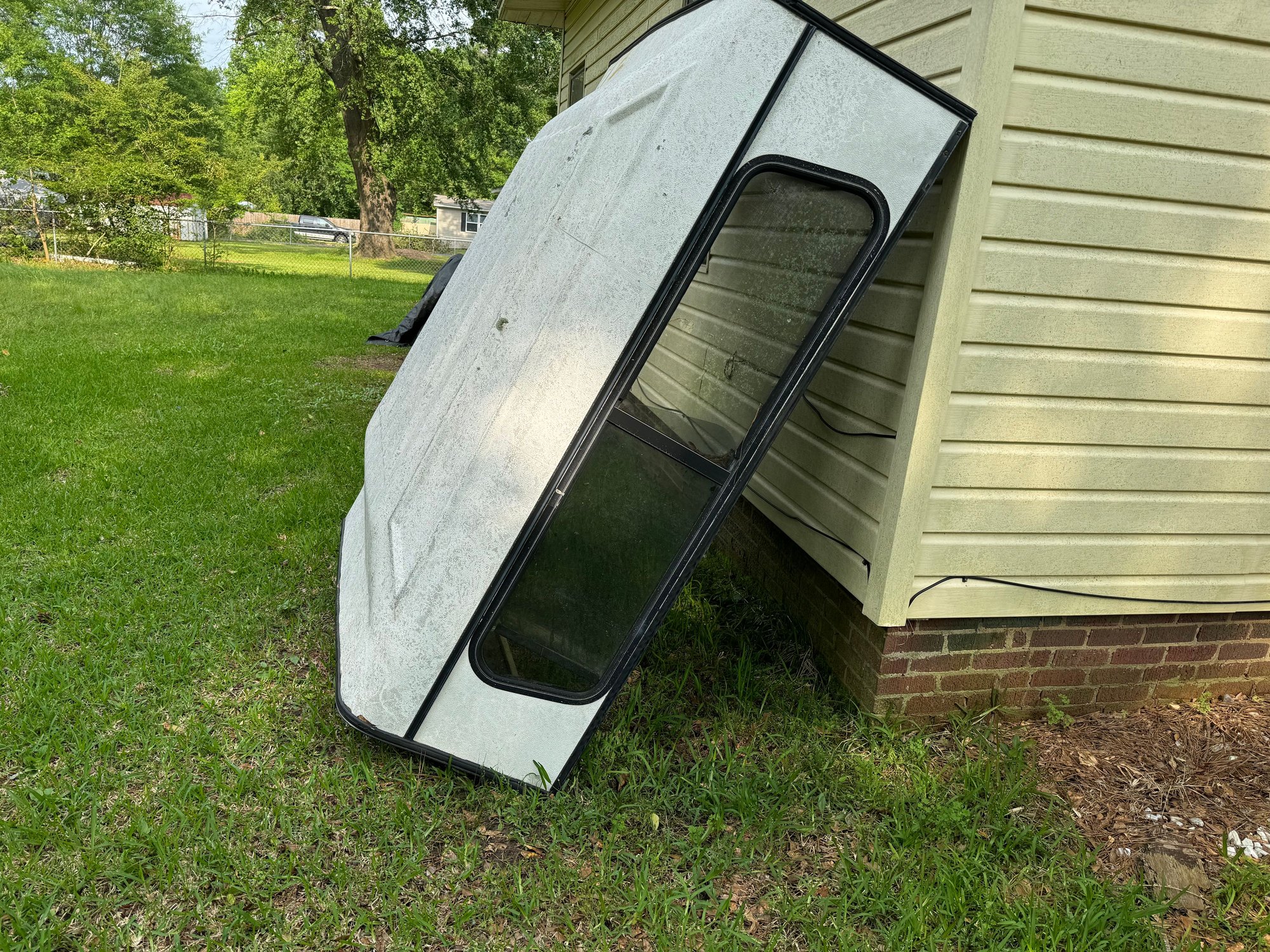

How do these toppers typically attach to the bed? Are they bolted on or do you use clamps? I picked up what I think is the same topper but for a short bed a while back and I need to throw it on the truck before I move for work and have to leave it for a while

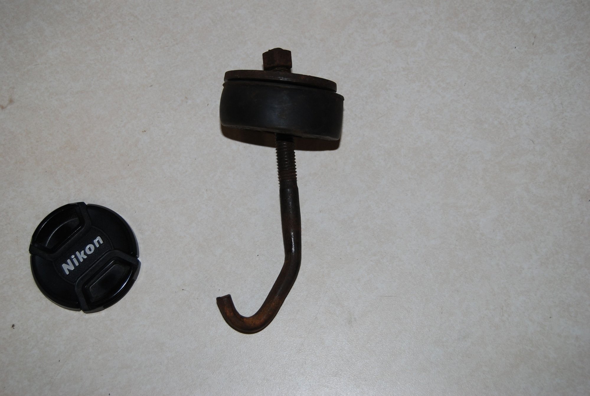

Here's a J hook that came with the Ford canopies. They hooked into one of the holes down in the stake pocket.

I've gotten two of those factory hooks. Impossible to find new and used. That's why I went with the aftermarket ones.
That's kind of what I was getting at, what would have been used from a dealer or whatever. I'll probably end up using a j hook/clamp similar to what SlikWillie posted as they seem to be ubiquitous
I also just searched for some J hooks similar to those in the pic and you can buy a generic j hook like that but I'm not sure the geometry would work
Thanks
I had all four holding mine on.

To get the hooks from Amazon to fit, I had to trim the hook part on the sides. Otherwise, they are too wide to fit. Easy to trim with a hacksaw.

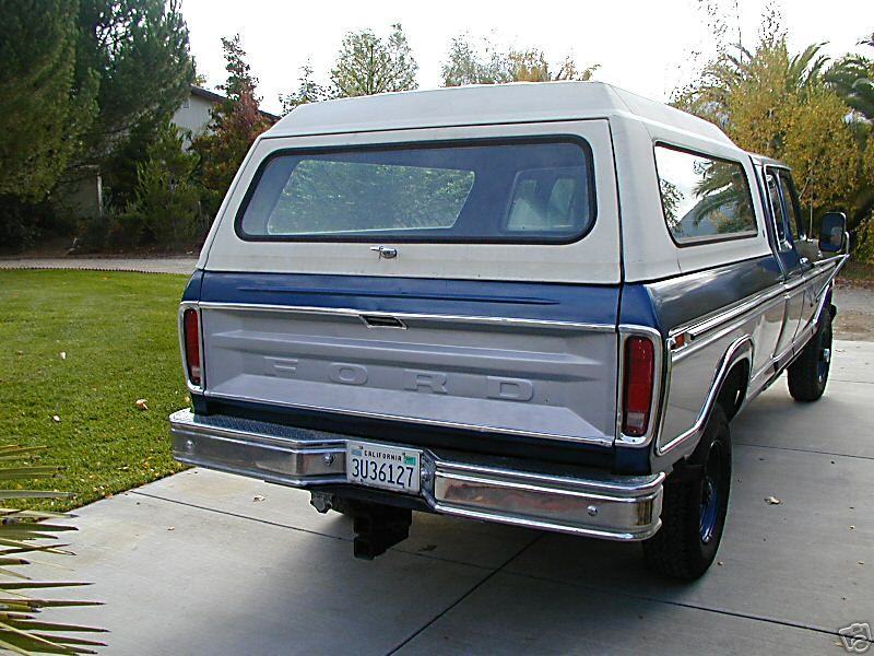

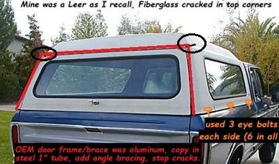

Been times I wish I had kept mine, it was sanded, etc ....and painted in 1989 with the truck, was after I had fixed the two cracks and replaced the aluminum door frame with steel.
It normally used 3 clamps each side, I used three 3/8" eye bolts to give me tie points too.
Nice looking truck below, is not mine, but I used it only to illustrate.

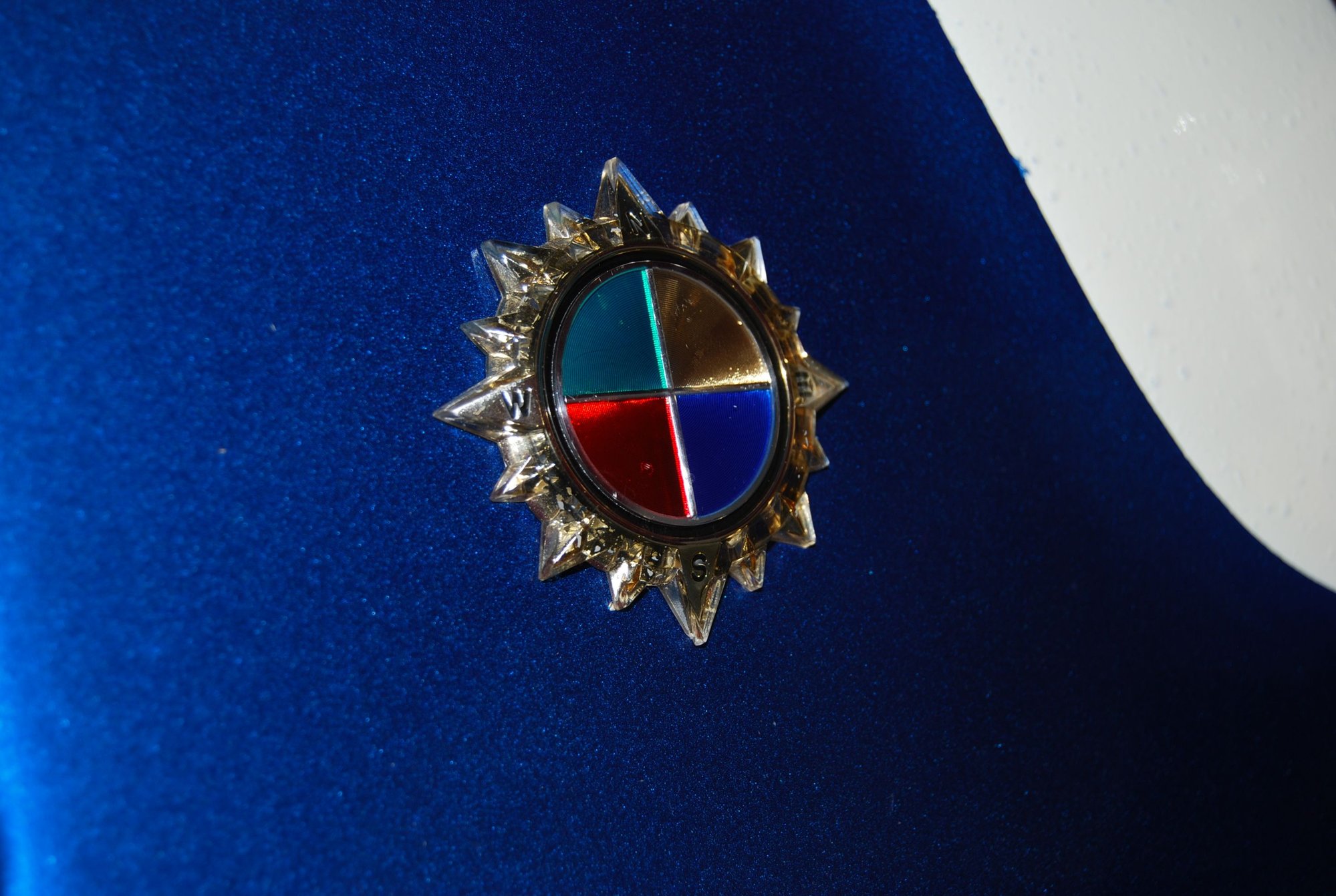

Not all toppers came with that trim piece between the two pieces of side glass. Some had one long piece of glass. Although that maybe harder to find than the plastic strip, which you could use any H strip that holds thin paneling together at the joints. FRP paneling comes to mind.
The yellow color in the compass emblem is the gold plate color on the back side of the clear plastic.
