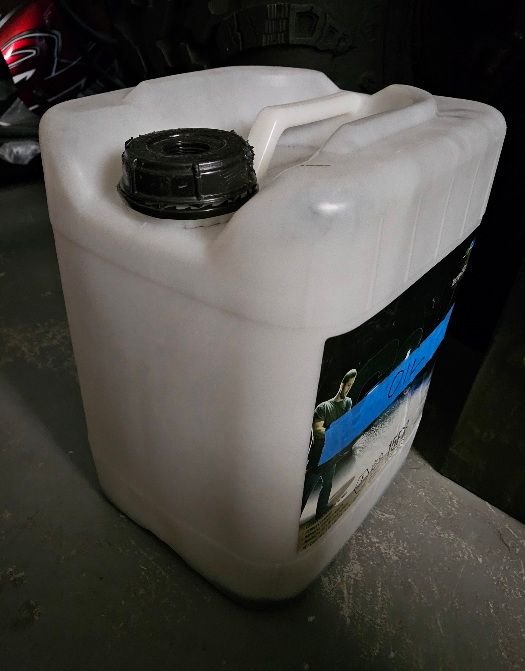

That small amount that they lowered the 2020+ must be just enough to interfere with using a 5g bucket. Since switching to the Fumoto valve I now just run a tube into this 5g jug and only use the 5g bucket for the oil filter. Prior to that I used the 5 for both. Some blocks would do it for you.
