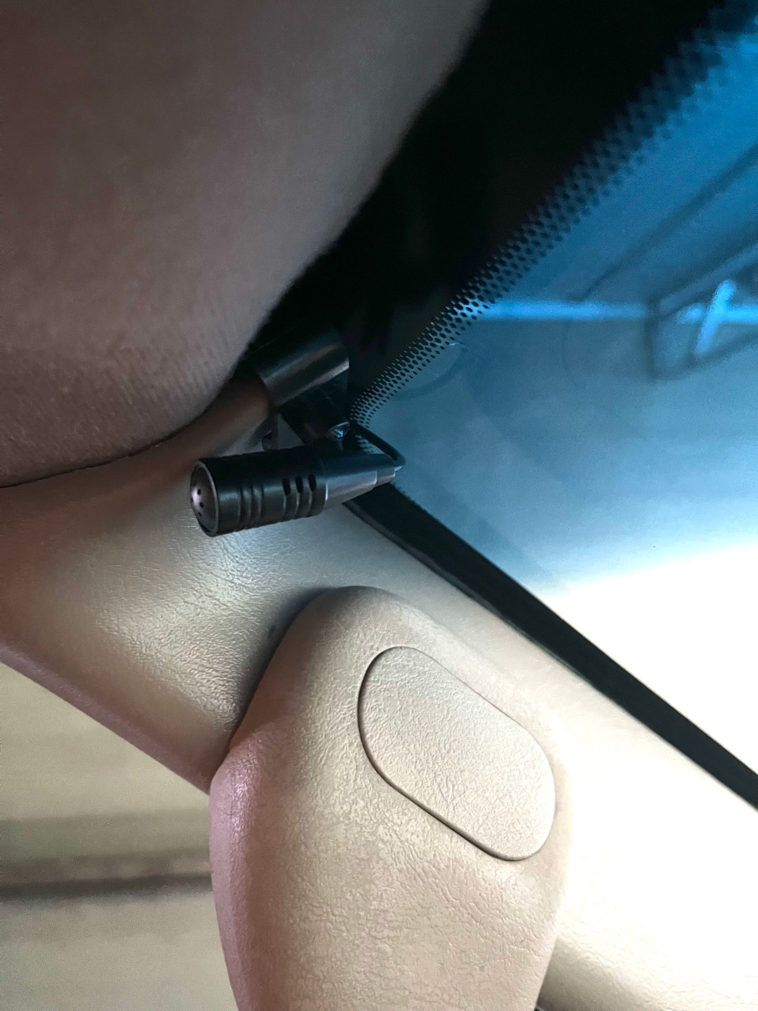

Not Atoto, but this is how I mounted my microphone clipped to the top of the A-pillar trim. Edited to swap out a better picture.
Thanks man. Does it work well there?
Mark
It does, with the visors either up or down.
