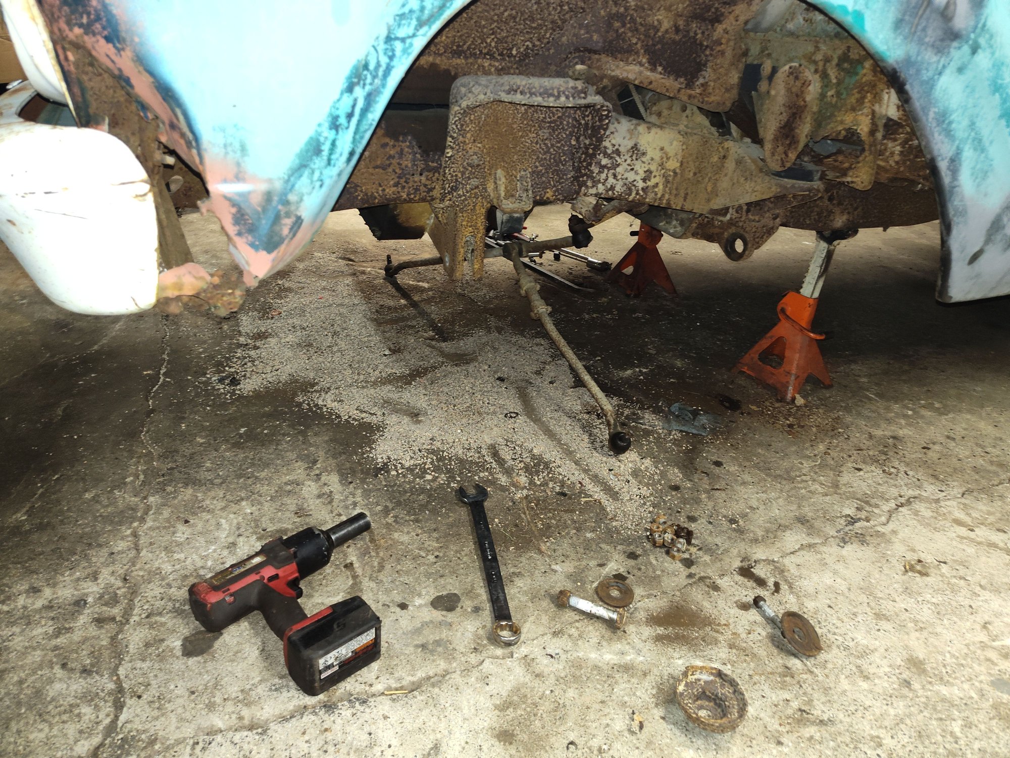

Disk brakes, ps box, 3.54 gear d60 rear from frame brackets in all harvested from the 77 parts rig.

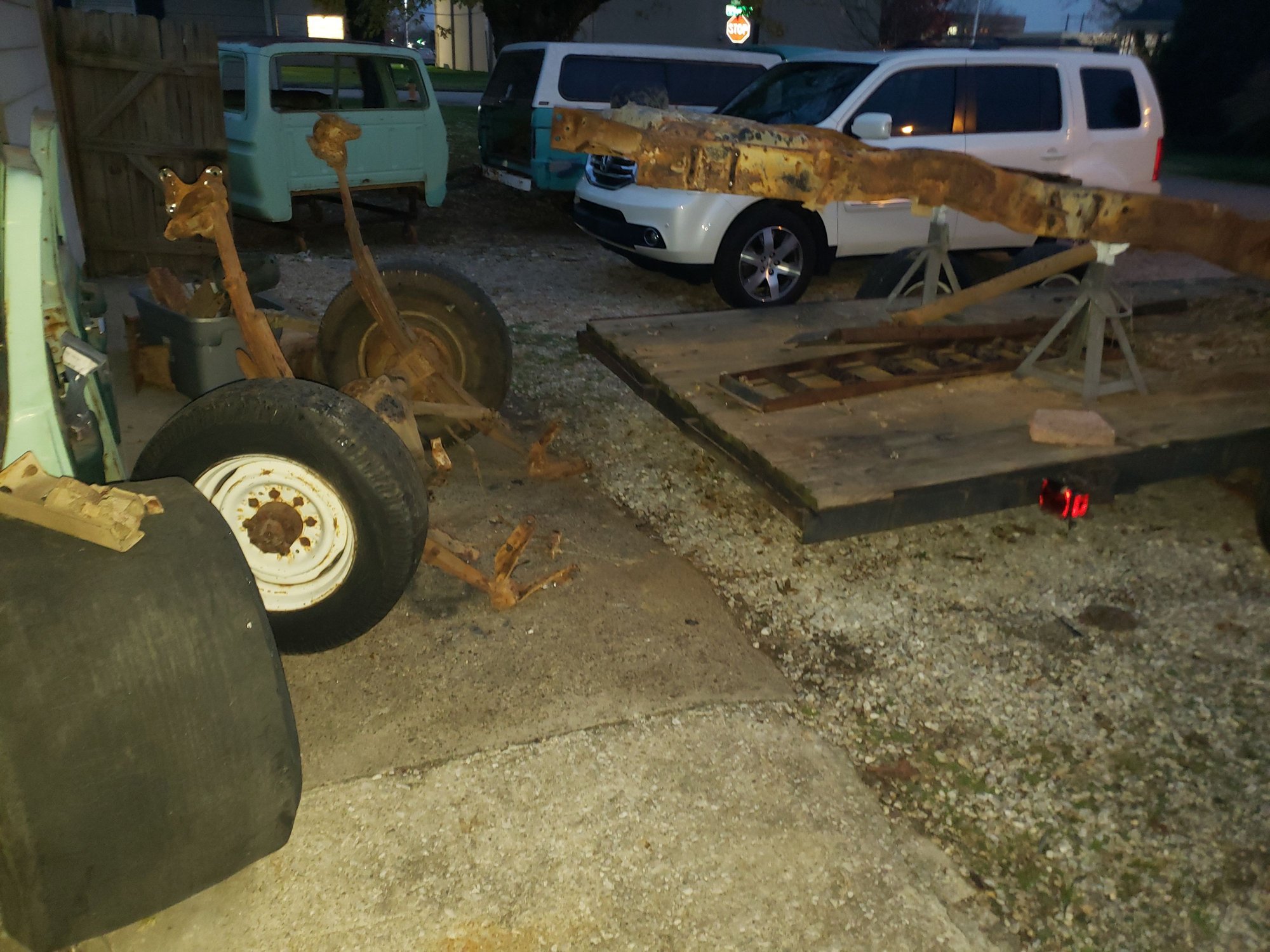

Out with the old. The new is ready to go!!
I found ps bracket,pullies etc for this project. I'm trying to just get the beams in for now tho. We will see. I would love to concentrate on this for a bit but I have a lot of other things to do.
