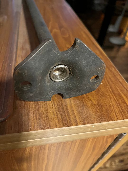

Has anyone got any experience adding power steering on one of there? I have the 77 steering box and a ps pump assy. I know I will have to shorten the column. Any tips or tricks?

How to Install Power Steering in a 2WD F100/250/350 - FORDification.com
Plenty of canned information on it. Hardly worthwhile to cover the same information when it's readily available but do ask follow-up questions if you have any after reading this. Shortening a steering column is OK but cutting it in the middle and welding halves together should be avoided since welds can and do break if there is not excellent penetration and even then, if it were to break any way you would suddenly be without steering at all. Not pleasant.
Thanks, I had not found that somehow.
I had envisioned just removing the lower flange,shortening the shaft and column cover and reattaching the flange. I think it's a worthwhile endeavor to do this as my wife and 16 year old daughter both want to drive the old dude. Thanks!

Originally Posted by fordman67
I had envisioned just removing the lower flange,shortening the shaft and column cover and reattaching the flange. Thanks!
In essence, that's what you will do, but "removing...flange" is easier said than done, it is welded on. If you have a lathe, or access to one, you can drill that weld out from the end working up in size to 3/4" IIRC. You might be able to do the same with a hand drill, or setup in a drill press. Once loose, you can shorten as needed and simply weld it back on same as factory. Welding this on is much easier than trying to weld shaft back together. Not to mention a lot more forgiving weld for a "non-professional welder". This is how I did it. Remember, measure twice(at least), cut / weld once. I left mine about 3/32" long and i wish I could go back and fix it.
Power steering and power brakes is such a beneficial and easy upgrade on these trucks, it's worth doing in my opinion.

Sounds like a good approach. I have 3 sitting here - the picture is of an NOS one and I don't see any weld on the flange on any of these. It is splined. Was yours @PROSTOCK and if so, how did you deal with that?
Outstanding I have a lathe and at work a full machine shop.
My wife and daughter want to drive this so ps and PB are some safety items I think are needed. Hopefully in the next few weeks I'll get the engine out of this.
Well it was 30 years ago and those brain cells are long gone, lol. However, had it been splined, I could have dealt with that by re-splining and pressing back together. I had all the available equipment to do so, no sweat Nonetheless, welding has worked well for the last...well, 30 years. The difficulty is getting the last .001" out of the length of the column while leaving enough for the lower bearing and shift tube (automatic). I don't suppose there is a different p/n for the 3 on tree vs. 4spd vs. COM steering shaft? Your pic shows very well how one could weld that flange back on after shortening the shaft. Too many years and beers ago.
