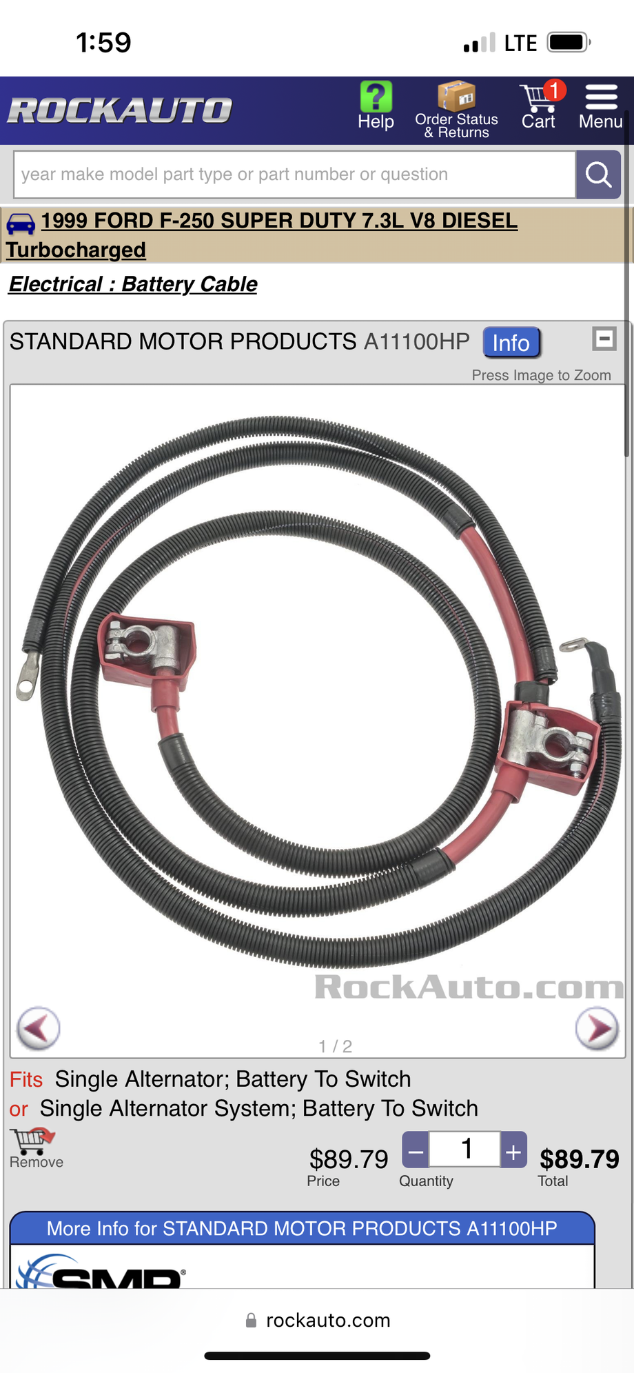

So to close the books on this tread I ended up finding this on rock auto. The description wasn’t great but the picture looked right haha. For just over $100 shipped I figured why not.
Fitment is great on my E99. Huge 2/0 cables between the two batteries and then down to the starter. 90* end for the stock style starter too.
Truck spins over much better now I don’t think my old cables would have lasted the winter—yikes!
