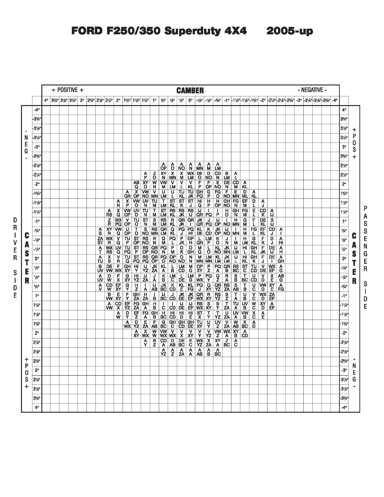

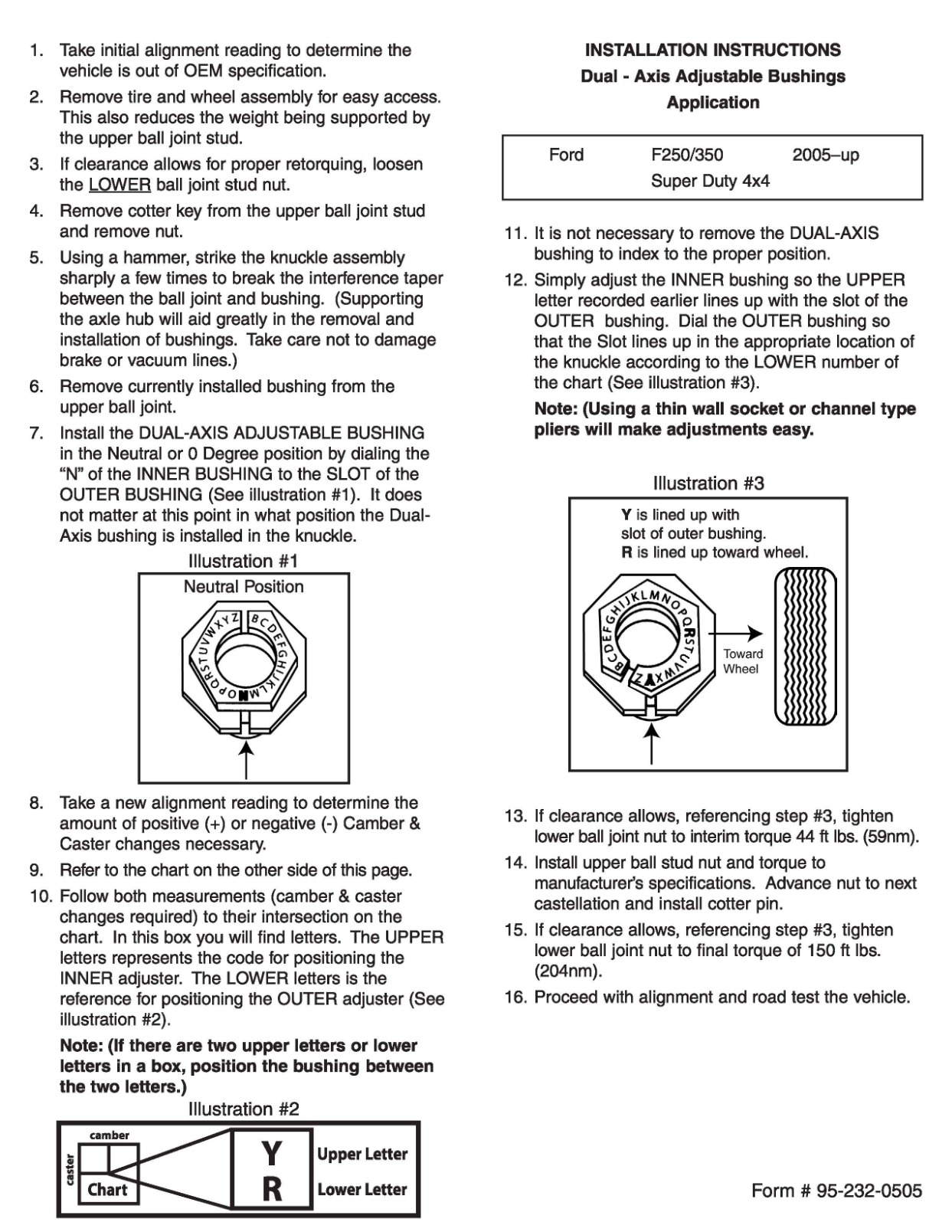

Additional Edit: Located the following bushing, which allows both caster and camber adjustment. Much better alternative, IMO:
Amazon Amazon
Instruction sheet (posted from one of the reviewers at Amazon):
As can be seen from the chart in the second image, it appears that the adjustment range is still ~+-2.5 degrees, however.
