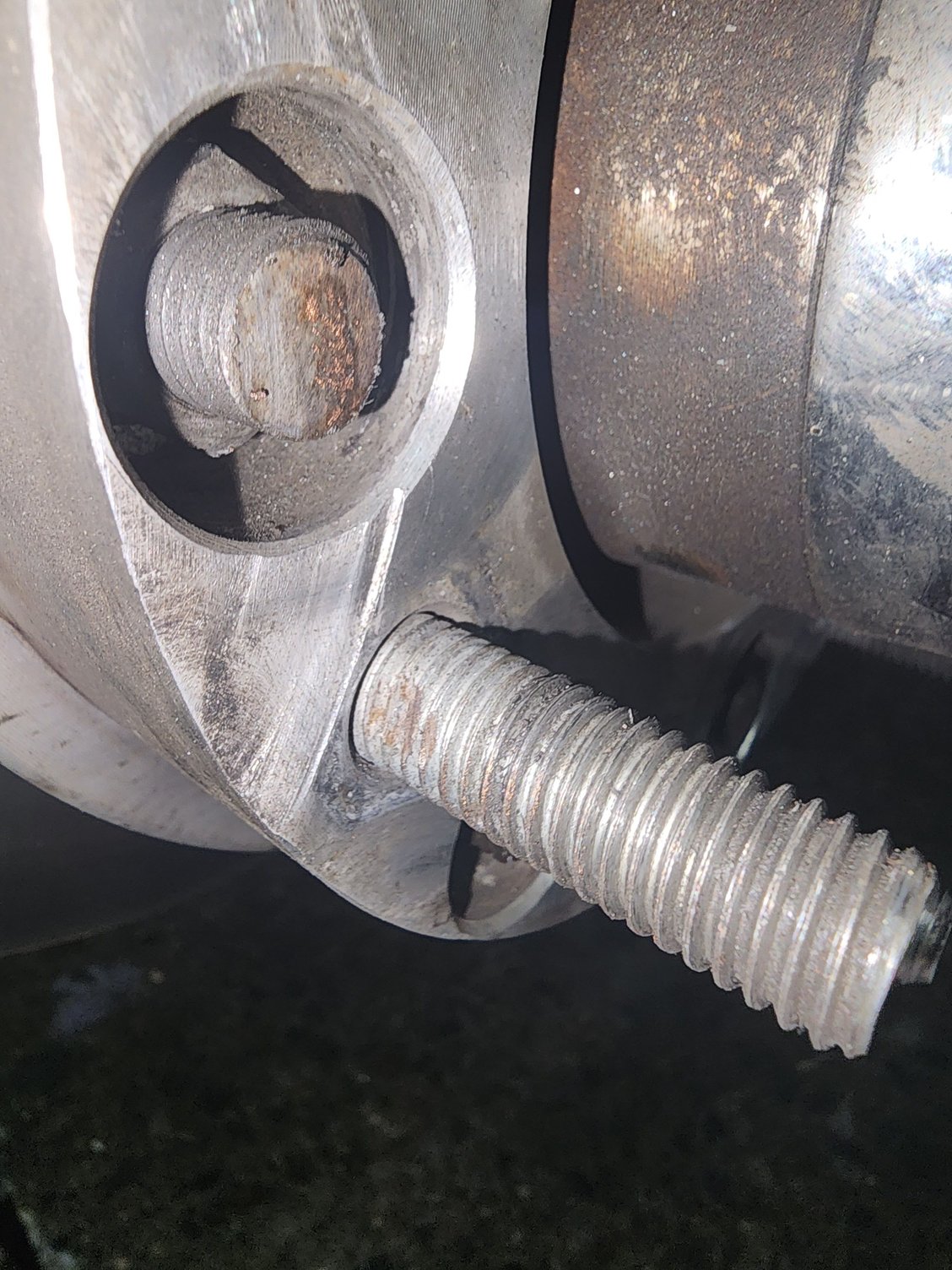

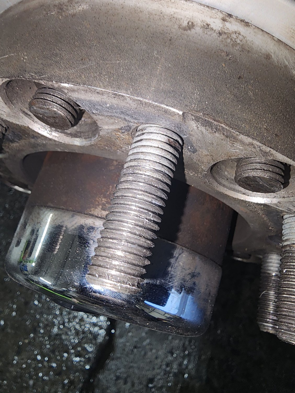

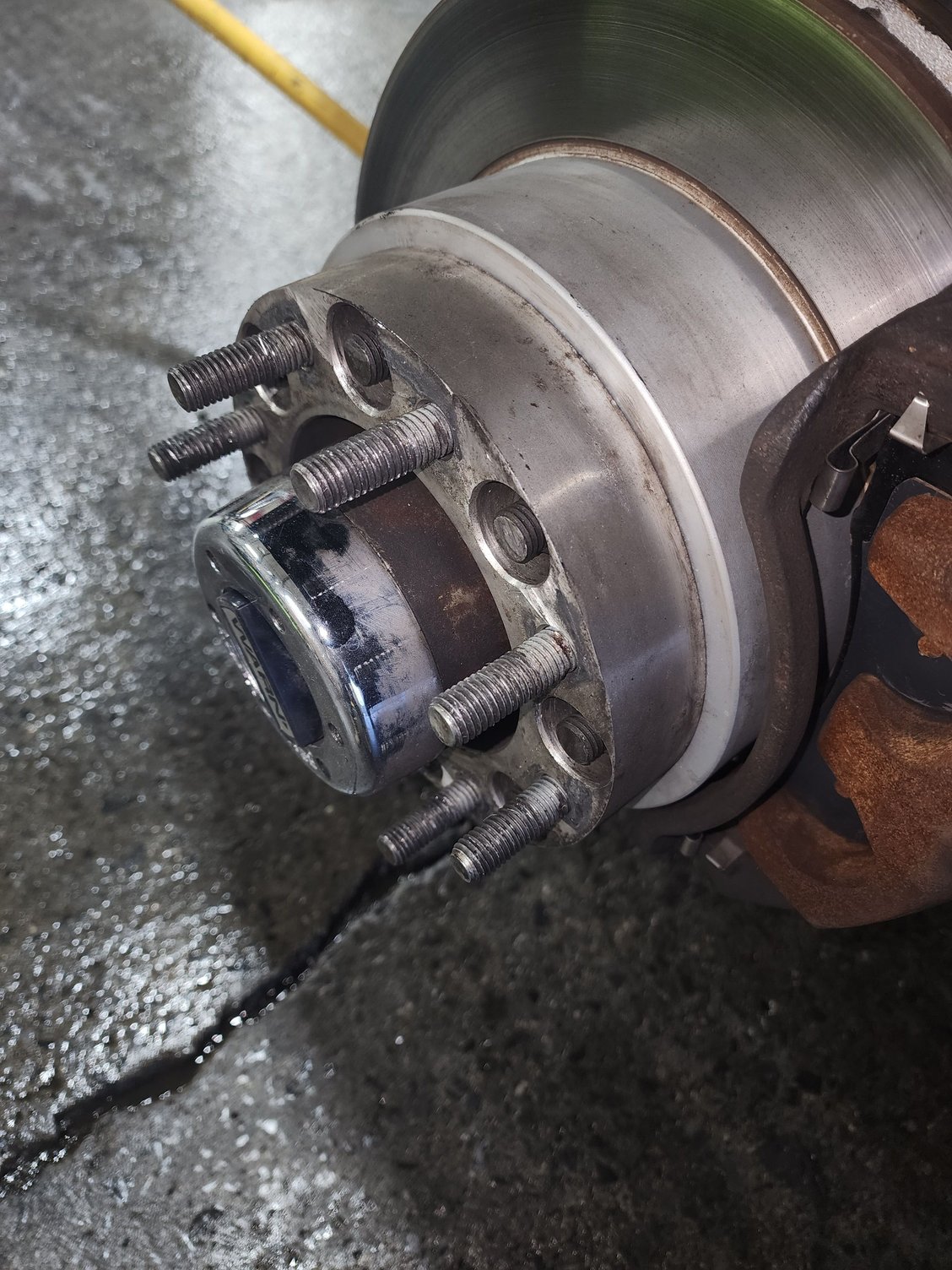

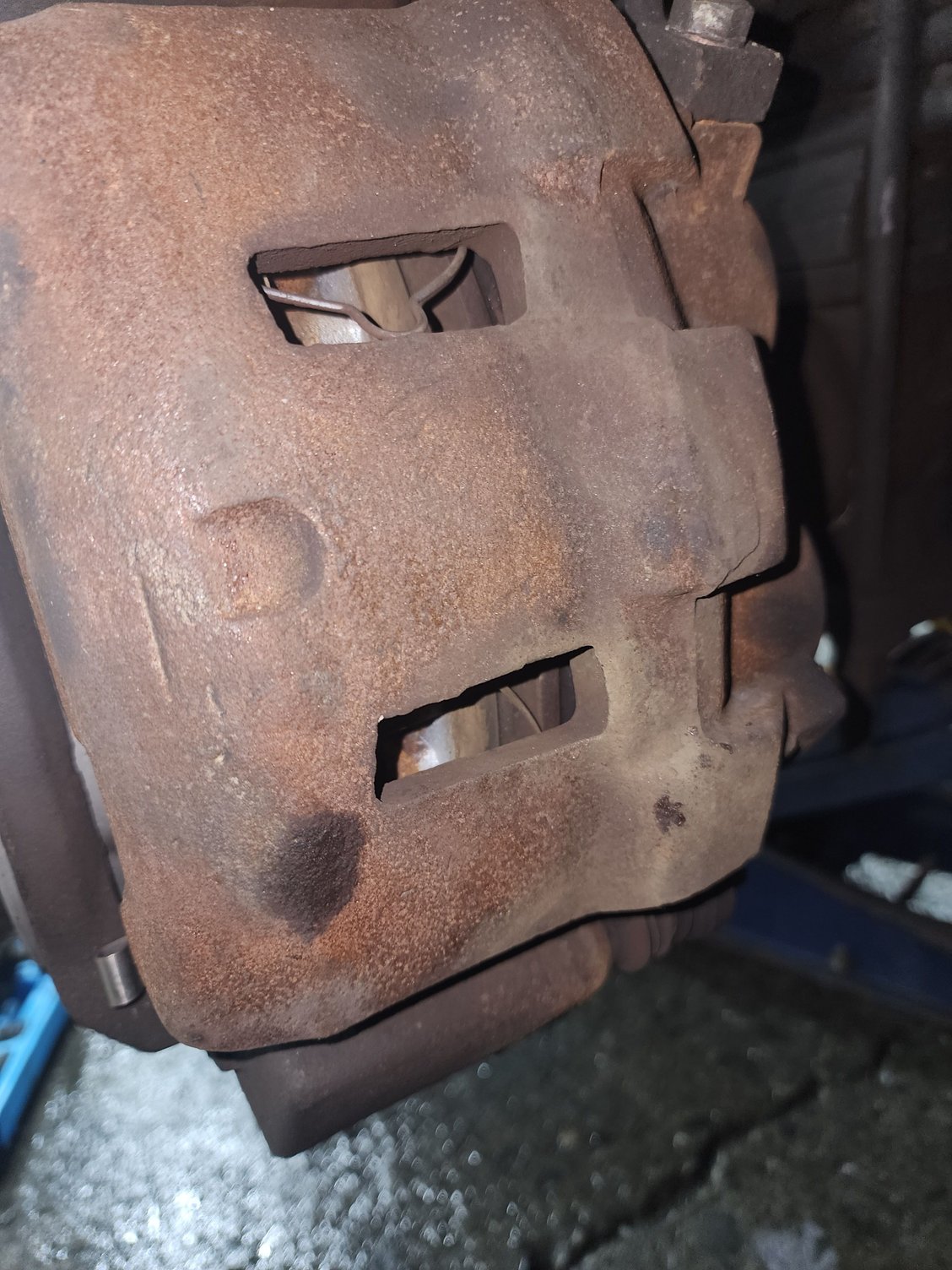

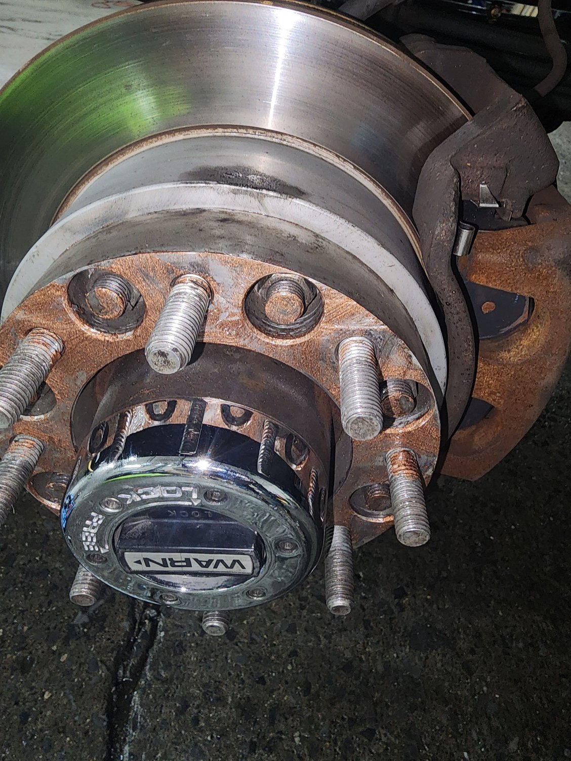

I don't know if you can tell by this photo if it's a 14x1.5 or 14x2. Not sure what I'm looking for.
I took the wheel off and the spacer, cleaned everything up with a wire wheel brush and put it back on with some copper never sieze.
I did notice the spacer had some guages in it and is no longer nice and flat. Maybe that was causing noise. I put it all back together but I'm still at work so didn't really get to drive it yet to see. I couldn't get any movement or play out of that wheel bearing with or without the wheel on. I attached a bunch of pictures below
One of the clips are set out of the slot and bottom is in. Idk if it makes a difference but not clicking
I noticed the spacer isn't and has some wear to it

as for the space looks like you or who ever installed the wheel spacer cut the the studs while the spacer was bolted on an ruined the spacer. If It was my rig I would either remove the spacer or buy new ones

Appreciate that reference picture! Looks like course to me.
And yeah I didn't think of them cutting the bolts. I bought the truck that way so I'll look into new ones for sure.

First picture looks like the threads were over-torqued, or there's so much lateral load on them because of the spacers that they are loaded beyond what they were designed to hold.
Second picture. Are those metal shavings? If so, something is definately shifting around. Not something you want to have any business with on a steer tire.
