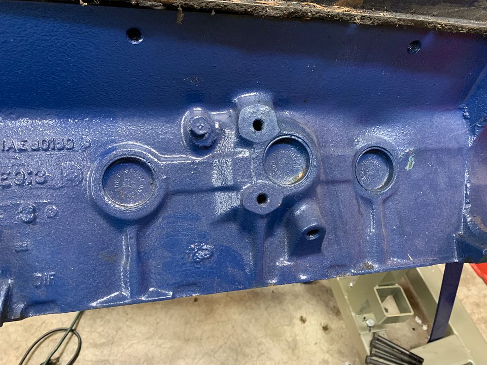

My fault. I mistyped 351 in the original thread but it was a 352. Here is the only pictures I currently have of the engine.

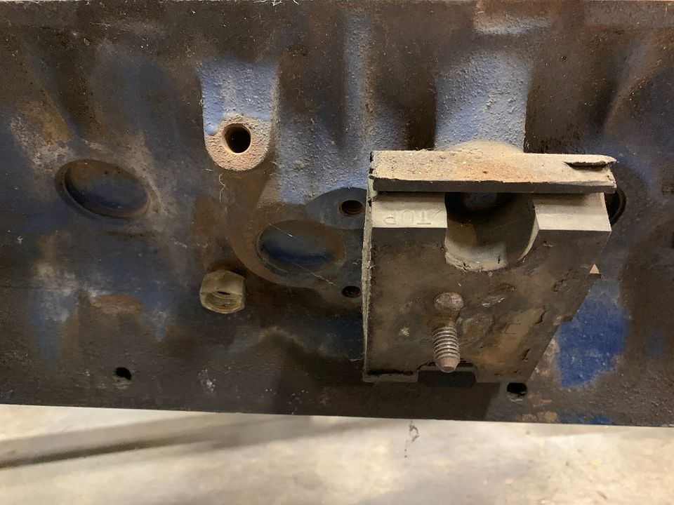

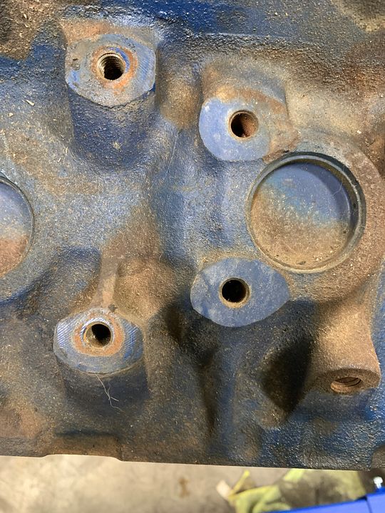

I see, it's already rebuilt and back together. If your engine builder researched it and that's what he says it is and what he used as his basis for the rebuild then he sure may be right. The pre-1965 FE engine blocks didn't have the same number of threaded holes in the side of the block for the motor mounts. That's one way you can sometimes tell the general era of the block to start with.
Here's a 1961 390 with the 2 holes for the engine mounts similar to all 1964 and older FE engines.
Here's a 1966 block showing the 4 holes on the same plane - the 1965 and newer trucks used the newer wide spread holes to the left for the mounts to bolt to. Sorry, I took the pictures flipped from each other but hopefully gives the idea. Anyway, it's one thing to check short of casting numbers that can help narrow the possibilities at least.
