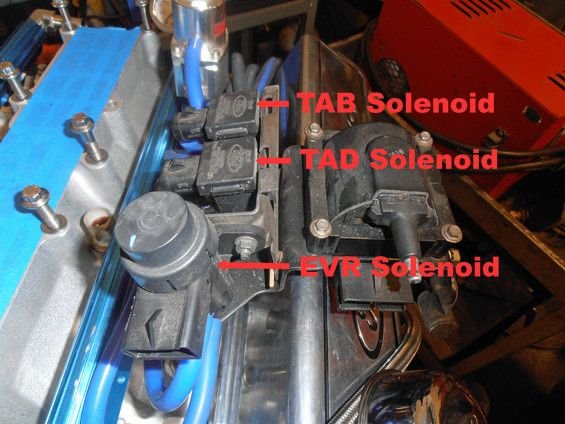

I would reinstall the air pump and the valves bypass and diverter, TAB and TAD solenoids
It will not cause you any trouble with power loss (negligible)

Unless the previous owner gave the OP all the removed parts that could be expensive and a waste of time. As long as the TAB & TAD solenoids are plugged in, the computer doesn’t know anything else.

I'm not new to Fords but new to old Broncos. I'm pretty sure the TAB and TAD solenoids are present and plugged in. It looks like the previous owner replaced all vacuum lines with rubber tubing. You mentioned ICM, is that the same as an ECM? The ECM on the truck was recently replaced just prior to our purchase, The alternator was putting out way too much voltage and was blowing the ECM. The previous owner prior to finding the alternator issue had replaced almost every sensor trying to find the engine problem. I'm beginning to think fuel pressure. I replaced the fuel filter and ran some fuel out ot the hose from the tank into a jar. It looked clean and clear. I dumped what was in the filter and it was full of fine debris like sand. It was muddy looking. I'm going to drop the tank and inspect the inside. I haven't replaced the fuel pressure regulator since the guy at Oriellys said if it was bad the fuel would run back to the tank and be hard to start until the fuel pumped back up. There is a slight vacuum to the fuel pressure regulator and there is no fuel residue in the vacuum line. Thanks for all the info and any other suggestions are greatly appreciated.
