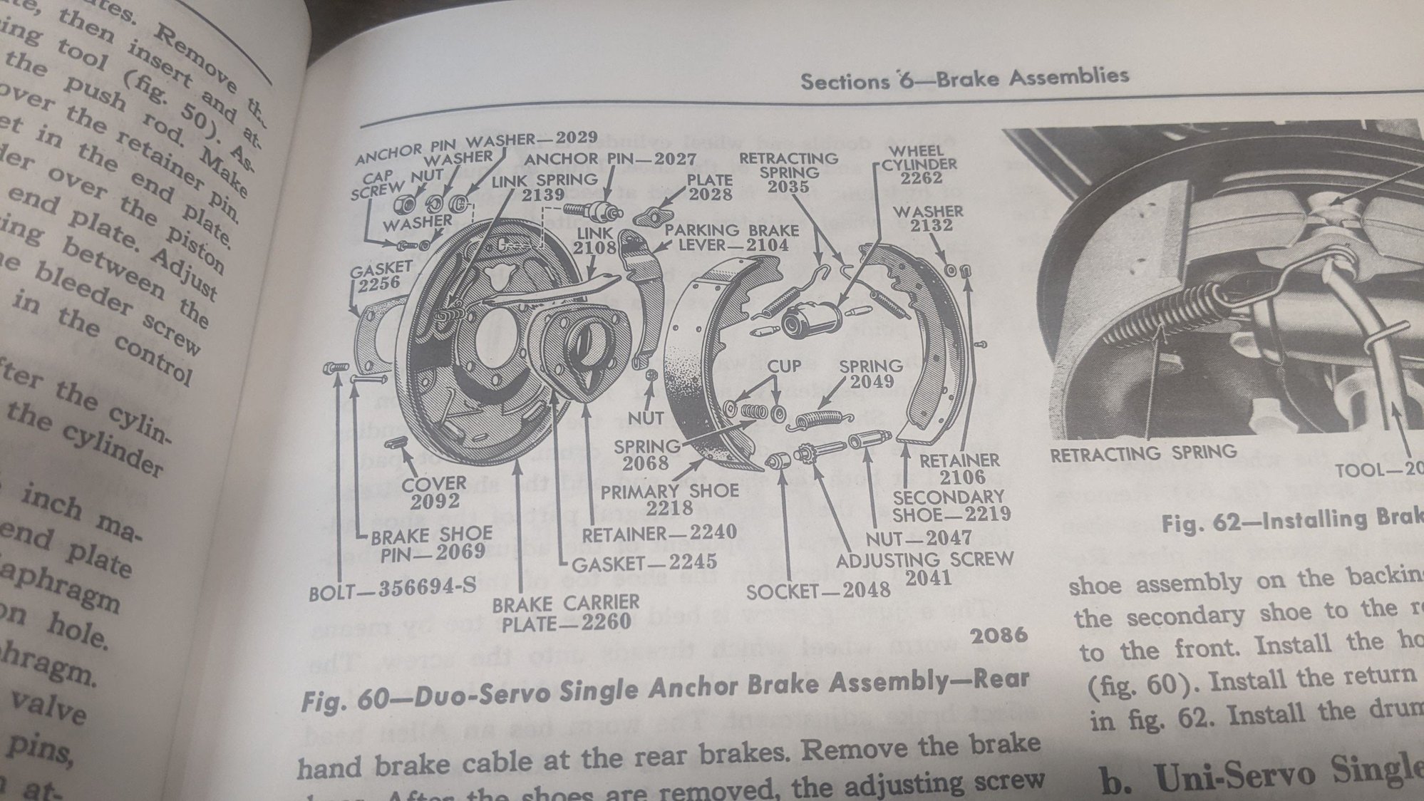

The emergency brake cable pulled away from my right rear wheel.
Does anyone have a good picture or diagram or explanation of where and how the ebrake cable is attached through the backing plate. This is the only diagram I see in the shop manual.

The cable goes into a big hole in the backing plate at the front lower corner, if you will. It is retained by some little spring loaded fingers attached to the end of the cable housing, and a ball on the end of the cable hooks into the lever that works the crossbar that applies pressure to the shoes. See the lower right of this pic, parking brake cable housing retainer.
