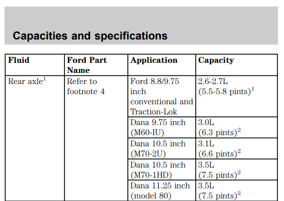

E-350 SuperDuty 4x4's Avatar
E-350 SuperDuty 4x4
Joined: May 2023
Posts: 114
Likes: 19
Originally Posted by JoePa2
1998 Club Wagon - according to my owners manual if the rear axle is filled with synthetic lubricant it is considered lubricated for life and do not need to be changed unless serviced - the question I have - how do you know if you have synthetic fluid in the axle - also how can you tell what kind of axle you have - a Ford conventional or a Dana axle - thanks guys - Joe
Ok, once again half truths and misinformation, lets get this cleared up. There are Ford axles and then there are Dana axles, the diagrams in your owners manual have to be used in unison when determining what gear oil to put in your axle housing. I have posted diagrams from the Ford 1998 E350 owners manual as part of this rant.
The first box under "application" contains the "Ford" conventional axle and or the traction lock with an 8.8" or 9.75" ring gear.
The second lists the "Dana 60" with a 9.75" diameter ring gear.
The third box lists the "dana 70 U" series with a 10.5" ring gear.
The fourth box lists the "Dana 70 HD" series with a 10.5" ring gear.
The fifth and last box lists the "Dana 80" with an 11.25" ring gear.
Please take note where it states "REFER TO FOOTNOTE #4" regardless of which axle is in your truck.
All of these are different axles that were used in different vehicles. We know you dont have a ford conventional axle, and the Dana 80 was only ever used in the E-450 trucks. The E-350 and others recieved either the Dana 60 or the heavier Dana 70 depending on the year and model.
We can X the Dana 80 because you dont have an E-450 with a Dana 80. We can can X the conventional ford axle with the tiny 8.8 ring gear because your not driving a mustang or thunderbird.
That takes the Dana 80 and the Ford conventional axles off the table.
Based on the footnotes number 4, the only portion we are concerned with at this point is... (Dana axles on E-350 vans/wagons with 4.10:1 ratio require Motorcraft SAE 75W140 Synthetic Rear Axle Lubricant.)
That sentence is telling you that if your axle is a "Dana 80, or a "Ford" or "Dana" axle of any type "WITH 4:10 GEARS" it requires the synthetic gear oil SAE 75W140. However if you read the last portion of the footnote 4 it clearly states, "Dana" conventional axles and Limited slip axles require SAE 80W90 gear oil. Its saying that all Dana axles that do not have 4:10 gears require 80W90 gear oil NOT 75W140 synthetic.
WIth that said, people need to start getting the BOM numbers off of the axle tag itself, or start cleaning the rust off the axle tube where the BOM number is also stamped. You cant rely on random people on internet forums for accurate factual information. In your case if you learn to decipher what you are reading, footnote 4 is telling you to run 75W140 _ "ONLY"_ if your truck has a Dana or Ford axle with "4:10 gears", however if you finish reading the footnote 4, It clearly states "Dana" conventional and limited slip axles are to use 80W90 gear oil combined with friction modifier. Got that? Its saying if you dont have a Dana or Ford axle with 4:10 gears you are to be using 80W90 gear oil with friction modifier. Keep in mind this is specifically for your truck which is a 1998. My truck is a 2005 with a Dana 70HD axle with limited slip, however it requires the use of 75W140 synthetic gear oil and modifier.
The internet being what it is, combined with fords history of back stepping on certain criteria years after the fact, your best option is to just call ford yourself when it comes to certain information like this. However without that tag information their likely to laugh at you and hang up.
Is it going to make a hill of beans difference which gear oil you run? Highly unlikely IMO as long as you dont forget to add the friction modifier.
