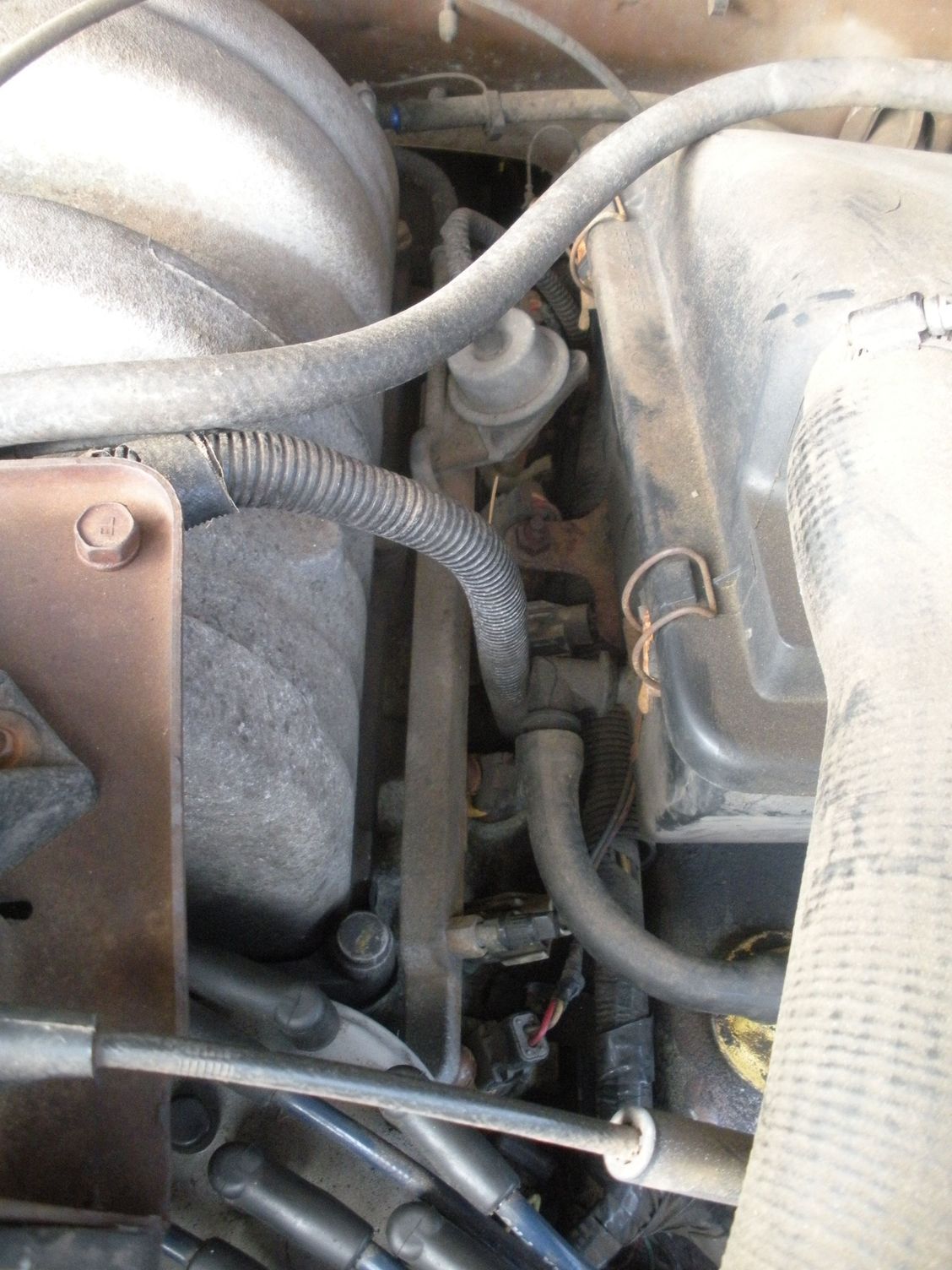

fuel pressure reg. is on the fuel rail close to the fire wall

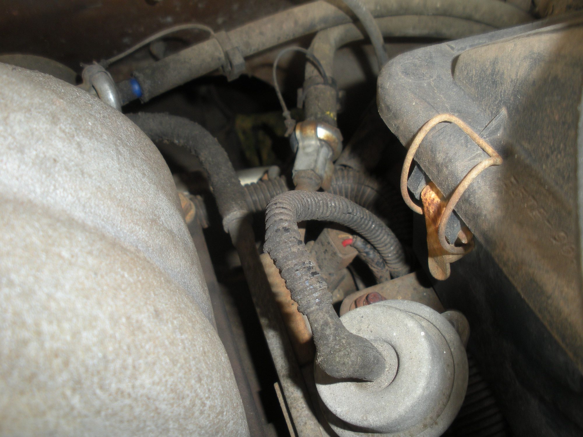

Here's the FPR,
